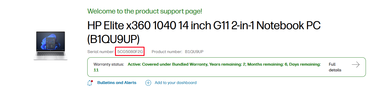

        The provided serial by KALEEM359 is not correct...probably on X360 1040 G11 your method will not work )

          yes you are write on hp website by searching SN it shows other model. but when i click on identify product manually it shows my original pc. its mysterious for me also
