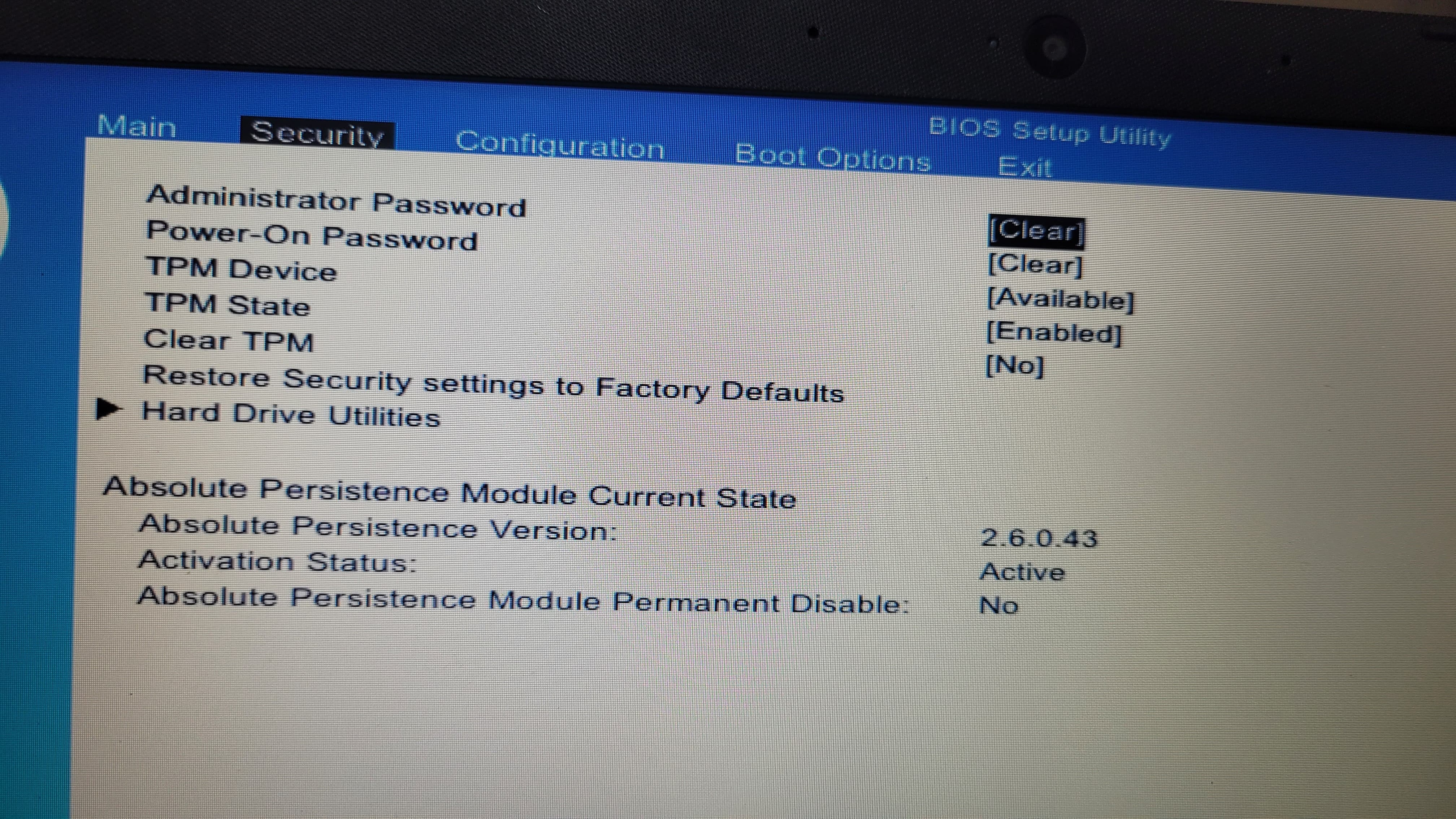

    HI BadCaps Members, I have a Laptop HP 240 G9 Intel and it has DeviceFreeze locked Screen after power on actived, When I enter to Security Tab in BIOS.. I can see Absolute Persistence Module active and can't deactivate it, somebody can help me with some Clean BIOS OR patching bios. thanks in advanced and sorry for my bad english,.

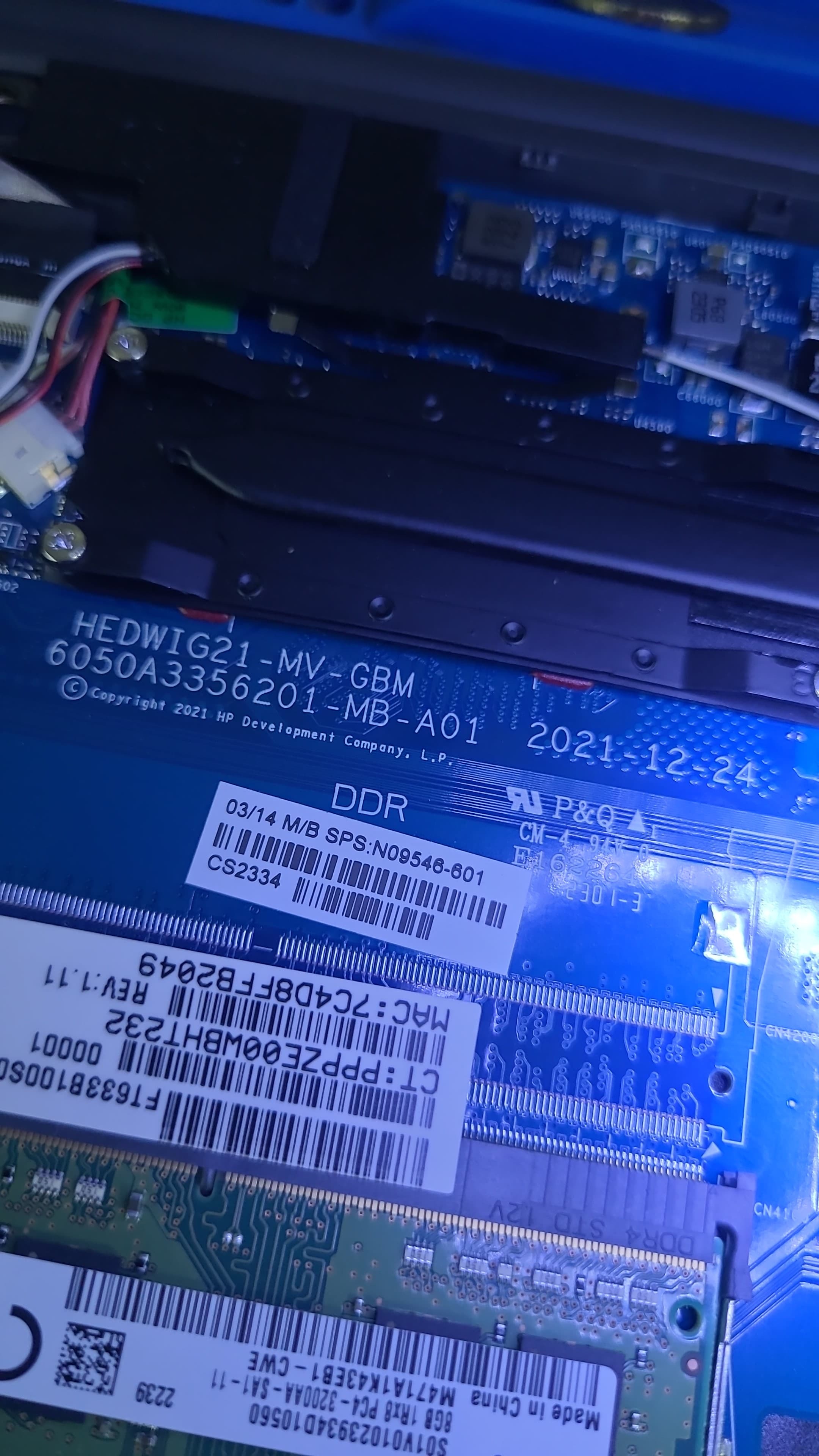

    info laptop:
    HP 240 G9
    HEDWIG21-MV-GBM
    6050A3356201-MB-A01
    S/N: 5CG311226G
    SYSTEM BOARD ID: 8996

    update: Im trying with this tool https://www.badcaps.net/forum/troubl...y-bios-patcher
    script 5 sucess
    script 6 sucess (Absolute remover)
    but Laptop not power on...

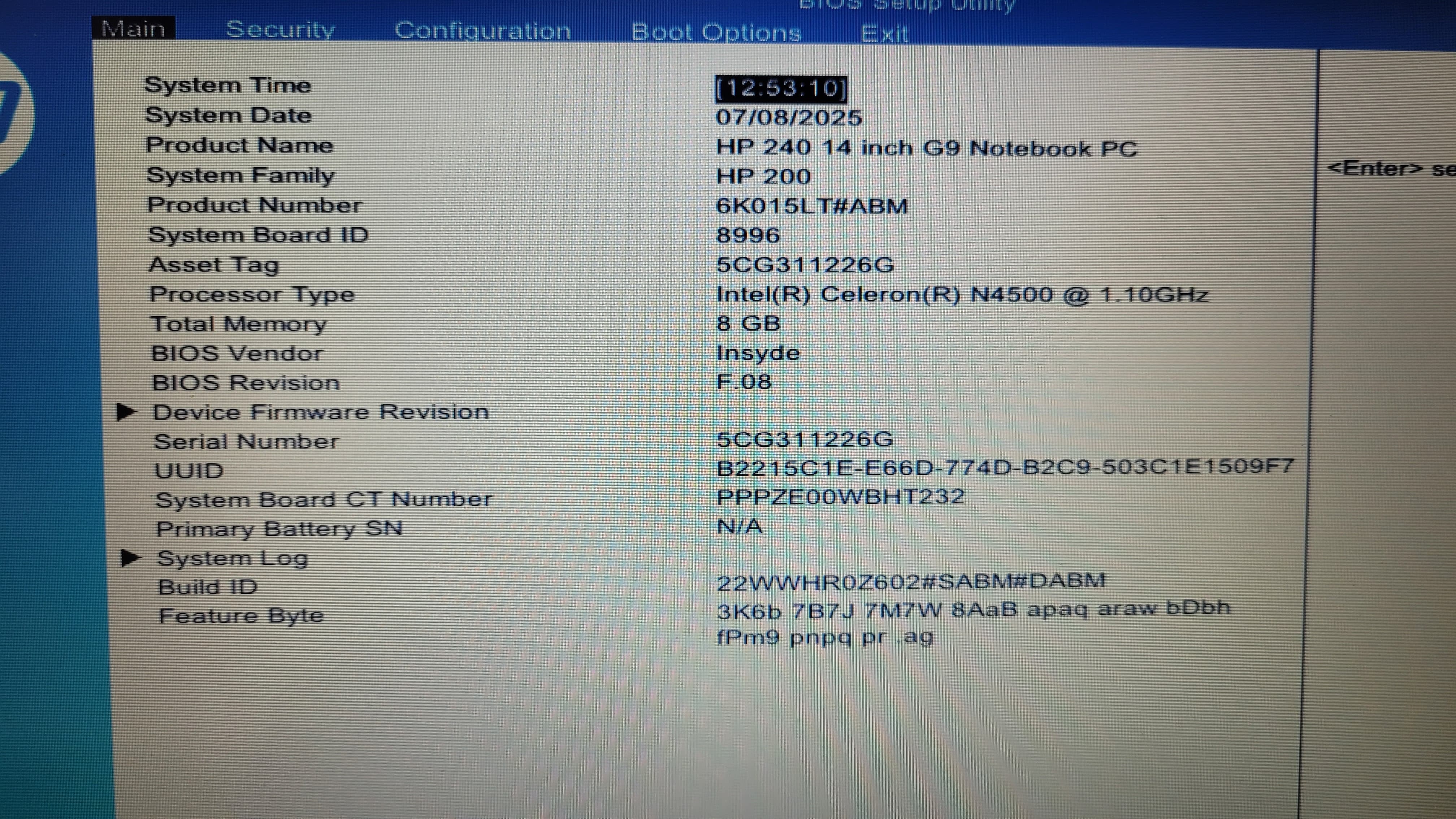

      Your BIOS type is Insyde not AMI, and this is a consumer laptop, the patcher won't work; it's only for business laptops (Probook, Elitebook, etc.)
      Clean BIOS from HP, ver F.08 (same as you have), from sp143613.exe
      BID: 08996
      Included your DMI+Win key: 500000-50103F
      EDIT: Made a mistake, will upload the correct one
      Try this one first: your original dump + Abs disabled according to this post: https://www.badcaps.net/forum/troubl...nlocker/page24
      BiosHP240GORDO_CLARO abs disabled.rar
      And the clean bios from HP + your serial/win key, if the first one doesn't work
      08996 gsmunlock88 clean.rar

        Thanks sir, with both Files power on ok laptop... in bios option now show Absolute Inactive but... DeviceFreeze picture (Aviso Claro) still after booting OS appear... maybe That I need Format and reinstall Windows?

          Yes, try removing the SSD and boot from USB first
          If booting the windows installer works, you may need to format the SSD and reinstall windows

            many many thanks for all.. after format all is OK!! Thanks!
