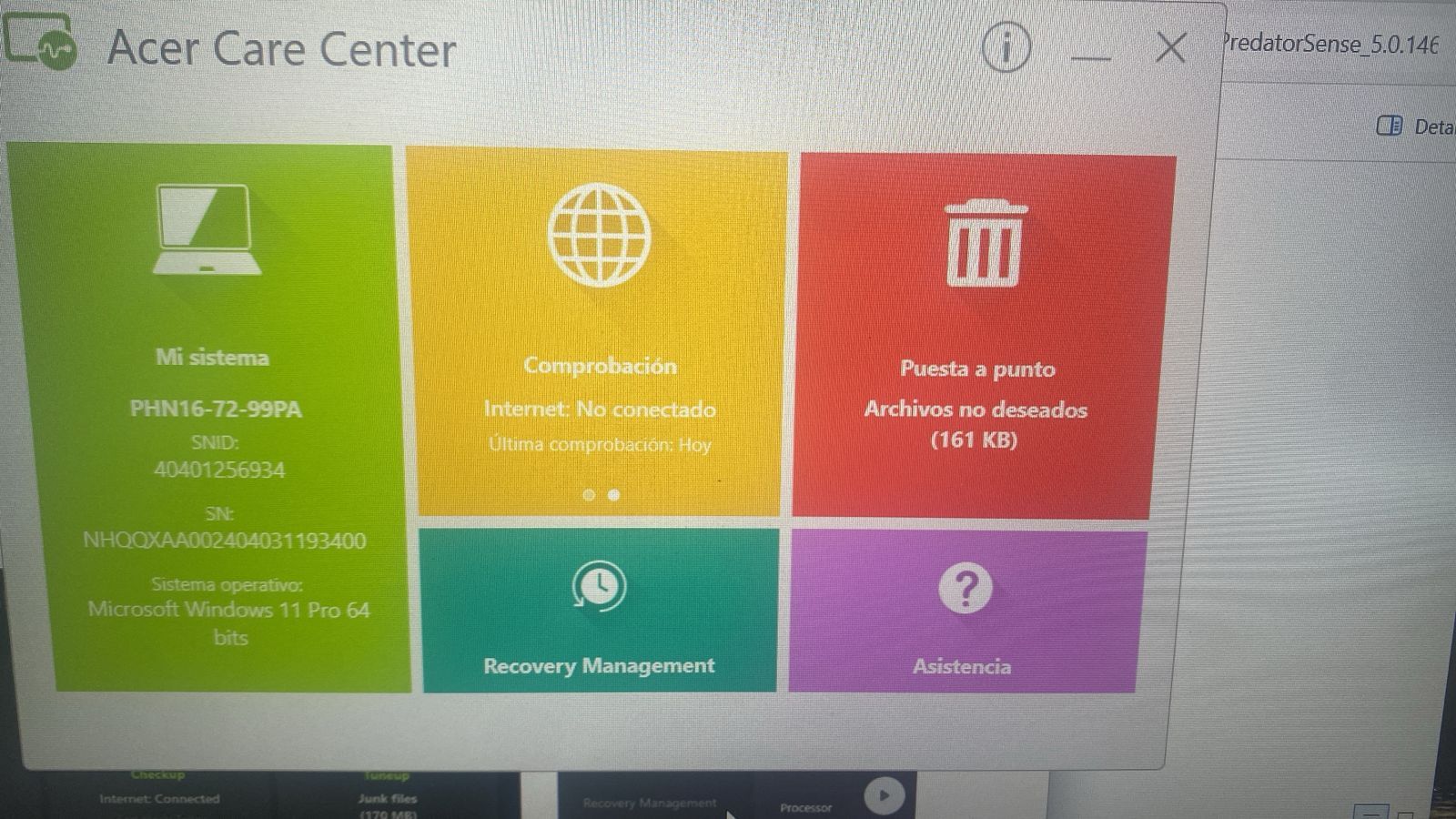

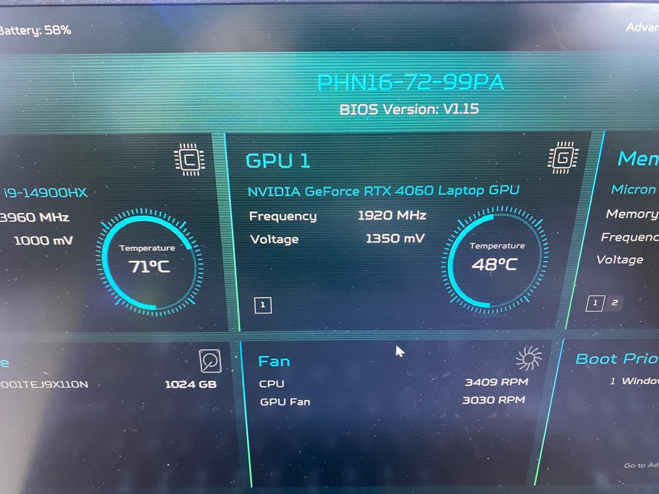

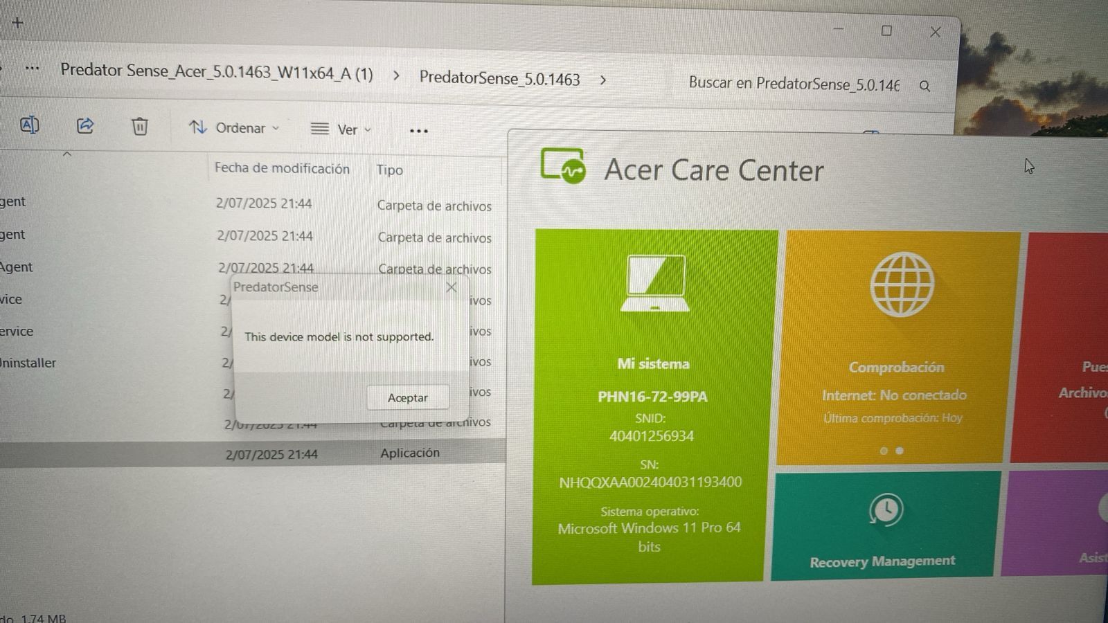

    Good afternoon, I have this machine and I can't install Sense. When I run the software, the message "This model is not compatible" appears. I've read that this is because the model name in the BIOS says:
    PHN16-72-99PA.
    It should say:
    PREDATOR PHN16-72-99PA
    Could someone help me change the model in the BIOS or tell me how to do it?
    Thank you very much in advance.
    Model: PHN16-72-99PA
    S/N: NHQQXAA002404031193400

    FixedPHN16-72-99PA to PREDATOR PHN16-72-99PA

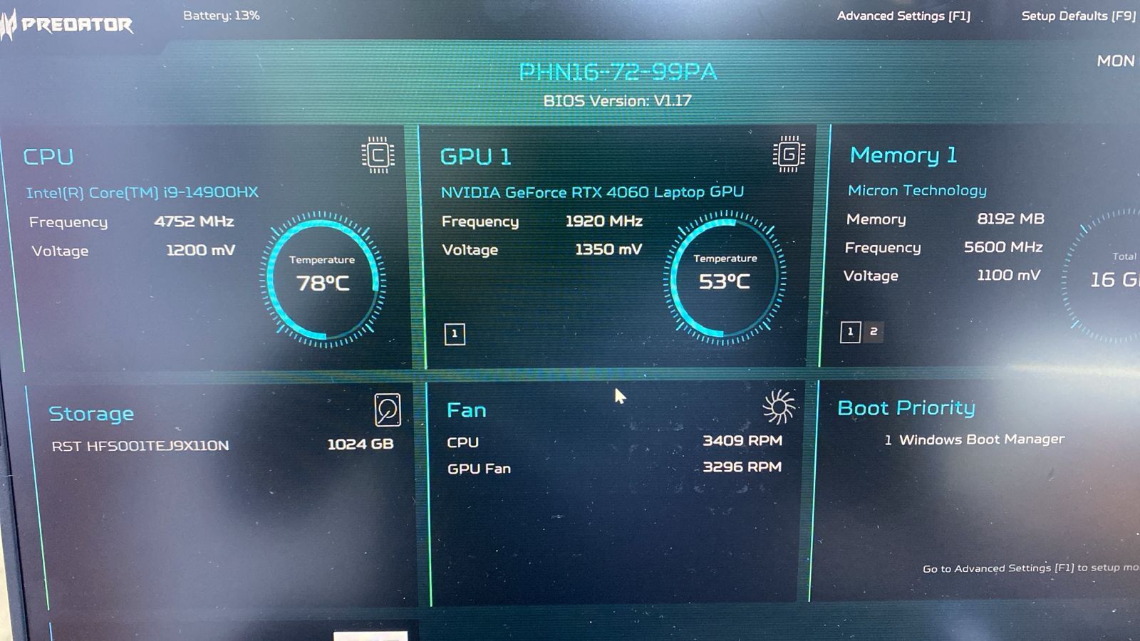

      Good morning, I programmed the file you sent me, and it still has the same name as shown in the photos. Is there a BIOS editor for this model? I really appreciate the response. If it doesn't have the name "Predator", it won't install the "Sense" driver.
      Thank you.

        2nd edit and new file

          Thank you very much for your time. I've already tried the two files you sent me, but the "product name" remains the same as shown in the image.
          I tried editing the names with Tiny Hexer, but that still didn't work. I'm desperate. I hope you can help me.

            install Predator Sense from the Microsoft Store and charge battery to 100%

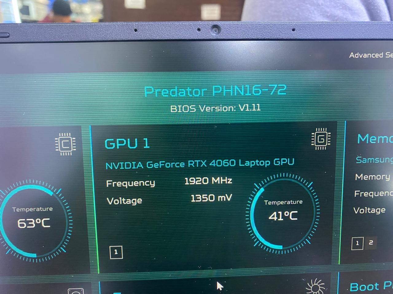

              Good afternoon, I managed to find an identical machine in which the sensor works, I recorded the BIOS from the functional machine onto the one where the sensor does not work, but it does not detect the disk. Could any master check if it is possible to transfer the DMI to the good BIOS? Here I share the 2 BIOS. Thank you for your responses.

                search for your serial in bios dump and write it to working bios at same hex adress.

                  Good afternoon, Volinakis, thanks for your reply. I copied the serial number from my BIOS to the working BIOS at the same hexadecimal address, but the machine no longer turns on. I then replaced the serial number from my BIOS to the working BIOS. This time, the machine turned on, and in setup, it shows that the serial number had changed, but it still doesn't detect the disks. Is there any other way to solve my problem?

                    yep, clean ME to working bios
