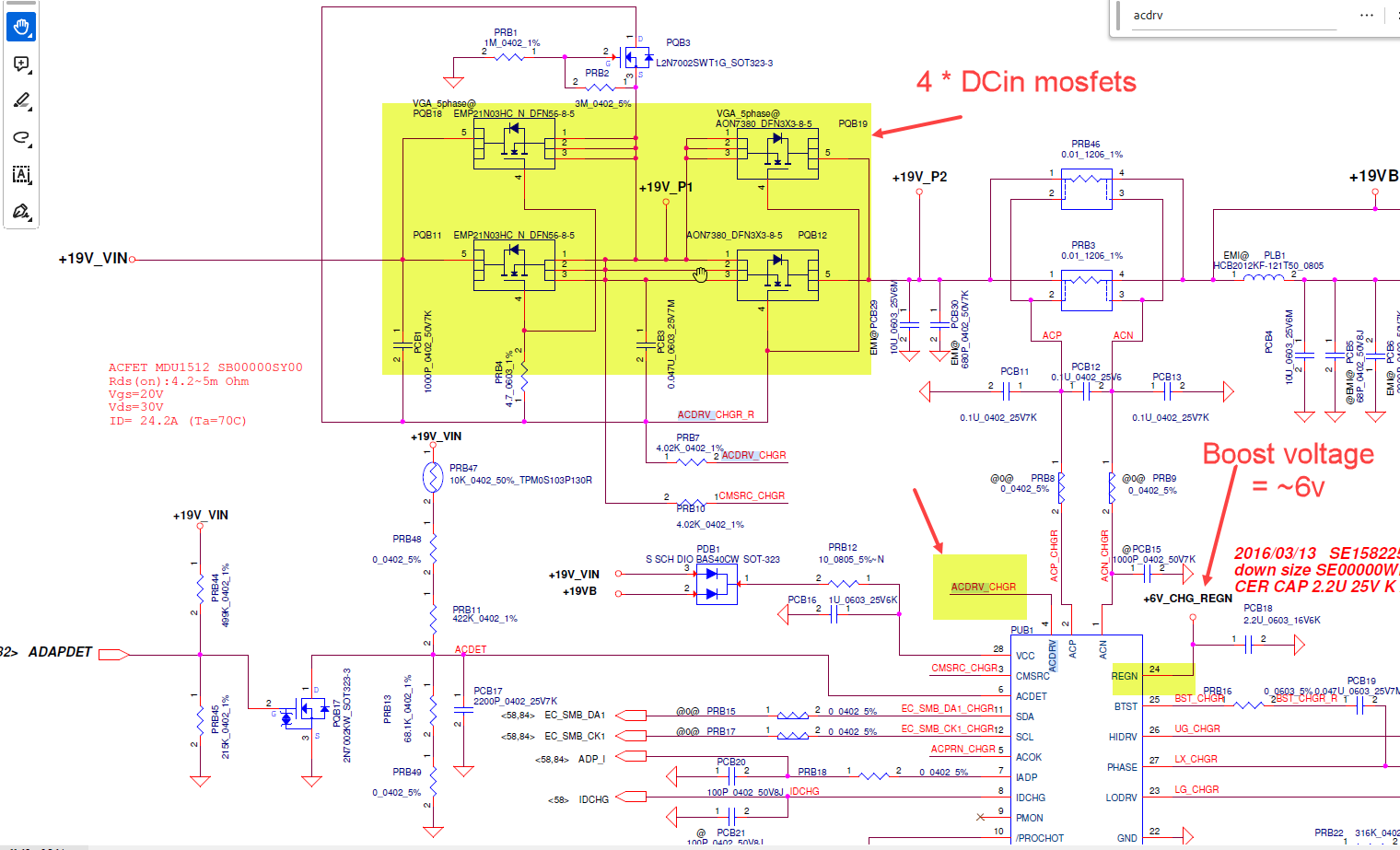

        Find the charger ic and locate the ACDRV pin. There should be a 4K ohm resistor connected to it. Then on the other side of this resistor will be the 2 * dcin mosfets connecting their gate pins. In the meantime, do study the great article by piernov on charger circuits- see above sticky. It is a must read. We are trying to get him to do house calls.
        Also carefully measure the volts to ground of the REGN pin. It should be ~6 volts.
        Update - see attached. This logic board has 4 * DCin mosfets and they are highlighted. For safety, suggest that you consider to test if they are ok or not in resistance mode.
        Would you have a multimeter? Dial it up to resistance mode (select 200k ohms or higher).
        Remove all power = no adapter / no battery. You will then proceed to test each mosfet to see if it is leaking / shorted. This is through resistance checks. No harm if the probe slips because no power to the board. Just be careful not to scrape off any parts in the process. Hope the probes are somewhat with a point / needle like.
        Locate the mosfets which will be black in body color + 8 pins with 4 silver pins on each side. This is the 8 pin SOIC package in the electronics world. Everything, mean everything has some associated buzzword to it.
        Locate the dimple in the body of the mosfet and the top left of this dimple = pin # 1. You count the pins in a 'U' shape. Top left going down and around to top right.
        So,
        1 8
        2 7
        3 6
        4 5
        Mosfets will have pins 1-2-3 tied together to support higher currents = source pin group.
        Gate pin is the trigger = pin # 4.
        Drain pins = 5-6-7-8
        Meter on source (any pin from the group) + meter probe on drain (any pin). What is the resistance? Color of the probes does not matter in resistance checks.
        Repeat for source & gate
        Then gate & drain.
        Post each measurement and be sure to share the scale on your meter. If the meter reports '1' = over limit -> switch to a higher meter scale in the resistance group.
        For a good mosfet (vs a nasty leaky one); the resistance should be high.
        Yes, from your list - the mosfets of immediate interest are:
        PQB11
        PQB12
        PQB18
        PQB19​

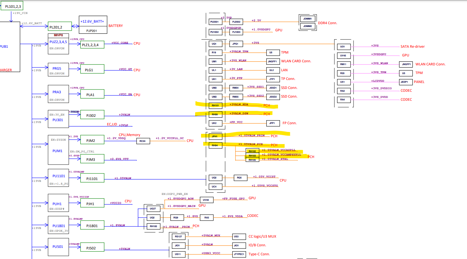

          Since a short-circuited PCH is a common outcome in these cases, it would be efficient to find take a look at the inductors for 3VALW and 1.05ALW too.
          We likely can't do much for this board anymore, so the most important thing now is that you have learned from this "accident".

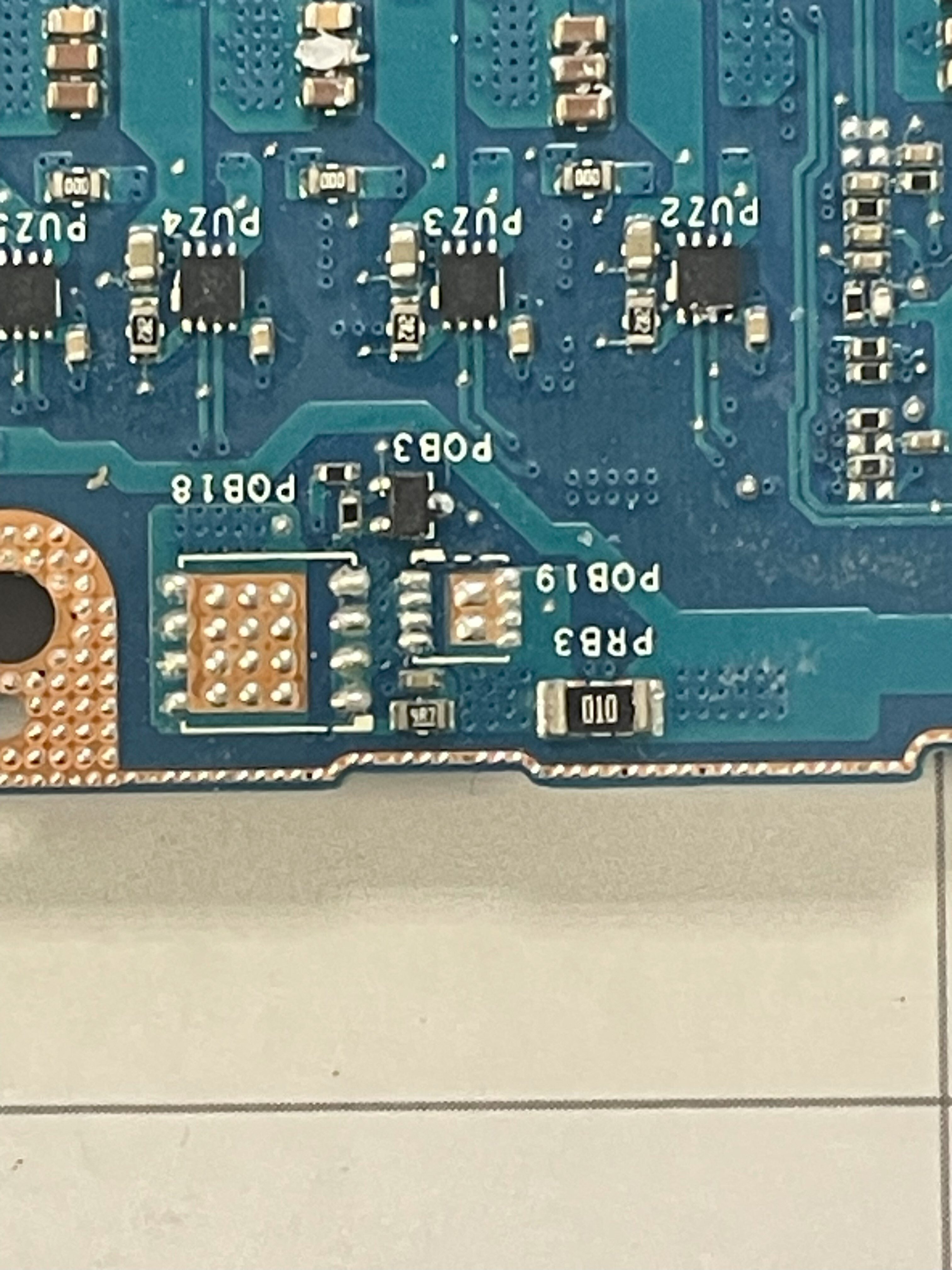

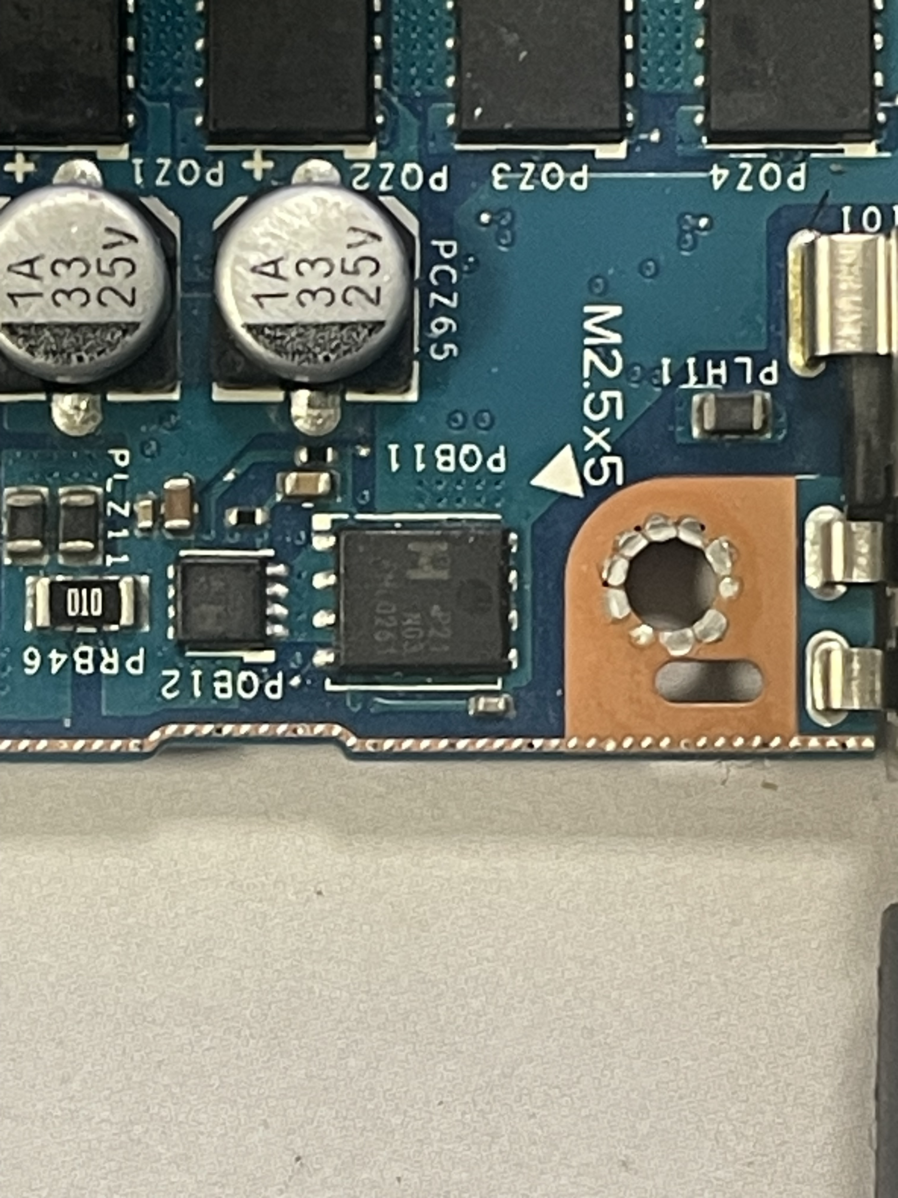

            Thank you very much for your detailed sharing. I tried to do what you said to the extent of my technical knowledge.
            The results are as follows;
            Results only when the Power Charger adapter is plugged in ;
            PUB1 24 +6V_CHG_REGN : 6.0V
            PUB1 4 ACDRV_CHRG : 25.0V
            I have attached the pictures of PQB11 PQB12 and PQB18 and PQB19 when I turned the back side of the motherboard. When you look at the picture as you specify, I took the U-shaped base and made the measurements as you wrote below.
            1 8
            2 7
            3 6
            4 5
            Code:
            PQB11
            1.19.5V
            2.19.5V
            3.19.5V
            4.25.0V
            5.19.5V
            6.19.5V
            7.19.5V
            8.19.5V
            PQB12
            1.19.5V
            2.19.5V
            3.19.5V
            4.25.0V
            5.19.5V
            6.19.5V
            7.19.5V
            8.19.5V
            PQB18
            1.19.5V
            2.19.5V
            3.19.5V
            4.19.5V
            5.19.5V
            6.19.5V
            7.19.5V
            8.25.0V
            PQB19
            1.19.5V
            2.19.5V
            3.19.5V
            4.25.0V
            5.19.5V
            6.19.5V
            7.19.5V
            8.19.5V

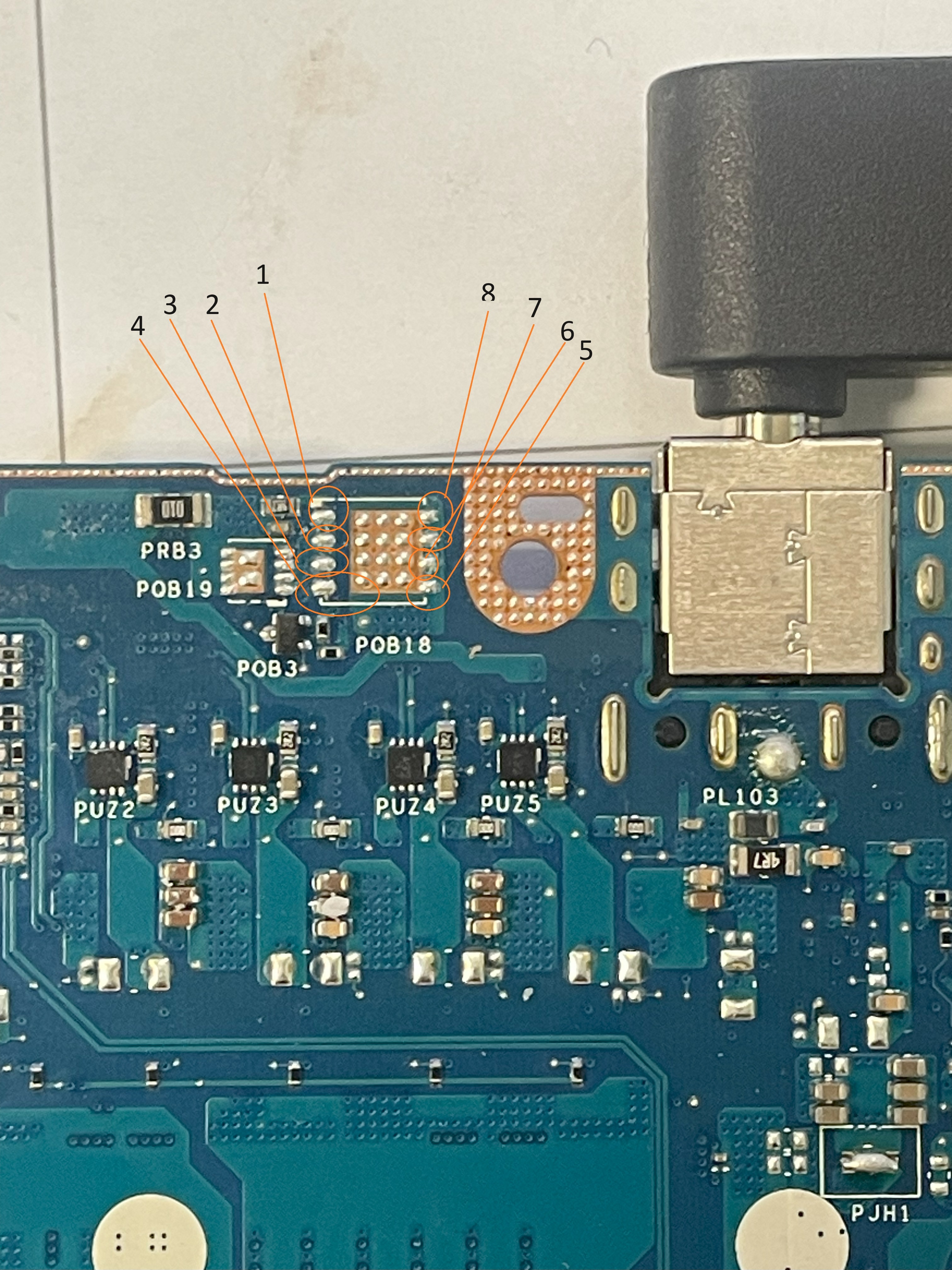

            Results with the Power Adaptor Unplugged and the Meter in Resistance Mode ;
            In this part, when you look at the picture, I measured it in U shape as I mentioned below.
            1 8
            2 7
            3 6
            4 5
            Code:
            PQB11
            1. 3.6 M OHM
            2. 3.6 M OHM
            3. 3.6 M OHM
            4. 0
            5.284.5 K ohm
            6.284.5 K ohm
            7.284.5 K ohm
            8.284.5 K ohm
            PQB12
            1.17.5 K ohm
            2.17.5 K ohm
            3.17.5 K ohm
            4.17.5 K ohm
            5.3.6 M ohm
            6.3.6 M ohm
            7.3.6 M ohm
            8.0
            PQB18
            1.284.5 K ohm
            2.284.5 K ohm
            3.284.5 K ohm
            4.284.5 K ohm
            5.3.6 M ohm
            6.3.6 M ohm
            7.3.6 M ohm
            8.0
            PQB19
            1.3.6 M ohm
            2.3.6 M ohm
            3.3.6 M ohm
            4.0
            5.17.5 K ohm
            6.17.5 K ohm
            7.17.5 K ohm
            8.17.5 K ohm
            I took care to measure correctly and be careful when I could. In the light of the above data and measurement results, what do you think the situation is? Why the motherboard does not come power. How should I proceed after these measurements?
              I have attached a picture of the schematic in the annex, in which I tried to show the 3VALW and 1.05ALW parts you specified. Do I need to measure these parts in the short circuit position with the measuring instrument. I also need to measure the following parts specified in the diagram. Can you help with this issue?
              RH101
              RH99
              JPH1
              RH94
              RH102
              RH103
              RH105

                Review again the voltage to ground check on PQB18. The list is out of order. The 25v should be on the gate pin #4.
                • pilgrimage
                  • Jan 2020
                  • 15
                  • turkey

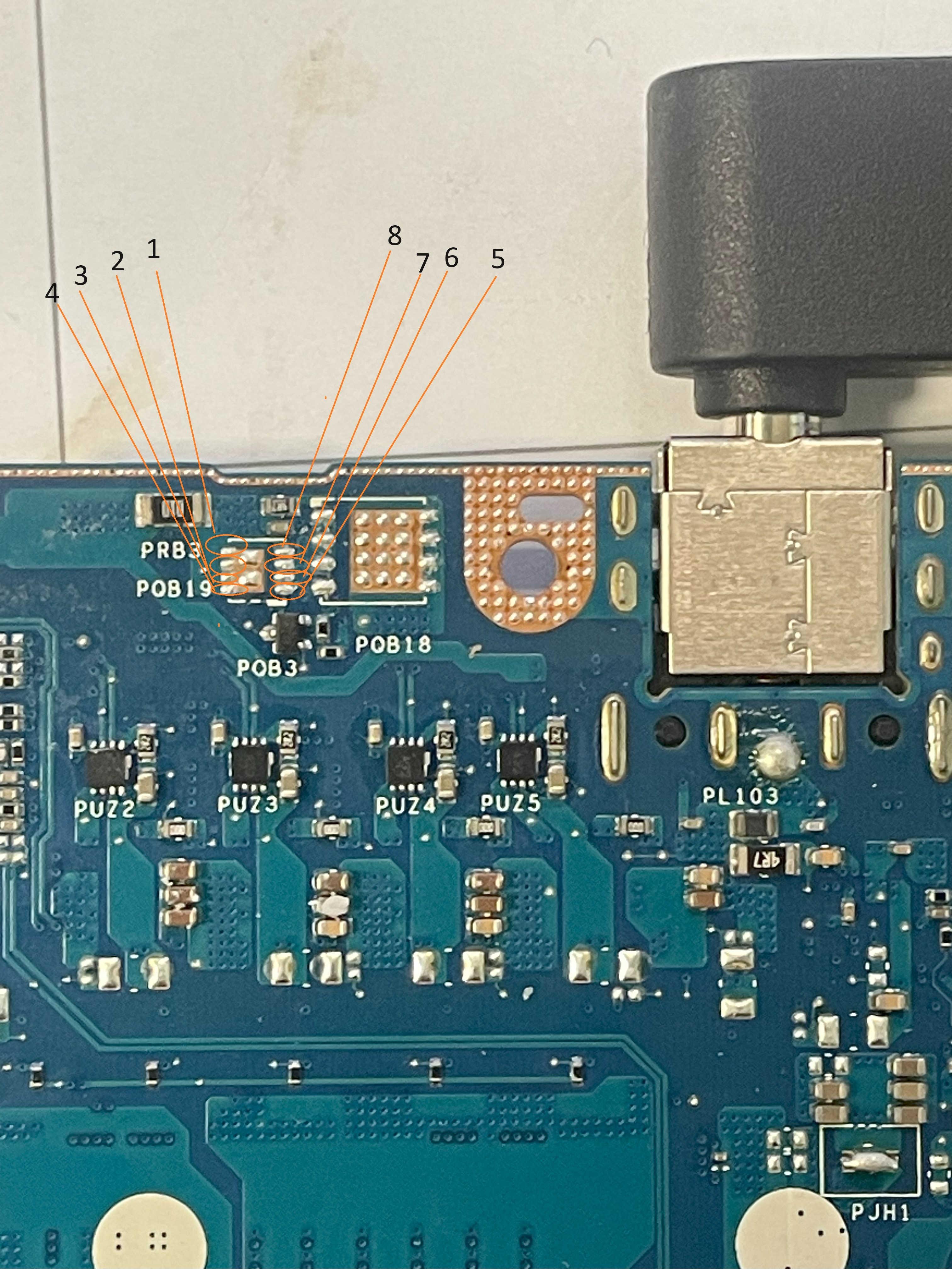

                  When I measure the motherboard as in the picture I attached in the attachment, PQB18 4 Pin comes out 25.0V as you said.
                  How should I proceed from now on? Are the other measurements normal?

                    Just realized now that mosfets @ PQB18 & PQB19 are marked with the '@' symbol so they are not stuffed on the PCB. That is, these are alternate mosfets to be used if the others are not available for locations PQB11 & PQB12.
                    The measurements are good for each here and the mosfets are being enabled to power the board. As suggested in post #5, check the ALW rails. These are low current always on rails to power devices required to power on the main functions of the board.

                      PQB19 When I measure in the order in the picture, I get the following results.
                      1 8
                      2 7
                      3 6
                      4 5
                      PQB19
                      1.19.5V
                      2.19.5V
                      3.19.5V
                      4.19.5V
                      5.25.0V
                      6.19.5V
                      7.19.5V
                      8.19.5V

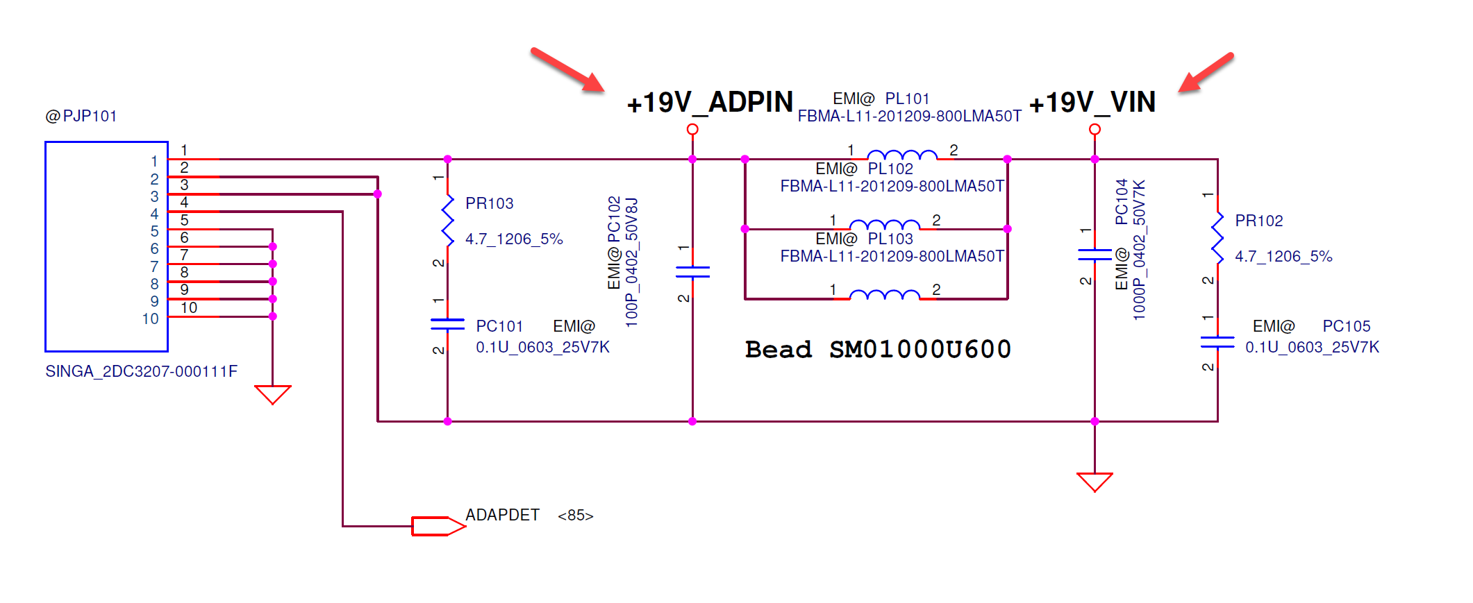

                                    There was a spark when I was measuring PU301. I think I burned something. Now 19V's gone. Do I need to replace the following mosfets to get 19V back.
                                    PQB11,PQB12,PQB18,PQB19
                                    • mon2
                                      • Dec 2019
                                      • 14659
                                      Your external power adapter may be dead. Often they have an internal fuse inside of the adapter and the adapter is sealed so they are throw aways.
                                      Double check by checking the DC adapter voltage starting at the connector. Measure with care as the power adapter may be ok but something else is damaged there. The DCin mosfets have 0 volts so it is pointing to the external power adapter.

                                        I will plug the Charging Adaptor into the Motherboard's Power input. Then I will take the meter to the Volt section and measure the Adapter input of the Motherboard.
                                        The parts I'm going to measure
                                        PL101-PL102-PL103
                                        Black probe to the Motherboard Chassis and the other red probe to the PL101-PL102-PL103 terminals.
                                        Do I understand correctly, I need to see 19V at PL101-PL102-PL103.
