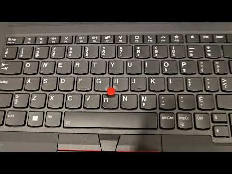

    Will not post but shows blinking keyboard lights. Battery charges so maybe not power related but bios corrupted.
    Can't read chip on motherboard using Pomona test clips and CH341A programmer, maybe need to remove?
    JBIOS1 shows as Gigadevice 25R256DYIG which is not listed in Asprogrammer.

      The bios chip must be unsoldered from the board before writing or reading..
      do not use the clip, you may have errors..if you do not have anything to unsolder it with,
      solder wires between the programmer and the bios chip..
      .here is a video for example..https://www.youtube.com/watch?v=DWWi...l=ThisIsHow​
      if you don't have the chip in the database, look for a similar one...
