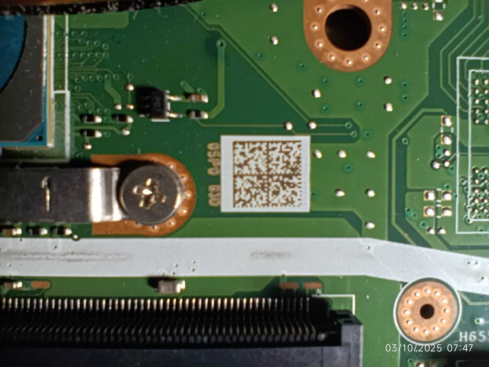

                Post a picture of the QR code near the CPU
                • tujuhkalitujuh
                  • Oct 2013
                  • 26
                  • Indonesia
Name:	WhatsApp Image 2025-03-10 at 07.49.24_7ba7538e.jpg
                  here it is
                    • 20990
                    here it is
                    X415JAB is the model from the barcode
                      • 20990
                      here it is
                      Try this one. If you still have any problems its hardware, the bios is ok.
