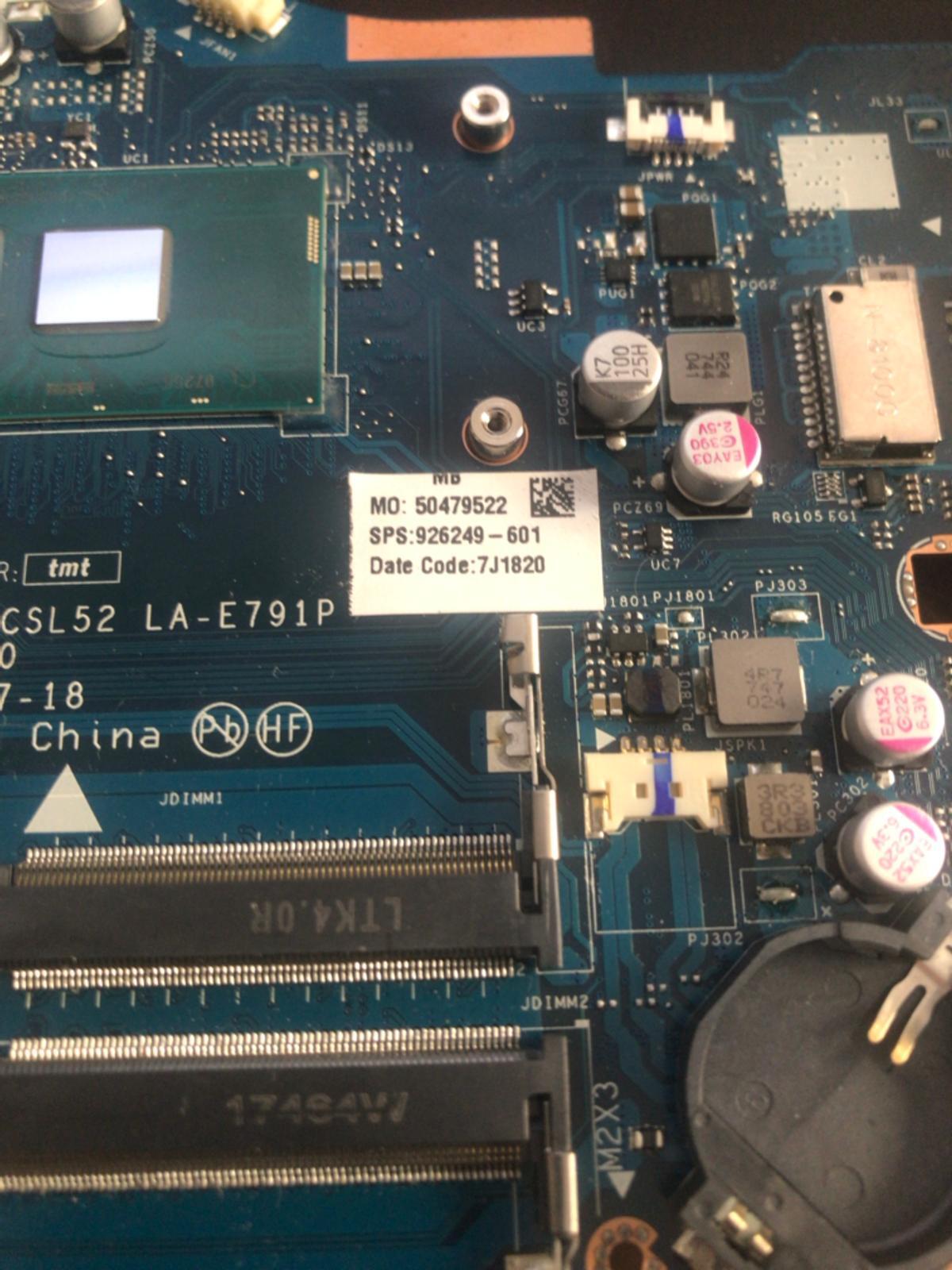

                        Hi to all.
                        I have an HP 250 G6 that won't boot after the infamous HP bios update...
                        My NB is: HP 250 G6
                        S/N CND80826HP
                        M/B CSL50/CSL52 LA-E791P Rev 2.0 2017-07-18
                        Added the corrupted bios in zip form
                        Added M/B codes
                        Thanks to all.

                          Originally posted by flip971
                          Hi to all.
                          My NB is: HP 250 G6
                          S/N CND80826HP
                          Added M/B codes
                          Thanks to all.
                          you have everything you need at post #6.....08328
                          https://www.badcaps.net/forum/troubl...-0#post3496291
                            Thanks for the reply.
                            Got "Invalid File Specified"...
                              • 22001
                              The files have been restored. Attached is your bios + DMI (serial number, feature byte etc.)

                                10X a lot 😊😊😊😊😊
                                Now the CH314 programmer didn't see the chip! 🀬🀬🀬
                                • flip971
                                  • Apr 2012
                                  • 15
                                  • Italy
                                  @SMDFlea: Finally all done! Thanks a lot.
