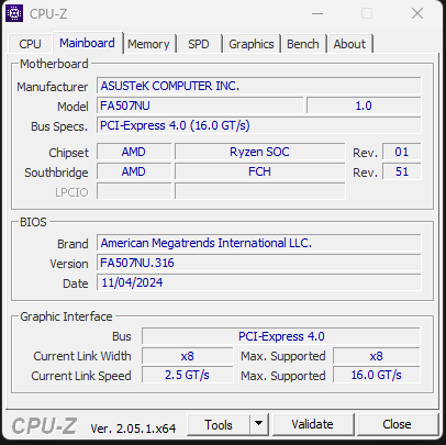

                      Update: I was able to do a BIOS update last night, but in user mode only. I cannot change anything from BIOS configuration now.
                      Last edited by Michael Angelo Dorio; 02-14-2025, 07:27 AM. Reason: checked bios version

                                    Making an update on this. I'm unable to reflash my BIOS. Just got lucky, I was able to use the old password I've been using since before, and I got in! Weird stuff happens, I feel like an Idi0t all month.
                                    Guess I'll start backing up my working BIOS now. This ticket is resolved.
