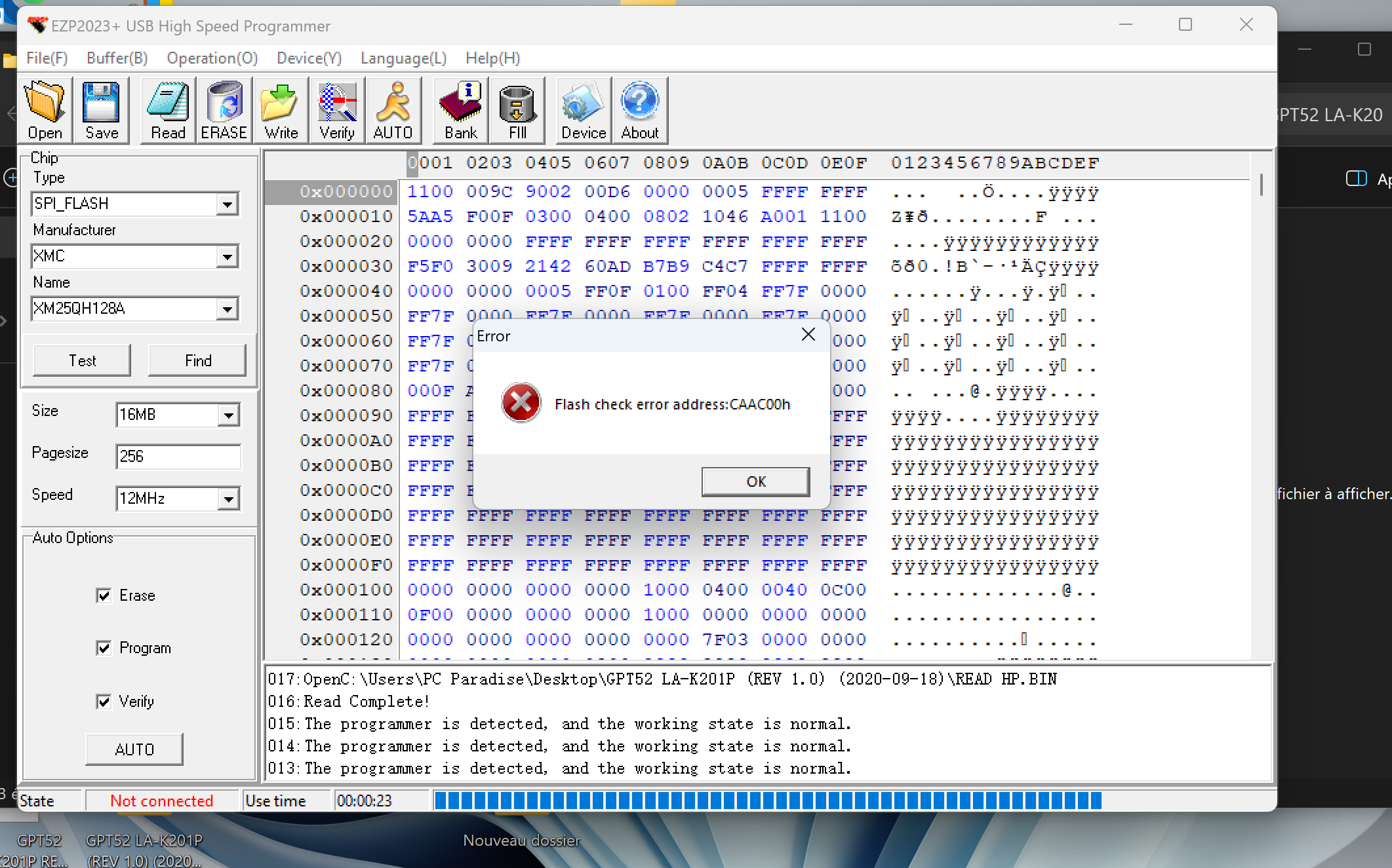

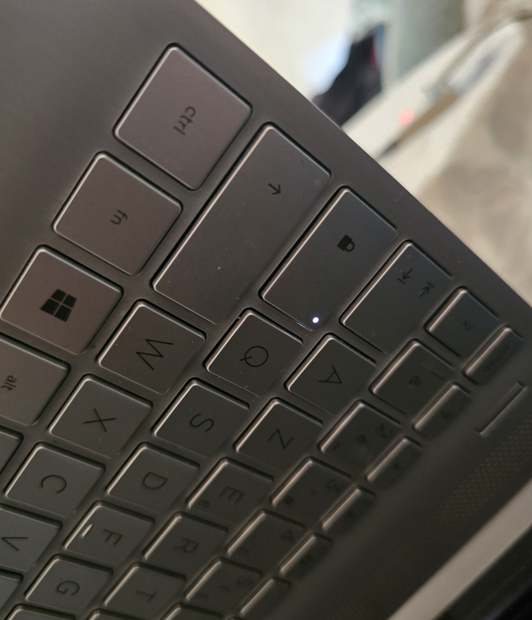

    Hi Everyone
    Please i have an HP S/N : CND1435705 Model : HP Laptop 15-dw3027nk (455X7EA)
    First it comes with Black screen And the CAPS Button Blinking When i tried to Flash the BIOS Now when i try to turn it does not respond
    i need the Coresponding BIOS File Please

                hi try
                • Sardired1
                  • Dec 2024
                  • 7
                  • Morocoo
                  Hi sir i really appreciate your reply i got this error while veryfing
                  • Sardired1
                    • Dec 2024
                    • 7
                    • Morocoo
                    Now its erased flashed and verifyed but the Caps button keep blinking

                      Originally posted by Sardired1
                      thanks for yourreply a really appreciate
                      Here is your Bios with various BID numbers, you need to find your exact BID and write that bios
                        Thank you so much for your reply
                        should I try them one by one ?
                        • Rebirth
                          • Sep 2022
                          • 50
                          • Myanmar
                          If you have HEX Editor, open your old bios and search for BID until you find the same number form my file and write the same number. If you don't have old bios you can try one by one
