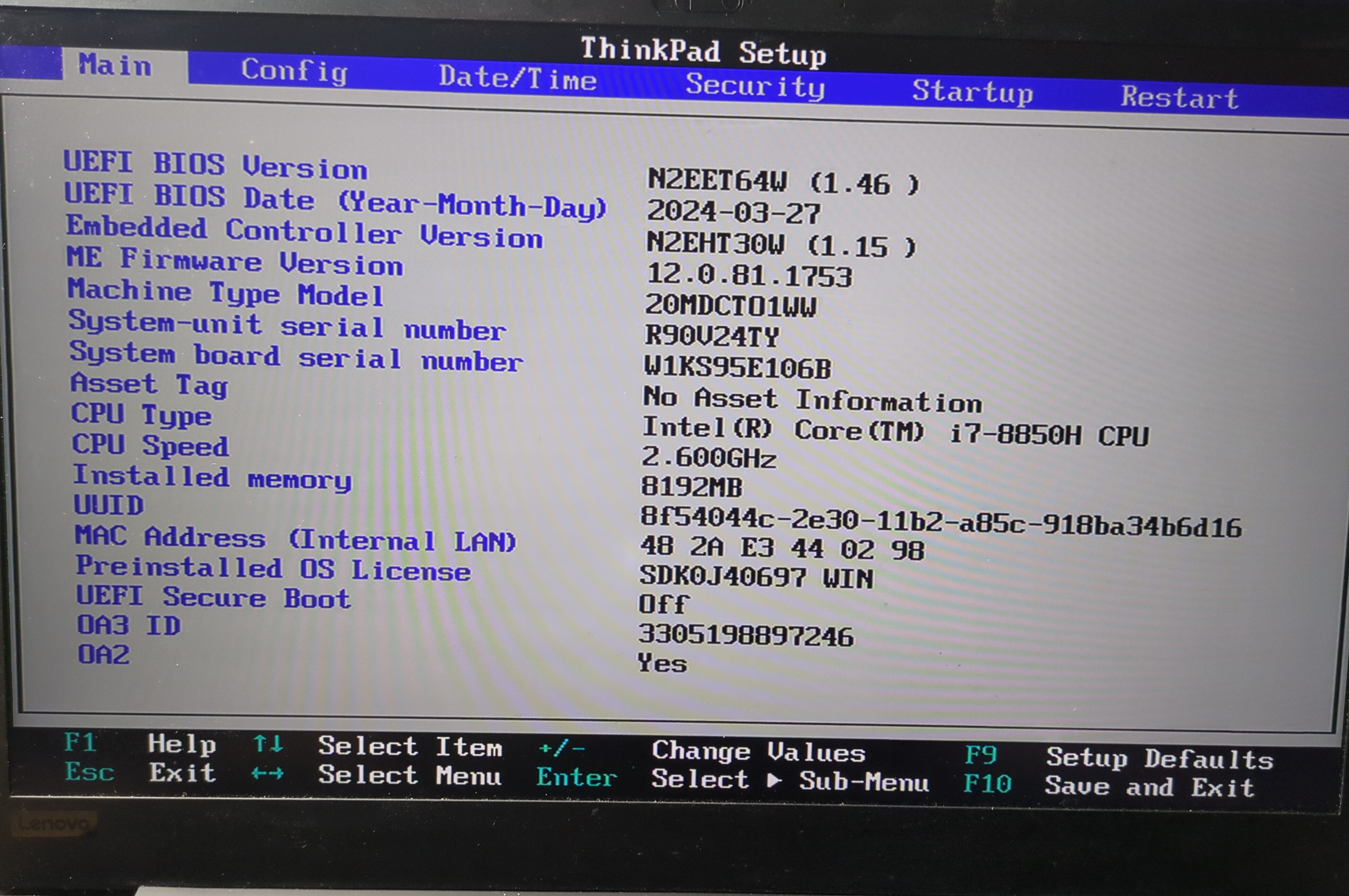

    Hello everyone!
    After An BIOS update the support for special characters got supposedly removed, so I got locked out of the BIOS, because my supervisor password contained a special character
    I am now trying to flash BIOS files on my BIOS chip with a T48 programmer and the minipro software (as I am running Linux), which works so far, except it seems that I don't have the correct files.
    Laptop Model: ThinkPad p1 gen1
    Motherboard: LPM-1 MB 17870-1 448 0DY04 0011
    BIOS Chip (supposedly): MX25L25673G@SOIC8
    CPU: i7-8850H
    GPU: Nvidia P2000
    Help would be appreciated, thanks in advance
    attached: firmware pulled from chip, i.e. bricked bios

      Machine Type Model: 20MDCTO1WW
      system-board S/N: W1KS95E106B

        HI try

          didn't work, I get a black screen

            Btw, I see you changed the binary, are there tools/methods for that?
