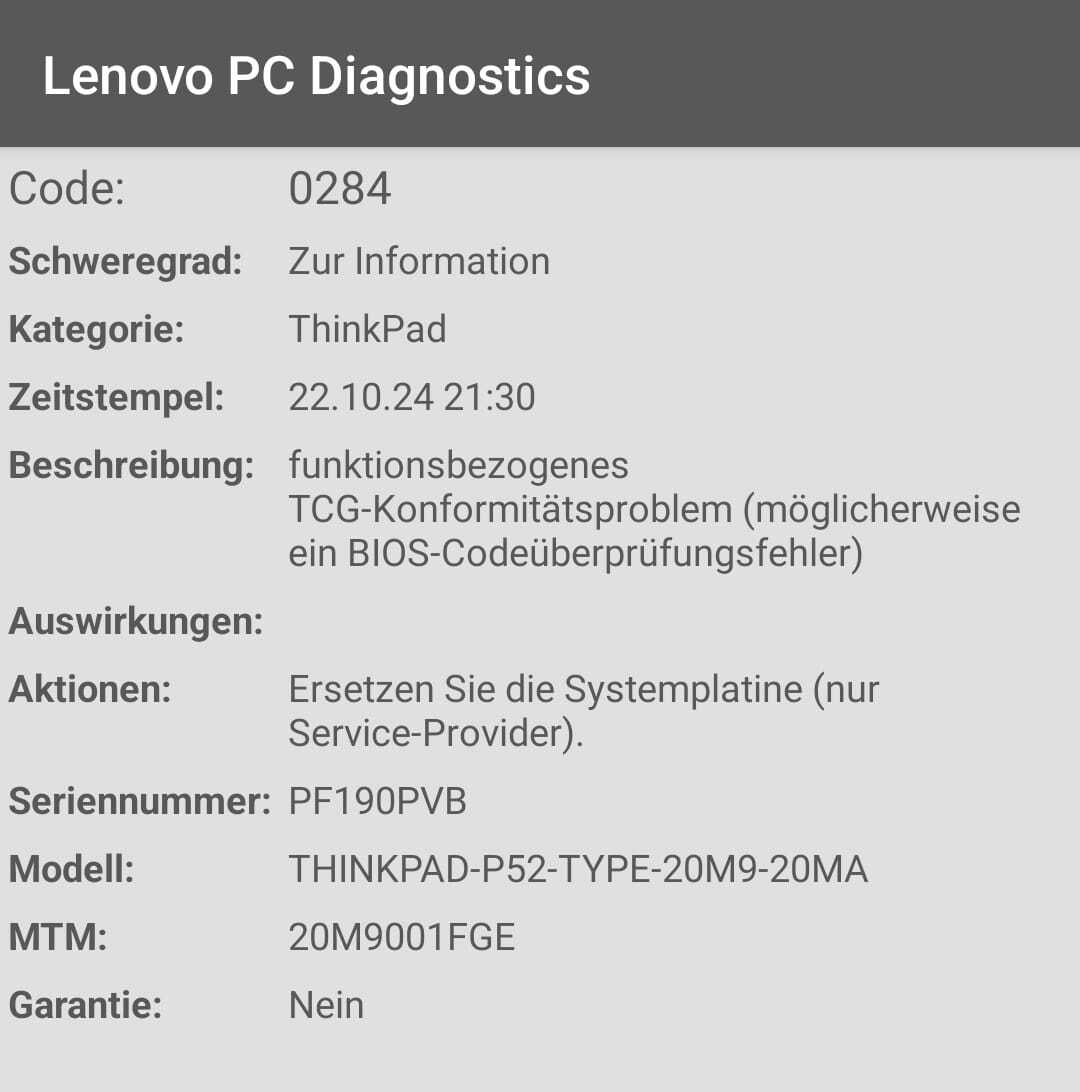

    Hello!
    I received a Lenovo P52 20M9. When it starts it just makes a series of beeps. According to diagnostics, this is error 0284. I have already tested other bios with Ch341 but without success. Or the power LED lights up 3 times and nothing happens, or the beep sequence comes with 0284.
Name:	WhatsApp Bild 2024-10-25 um 08.26.50_b517dc28.jpg
    I hope that you can help me. It's too good for me to destroy.​

    Post original bios file and serial number .

      I have the original bios. but I think he didn't save it correctly. But it's worth a try.​
      Serial Number: PF190PVB

        I did some reading. Is there a way to repair a laptop like this if there is no bios dump.
        I have already tested various bios dumps from other users. There are 3 behaviors.
        Behavior 1:
        The "i" from ThinkPad and the power button flash 3x. Everything stays black and the device switches off.
        Behavior 2:
        Only beep melody which means Error 0284.
        Behavior 3:
        After starting, the keyboard lights up and the fans rotate for a short moment. Afterwards the device restarts, then the same behavior. Then there is a restart. Then comes Beep Melody (0284).
        I received the device with the 0284 problem, can this device still be repaired? or do the chances look very bad.
        Sorry about the bad English.​

          power button flash 3x. Everything stays black and the device switches off​
          System are not detecting a bios chip. Check your connections in this case.
