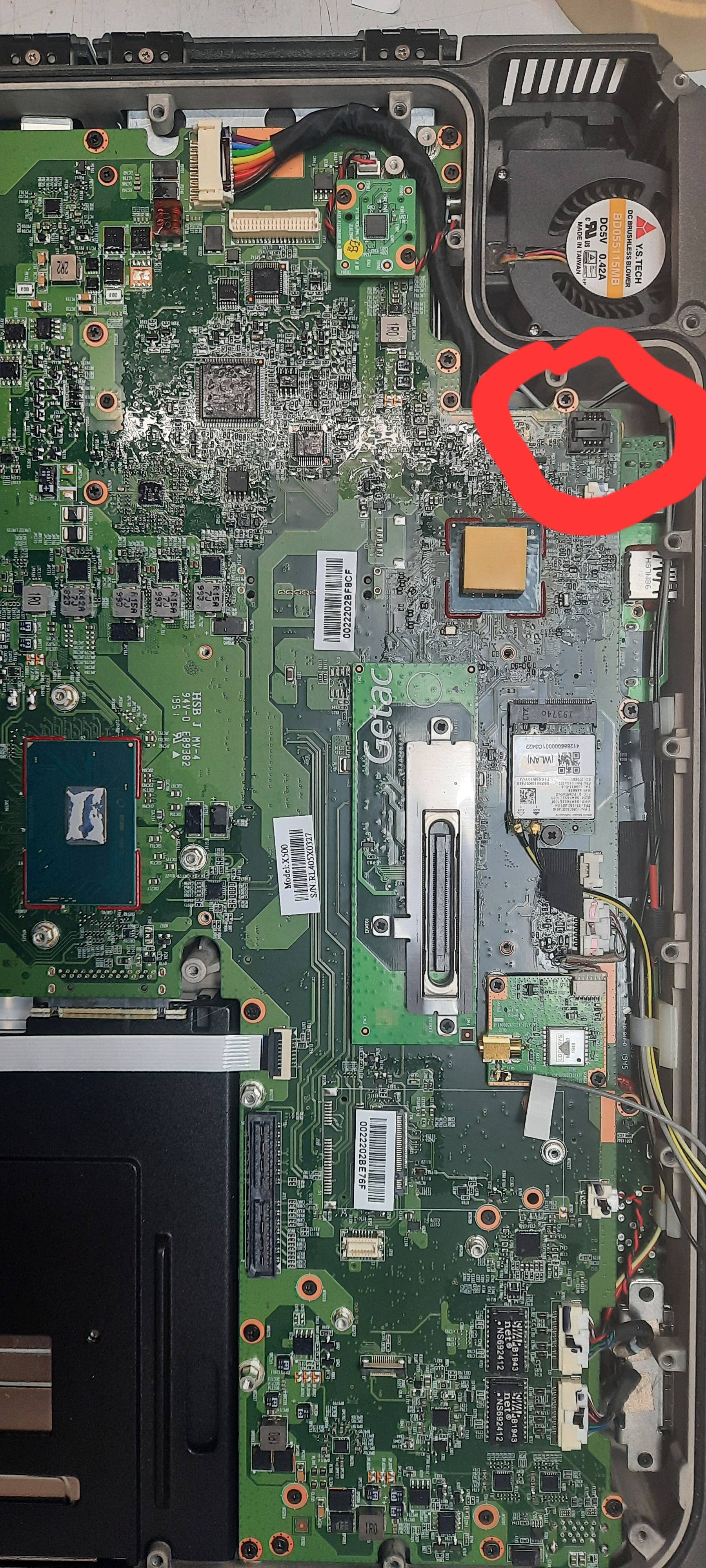

                      We can`t help unless you post your bios backup. What programmer and software version do you have and what is the chip part number.
                      • Tony31000
                        • Jul 2025
                        • 5
                        • france
                        Hello SMDFlea,
                        my chip PN is : S25FL008K
                        and you can DL my .bin here : ***************
                        Thank you
                        Tony
                          • 21094
                          Originally posted by Tony31000
                          Hello SMDFlea,
                          Thank you
                          Tony
                          Please add files directly to your post in a zip or rar. It`s wrong anyway, that`s the 1MB EC firmware (the chip is 1MB) , find the bios..16MB ,it will probably say 128 on it , 25Q128 or similar
                          • Tony31000
                            • Jul 2025
                            • 5
                            • france
                            Hello SMDFlea,
                            you're right, the PN is : 25Q128FVSG and my .bin is in the attached file .zip.
                            and for those who, like me, have trouble identifying the bios chip, it is located here on this PC :
                            Thank you for your help
                            Tony
