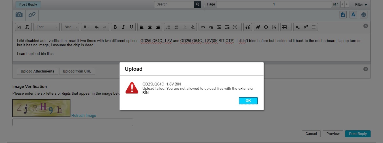

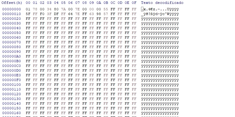

          I did disabled auto-verification, read it two times with two different options: GD25LQ64C_1.8V and GD25LQ64C_1.8V(8K BIT OTP) it´s still corrupted, I didn´t tried before but I soldered it back to the motherboard, laptop turn on but it has no image, I assume the chip is dead.
          I can´t upload bin files, but the file in hex editor looks like the image, that´s why the zip is so small
            • 21465
            Its not a One Time Programmable chip (8K BIT OTP) , so choosing that will make no difference,other than adding extra code to the end of the file. Anyway, do you have another programmer you can try, a CH341A or something
