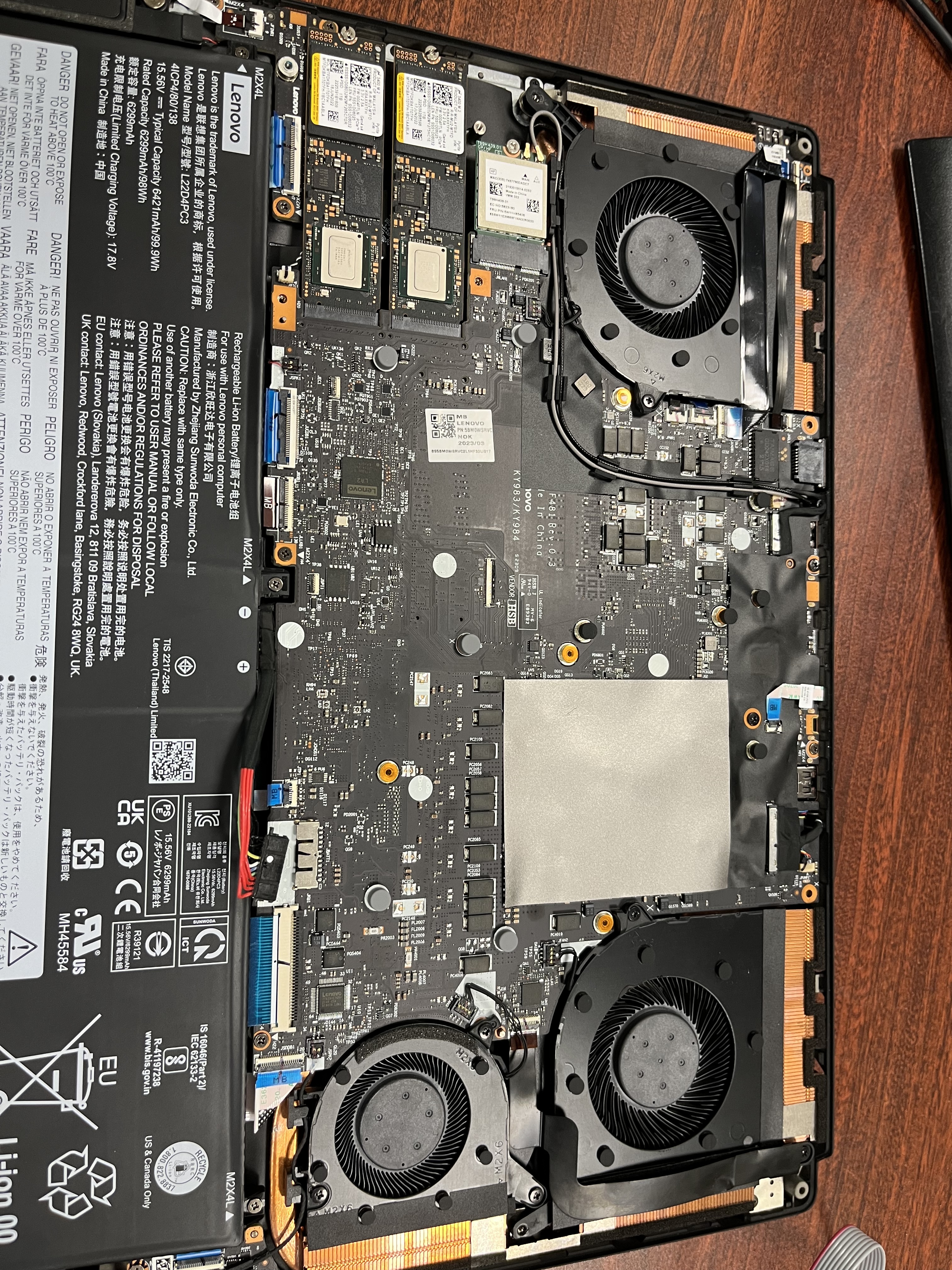

    Hi guys,
    need bios for lenovo legion 9 16irx9.
    unfortunately serial number is not readable.
    here is the bios dump:

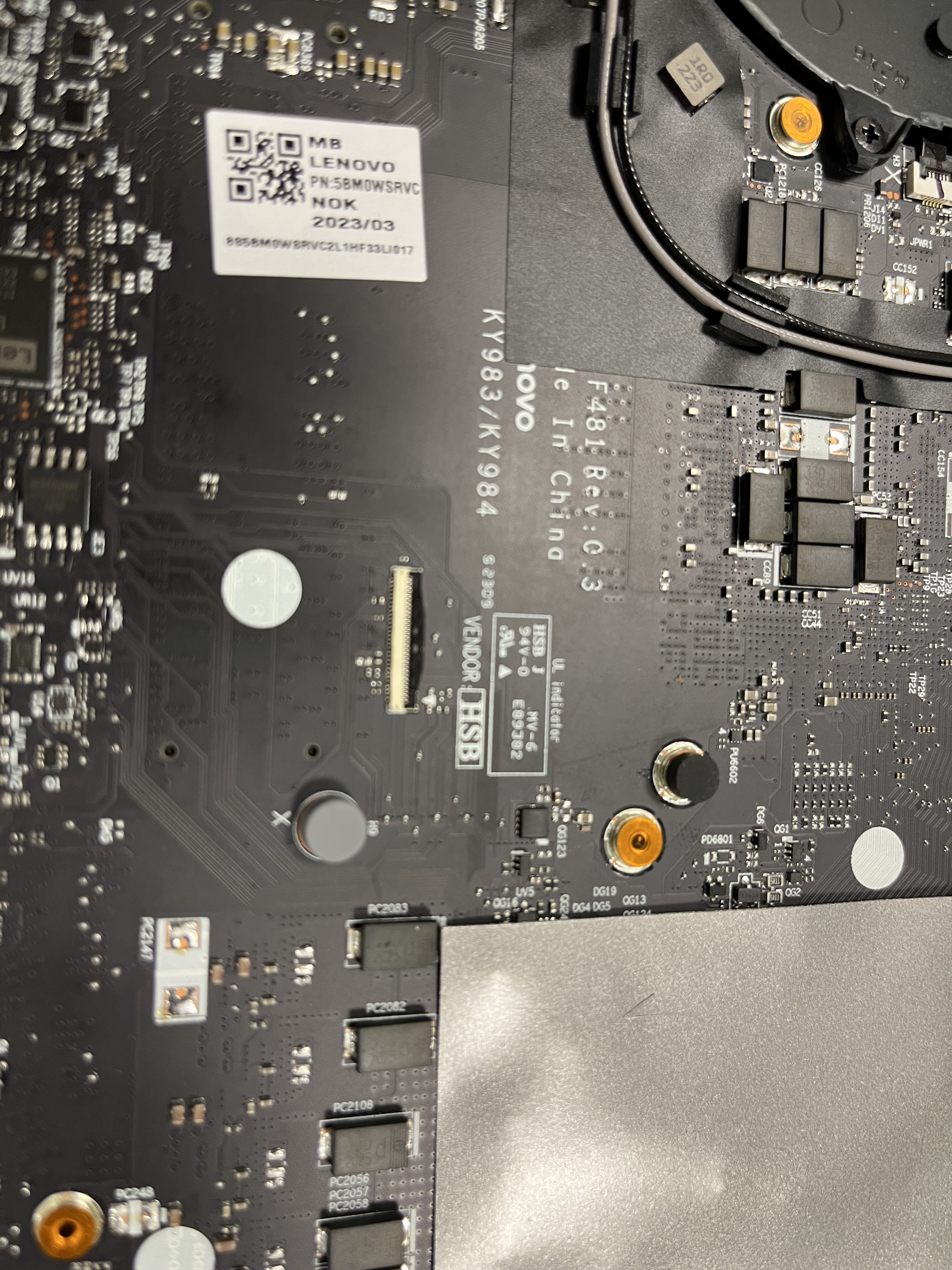

      Can you publish the complete board number of the motherboard, or take a photo of the board number.

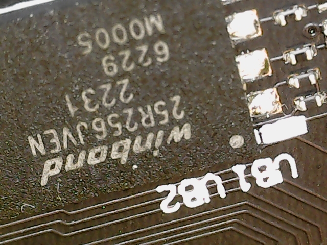

        The published content is incorrect, they should be 32M or 64M content, chip 25Q256xxxx or 25Q512xxxx or something like that.Find them and re-read the upload.

          thanks for reply. I will take a picture of board model number tomorrow.
          • Jeff-M
            • Aug 2024
            • 24
            Here is MB piture

              Also i found the right bios chip, see attached pic. It is kind of flat and i cannot read it using my CH341A black. Is there any way to read it without removing it from MB?
                (CH341A) is not recommended to read this chip.....
                Enter all the information on the board.​
                You need a good recorder and this adapter....

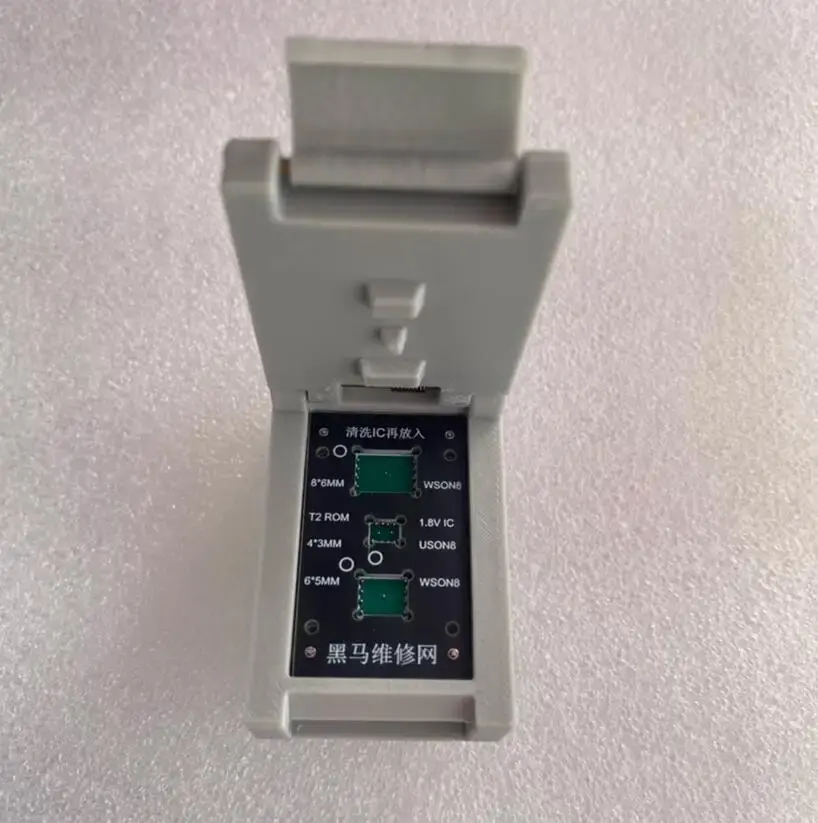

                  Thanks, where can i order it?
                  • Ponto da Manutenção
                    • May 2024
                    • 99
                    • Brasil

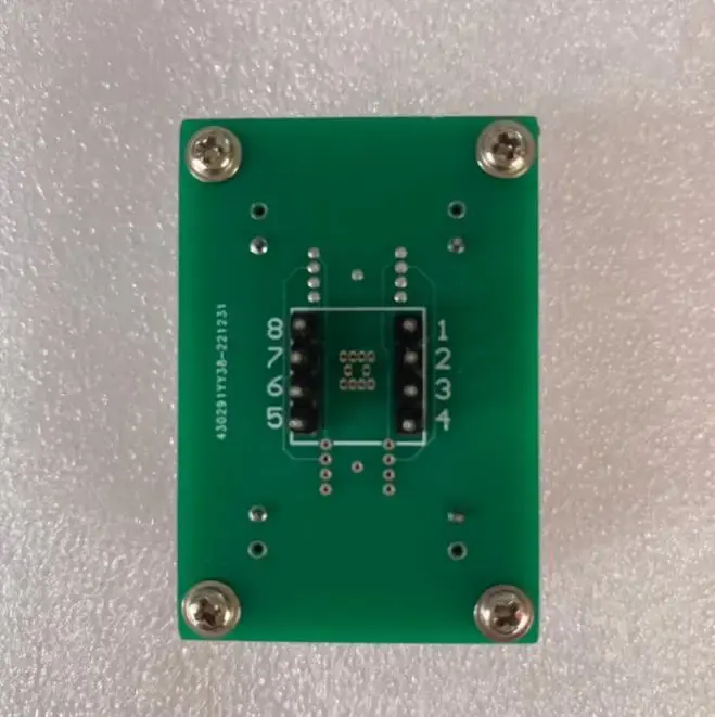

                    Qfn8 wson8 uson8 t2 rom chip 3 em 1 leia escrever bios soquete para mackbook notebook reparo - AliExpress 34
