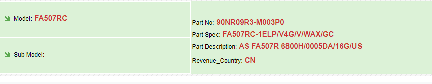

Asus FA507R bios needed
  • 147369258
    replied
    Please help. This is the model and specifications of my laptop. It restarts in Windows. There is probably a problem with the BIOS. Thank you for checking.
    FA507RR-HQ007
    SN:N3NRCX07S63411D
    DANJMMB1AA0 REV:A
    MODEL:NJM
    Leave a comment:
  • gandz1234
    replied
    Thank you m1ch43lzm it's working 100%
    Leave a comment:
  • m1ch43lzm
    replied
    Originally posted by gandz1234
    Hi. Please can you unlock the BIOS or let me know what the password is.
    Laptop info:
    Model : FA507RE-HN021
    SN: N3NRCX08X96911E
    CPU: Ryzen 7
    Pass
    Code:
    121205
    Code:
    Inusia2006
    First one is boot password, the second is supervisor (BIOS setup) password, try both
    Last edited by m1ch43lzm; 09-28-2025, 12:55 PM.
    Leave a comment:
  • gandz1234
    replied
    Hi. Please can you unlock the BIOS or let me know what the password is.
    Laptop info:
    Model : FA507RE-HN021
    SN: N3NRCX08X96911E
    CPU: Ryzen 7
    Leave a comment:
  • m1ch43lzm
    replied
    Try, BIOS estracted from ASUS website with serial/win key inserted
    FA507RE
    S/N N3NRCX09332411B
    Bios ver. 315
    Leave a comment:
  • moyasar service
    replied
    hello everyone i hope everyone is doing well, i have this laptop that it boots up normally to bios menu and read everything fine ram hard drive CPU info all okay but when i try to boot on windows it restart on its own i try to use ez asus bios update didnt work so this is my original file can you guys check is there is something wrong with it or clean it for me i would be thankful if you guys help me out
    thank you.
    ___laptop info___
    model : FA507R
    sn: N3NRCX09332411B
    cpu: ryzen 7
    Leave a comment:
  • Zubiyrbozri
    replied
    Originally posted by SMDFlea
    EC. Try EC1 first.
    Ok I will try it and get back to you. Thanks
    Leave a comment:
    replied
    Originally posted by Zubiyrbozri
    I was looking to get the Firmware for the Super I/O of the same board. Asus TUF FA507RE-A15.R73050T with the DA0NJNMBAD0 REV-D model - NJN Board
    SN - N1NRCX10S90404F
    Also I you cant get the Firmware what is the similar board that can Replace this Super I/O. The SIO name is ITE IT5570VG-128 DXO
    Thanks.
    EC. Try EC1 first.
    Leave a comment:
  • Zubiyrbozri
    replied
    I was looking to get the Firmware for the Super I/O of the same board. Asus TUF FA507RE-A15.R73050T with the DA0NJNMBAD0 REV-D model - NJN Board
    SN - N1NRCX10S90404F
    Also I you cant get the Firmware what is the similar board that can Replace this Super I/O. The SIO name is ITE IT5570VG-128 DXO
    Thanks.
    Leave a comment:
  • guyandpit
    replied
    Originally posted by noname2024
Name:	2024-12-14_230450.png
Views:	375
Size:	5.3 KB
ID:	3528305
    ok
    thank you ill try later
    Leave a comment:
  • noname2024
    replied
    Originally posted by guyandpit
    hi im looking a good bios for asus tuf fa507r, the original bios is corrupted need you help guys thank you and more power badcasp! below are the details and corrupted bios file
    model: asus tuf fa507r
    serial: r4nrcxcnr26a16e
Name:	2024-12-14_230450.png
Views:	375
Size:	5.3 KB
ID:	3528305
    ok
    Leave a comment:
  • guyandpit
    replied
    Originally posted by hoaca388
    Backup fault. Serial number doesn't get me anywhere, check serial number again.
    Hi the Bios is corrupted that why there is no serial i need a new same as my motherboard. Thank you
    Leave a comment:
  • hoaca388
    replied
    Originally posted by guyandpit
    hi im looking a good bios for asus tuf fa507r, the original bios is corrupted need you help guys thank you and more power badcasp! below are the details and corrupted bios file
    model: asus tuf fa507r
    serial: r4nrcxcnr26a16e
    Backup fault. Serial number doesn't get me anywhere, check serial number again.
    Leave a comment:
  • peste
    commented on 's reply
    post merged..
  • guyandpit
    replied
    hi im looking a good bios for asus tuf fa507r, the original bios is corrupted need you help guys thank you and more power badcasp! below are the details and corrupted bios file
    model: asus tuf fa507r
    serial: r4nrcxcnr26a16e
    Leave a comment:
  • salawayon
    replied
    Originally posted by hoaca388
    FA507RC
    tried but still the same. maybe not bios related issue anymore... thanks...
    Leave a comment:
  • hoaca388
    replied
    Originally posted by salawayon
    no display issue on this one.
    infos:
    DA0NJNMBAD0 REV D
    SN: R3NRCXCNR03T118
    Thanks...
    FA507RC
    Leave a comment:
  • salawayon
    started a topic Asus FA507R bios needed
    Asus FA507R bios needed
    no display issue on this one.
    infos:
    DA0NJNMBAD0 REV D
    SN: R3NRCXCNR03T118
    Thanks...
  • pirati
    by pirati
    10-27-2025, 04:20 PM
  • grimacelord
    ASUS TUF GAMING Z790-PLUS WIFI - BIOS Help
    by grimacelord
    I have spent the last hour on this and I guess this is just over my head, so here I am.
    I have an ASUS TUF GAMING Z790-PLUS WIFI motherboard here that needs to have the BIOS updated in order to accept the latest CPUs.
    The BIOS chips seem to come as a set of two: GD25B64ESIG and GD25B128ESIG. My guess is one of them is a fail-safe for the main BIOS? I really don't know. Or one of them is ME and other is BIOS? I don't know.
    Anyway, I took dumps of both chips and then downloaded the latest update for this motherboard from ASUS's website...
    07-10-2025, 02:52 PM
  • jbonavita
    by jbonavita
    Some issues
    Things I tried
    04-29-2025, 09:38 PM
  • throwaway327
    Asus ROG Ally X -RC72LA - changed hidden bios settings with 'Smokeless-UMAF', won't get past boot logo
    by throwaway327
    ASUS ROG Ally X - (Handheld Gaming PC)
    Model No: RC72LA
    Serial No: SBNVKD001014459
    Hi all, I've spent the past week digging through the forums and guides to try correct my foolish mistake of changing hidden settings while tinkering around, and to be honest my heads overloaded so I'm hoping you'll be able to help.
    I used a tool called 'Smokeless-UMAF' to access usually hidden settings in the bios. I tweaked one or two 'safe' things but made the mistake of tweaking a lot of settings under 'USB/Thunderbolt Configurations' when I didn't know what they did. For...
    06-18-2025, 05:52 PM
  • ArkzG
    [REQUEST] ASUS TUF A15 FA506NF (2021) - Clean BIOS dump needed (UEFI Password locked)
    by ArkzG
    Hey guys, I have an "ASUS TUF Gaming A15 FA506NF (2021)" that's locked with a UEFI password, I need to reprogram the BIOS chip but can't find a clean ".bin" file for this specific model, I've tried the official BIOS updates from ASUS support page, but they're 32MB updaters that don't extract to a usable 2MB .bin file for direct chip programming.
    What I currently have available:
    - Model: FA506NF (2021)
    - BIOS chip: GD25LQ16 (16Mbit/2MB)
    - Tools: CH341A programmer ready to use
    Does anyone have either a clean 2MB .bin dump of this model,...
    09-26-2025, 09:34 PM
