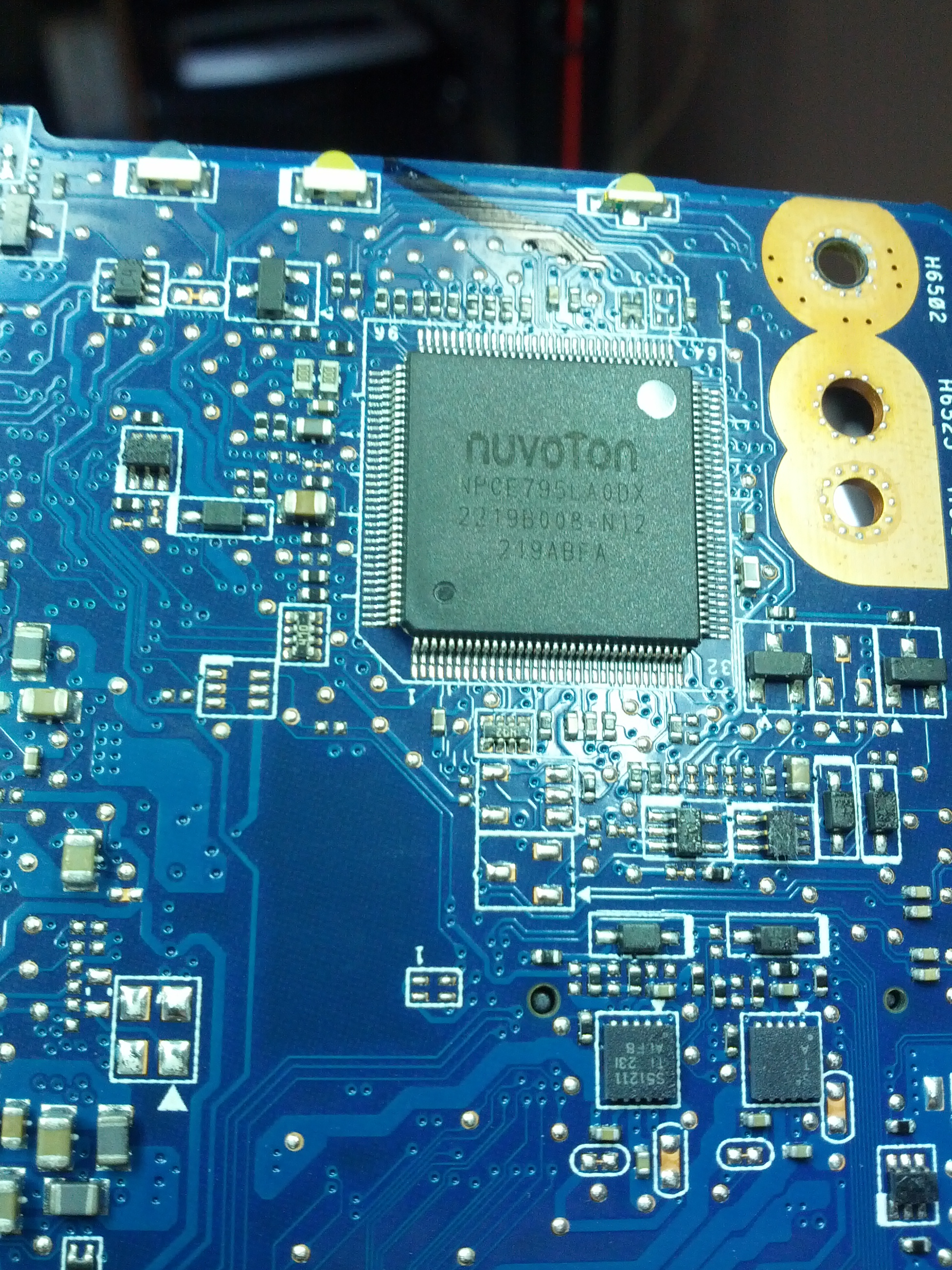

          I read your thread but my motherboard has a nuvoton chip and even the chip which I suspect is the bios has a different location then yours.

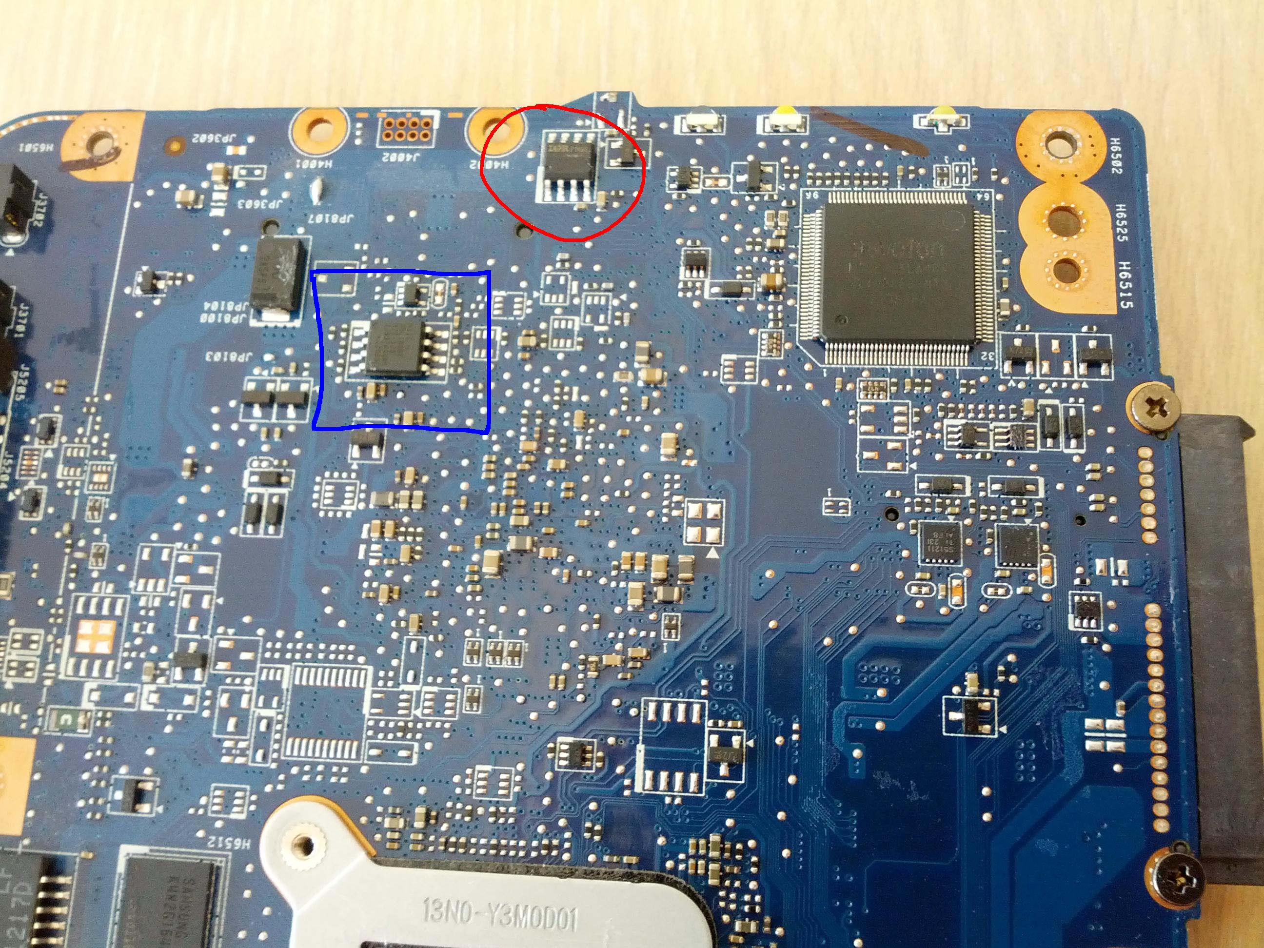

                        Here are the partial pictures of the board. The chip is a Nuvoton NPCE795LA0DX. Im not sure which of the two chips contains the bios flash(red circle or blue square). Since I dont have the schematic I also find it difficult to identify the chip version in order to flash it with my programmer.
                        • lezsimply
                          The Wanderer
                          • Jan 2013
                          • 659
                          • Philippines
                          Re: Toshiba Satellite C850D no video, maybe bios needed
                          blue one but cannot identify part number. please input markings on chip if possible.
                            If I managed to read it correctly:
                            MXIC M*
                            25L1606E
                            • lezsimply
                              The Wanderer
                              • Jan 2013
                              • 659
                              • Philippines
                              This is most likely MX25L1606E by Macronix (MXic) so that concludes it is bios chip.
                                Yes, I managed to flash it but the same problem persists. Laptop start, power indicator is on but no vga signal on lcd or vga out.
