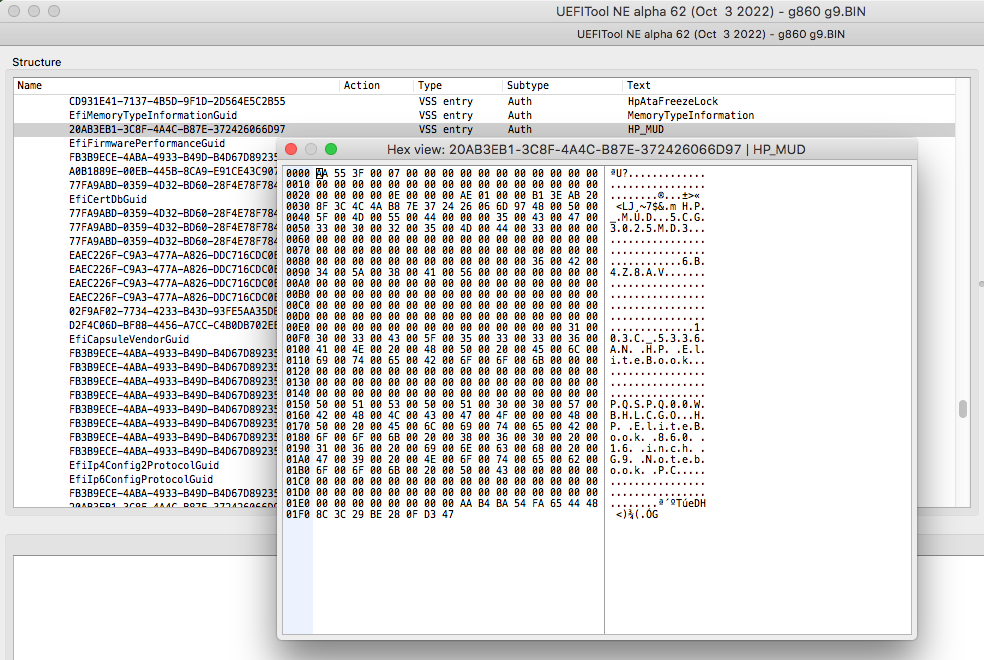

                    • Ghamidi
                      • Mar 2020
                      • 306
                      • France
                      Originally posted by kingnizarios
                      Hi can some one help me please to extract the dmi information from my bios dump.
                      Serial Number : 5CG3025MD5
                      Product Number : 6B4Z8AV
                      Description : HP EliteBook 860 G9
                      Product Name: HP EliteBook 860 16 inch G9 Notebook PC
                      Serial Number: 5CG3025MD3
                      SKU Number: 6B4Z8AV
                      Product Family: 103C_5336AN HP EliteBook
                      SB/CT Number: PQSPQ00WBHLCGO
                      Build ID: 22WWWPAT602#SABD#DABD
                      UUID: 54BAB4AA-65FA-4844-8C3C-29BE280FD347
                      Feature Byte: 476J6S6b7B7H7M7Q7W7m7saBaEapaqauawbUbhcAdpdqfPfXguhKhkj4jhk8mEn7nVngpDpFpVpqqjqz.Rf

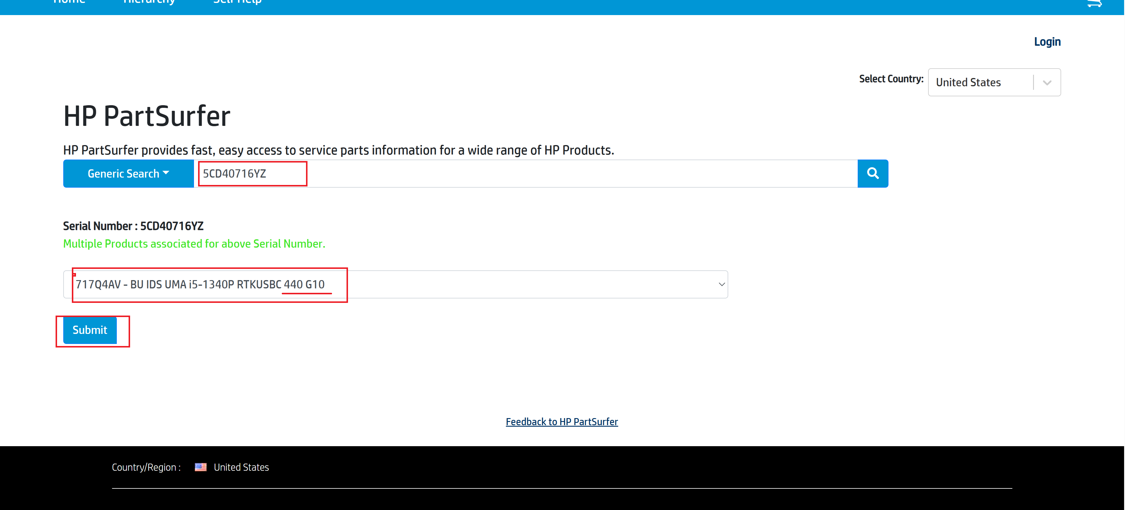

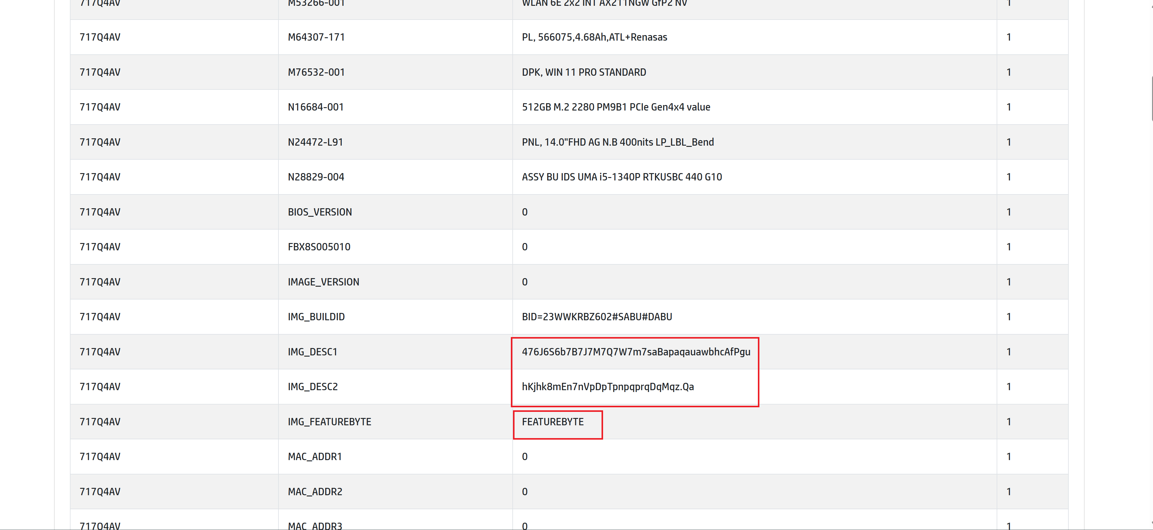

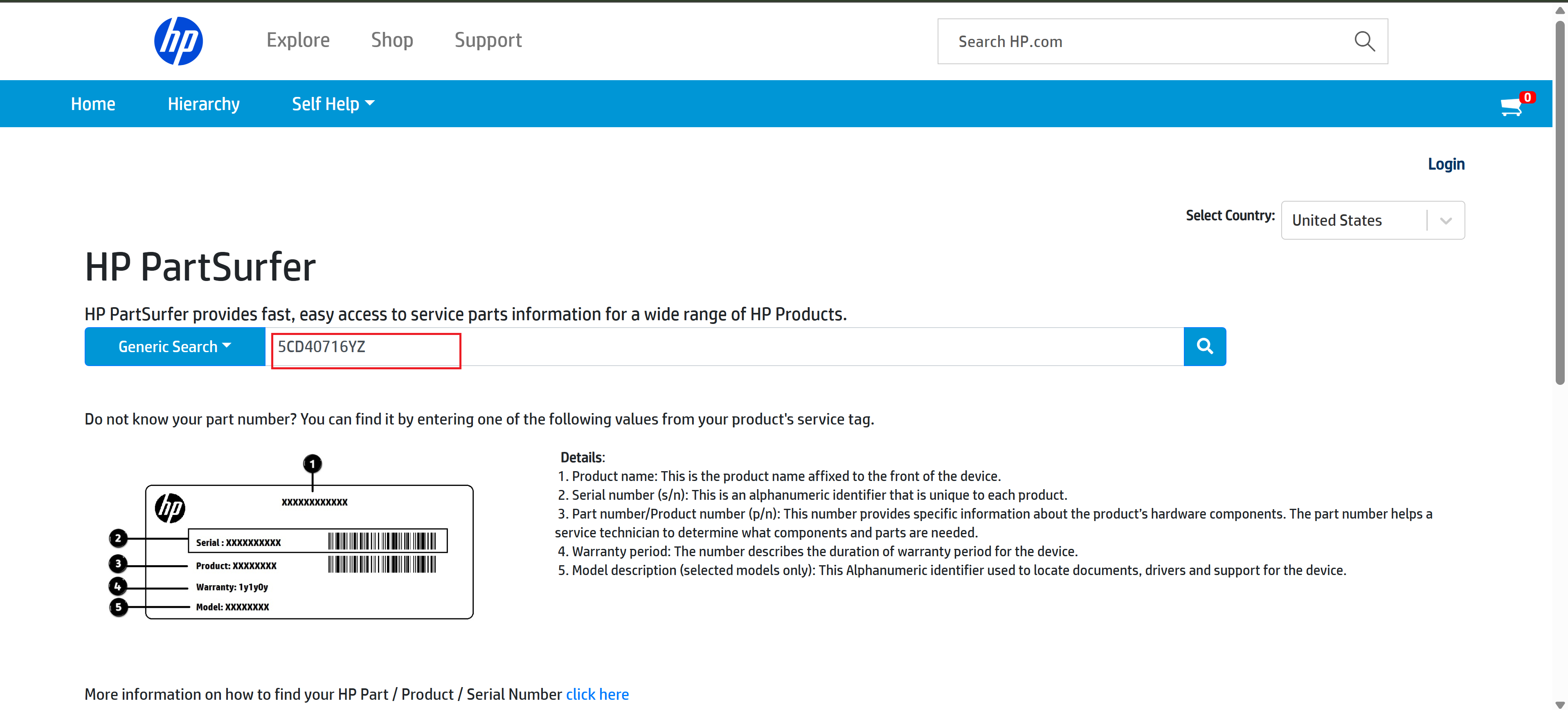

                                • hoaca388
                                  Badcaps
                                  • Jan 2022
                                  • 12433
                                  Originally posted by mesta83
                                  Could anyone help me extract my DMI from my backup dump? I unlocked the bios from a pass lock and now I struggle with finding feature byte etc. it's not on the sticker anywhere, Thank you.
                                  ProBook G440 G10 SN: 5CD40716YZ
                                  Look at the pictures
Name:	2025-04-08 16_48_13-.png
Name:	2025-04-08 16_52_25-Settings.png
Name:	2025-04-08 16_53_13-.png
                                  https://partsurfer.hp.com/
                                  • mesta83
                                    • Nov 2015
                                    • 75
                                    • merseyside
                                    That's amazing thank you, I'll remember this method. How about SKU and System board CT number? What method can I use to get those please
                                    nvm found CT number under RAM. Still unsure about SKU tho
