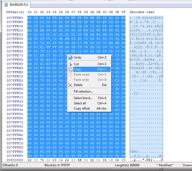

    I need help extracting a BIOS from Lenovo official website, for ThinkPad E465 (AMD)
    NM-A621
    • 20631
    Laptop serial number ? , which bios,where

      my file does not send video, it was reviewed with another one found on another website but it is a very old version, with errors it does not load windows
      S/N: PF0LX3PT
        • 20631
        S/N: PF0LX3PT
        Download the bios update,Innoextract and HxD Hex editor

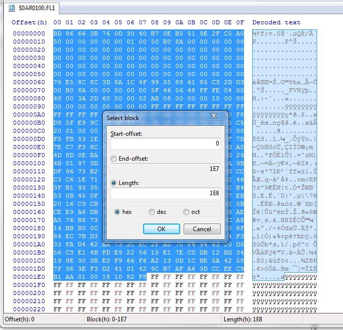

        Drag and drop the bios update onto the Innoextract exe ,it will extract the updates into a folder called app .
        Open $0AR0100.FL1 with HxD.
        Select block 0 - 1E7 ( length 1E8) and click on the OK button.Delete the selected area with Edit -> Delete
        or press the Del/Delete key on your keyboard.
        Click image for larger version  Name:	Capture.jpg Views:	1 Size:	126.6 KB ID:	3310821

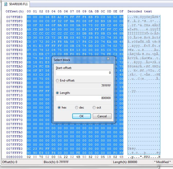

        Next, select block 0 - 7FFFFF (length 800000) 800000 is 8MB.
        Click image for larger version  Name:	Capture2.jpg Views:	1 Size:	114.7 KB ID:	3310822

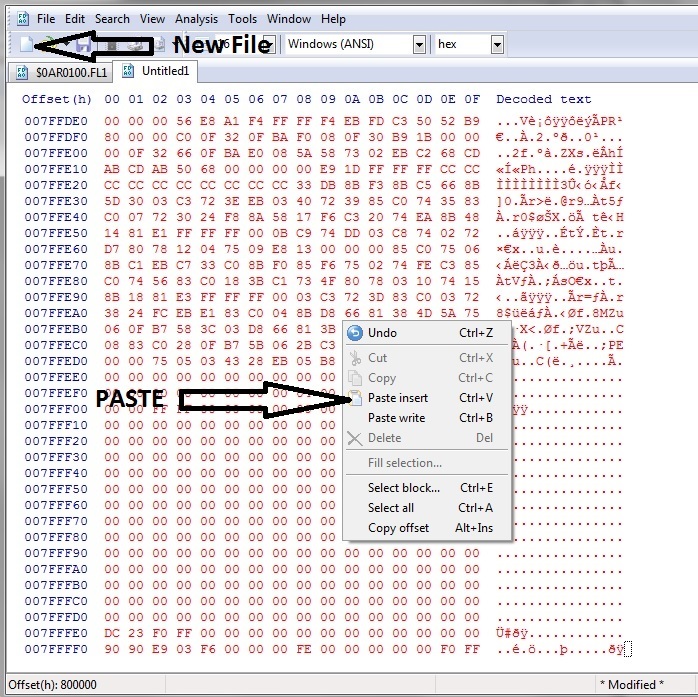

        Right click or select Edit then Copy
        Click image for larger version  Name:	Capture3.jpg Views:	1 Size:	165.9 KB ID:	3310823
        Choose New File,then select Paste Insert
        Click image for larger version  Name:	Capture4.jpg Views:	1 Size:	214.3 KB ID:	3310824

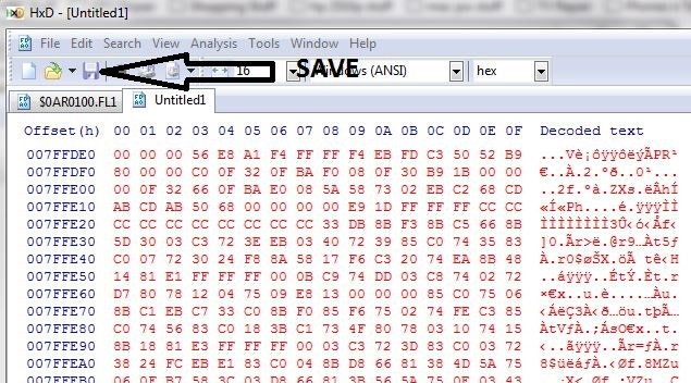

        Choose Save, name it anything you want with a bin extension such as bios.bin
        Click image for larger version  Name:	Capture5.jpg Views:	1 Size:	105.0 KB ID:	3310825

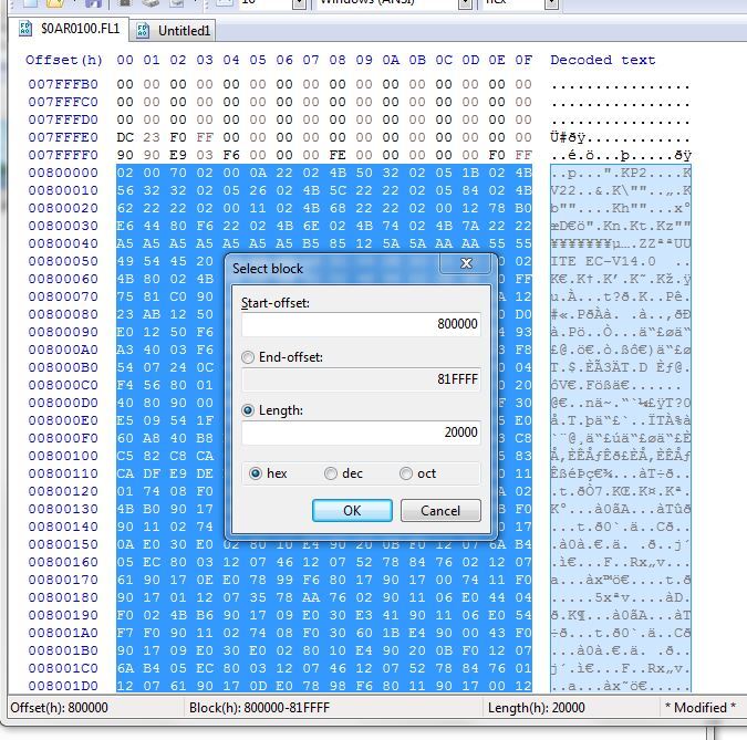

        The update has an EC file as well,if you want it the start offset is 800000 and enter the length as 20000 . 128KB = 20000
        Copy to a new file and save.
        Click image for larger version  Name:	Capture6.jpg Views:	1 Size:	95.2 KB ID:	3310826

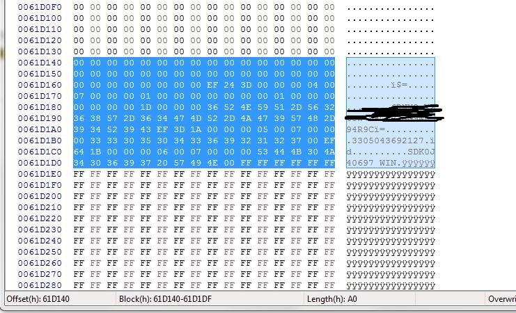

        Your backup doesn`t have any DMI, its stored in the EC.It does however have a windows key.If you want to
        copy that to the new bios select offsets 61D140 - 61D1DF in both,and copy/paste.
        Click image for larger version  Name:	Capture7.jpg Views:	1 Size:	153.9 KB ID:	3310827

          excellent contribution, extremely grateful, not all people share their knowledge, my team works correctly
