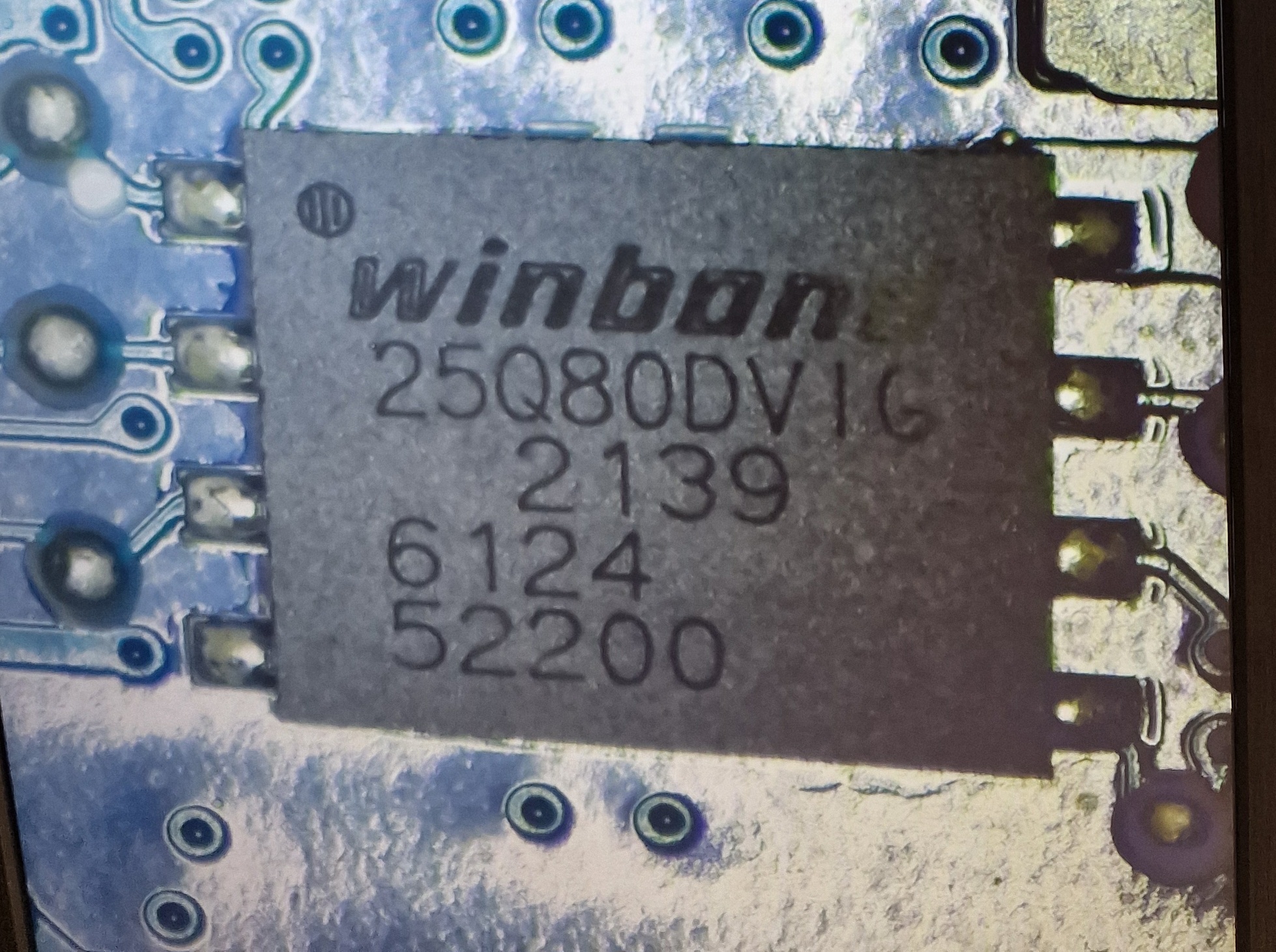

    I have the following notebook:
    HP Omen 17-ck0010nl
    SN: 5CD2018YV7
    MAINBOARD: DA0G3LMBCG0 REV G
    BIOS CHIP: WINBOND 25Q80DV16 2139 6124 52200
    The computer stop posting while whatching youtube. It turns on, stay on, it charghes the battery and turns off if i push the power button. I have all the necessary rails present, no shorts were found. Already disconnected everything from the mainboard and change the ram (trying even one per time in both slots).
    At this point i believe is a bios problem. I try with an usb pendrive and the bios on the HP site but it doens't work (i knew it but i still tried).
    I'm not expert of bios, i know since it's an intel i can't just flash the HP BIOS from the site into the bios chip. I'm about to make a reading of my current Bios and i'll save it, if needed i can upload it here.
    What shoud i do?
    Thnaks

      Ok, I couldn't read the chip with the clip that comes with the ch341. Tomorrow morning or Monday I'll desolder it and solder it on the adaptor. I hope the cheap reader won't give me hard time. Then I'll post it here.
      Maybe it's the ME region 🤷
        SMDFlea commented
        Editing a comment
        The 25Q80DV16 is not the bios chip
    • DoOm86
      • Nov 2022
      • 42
      • italia
      SMDFlea It's a winbond, it's start with the number of 25 and has 3,2v. But maybe you are right. I just checked the datasheet and take a screenshot. I'll check the mb better asap, probably i got tricked 🤦🏻

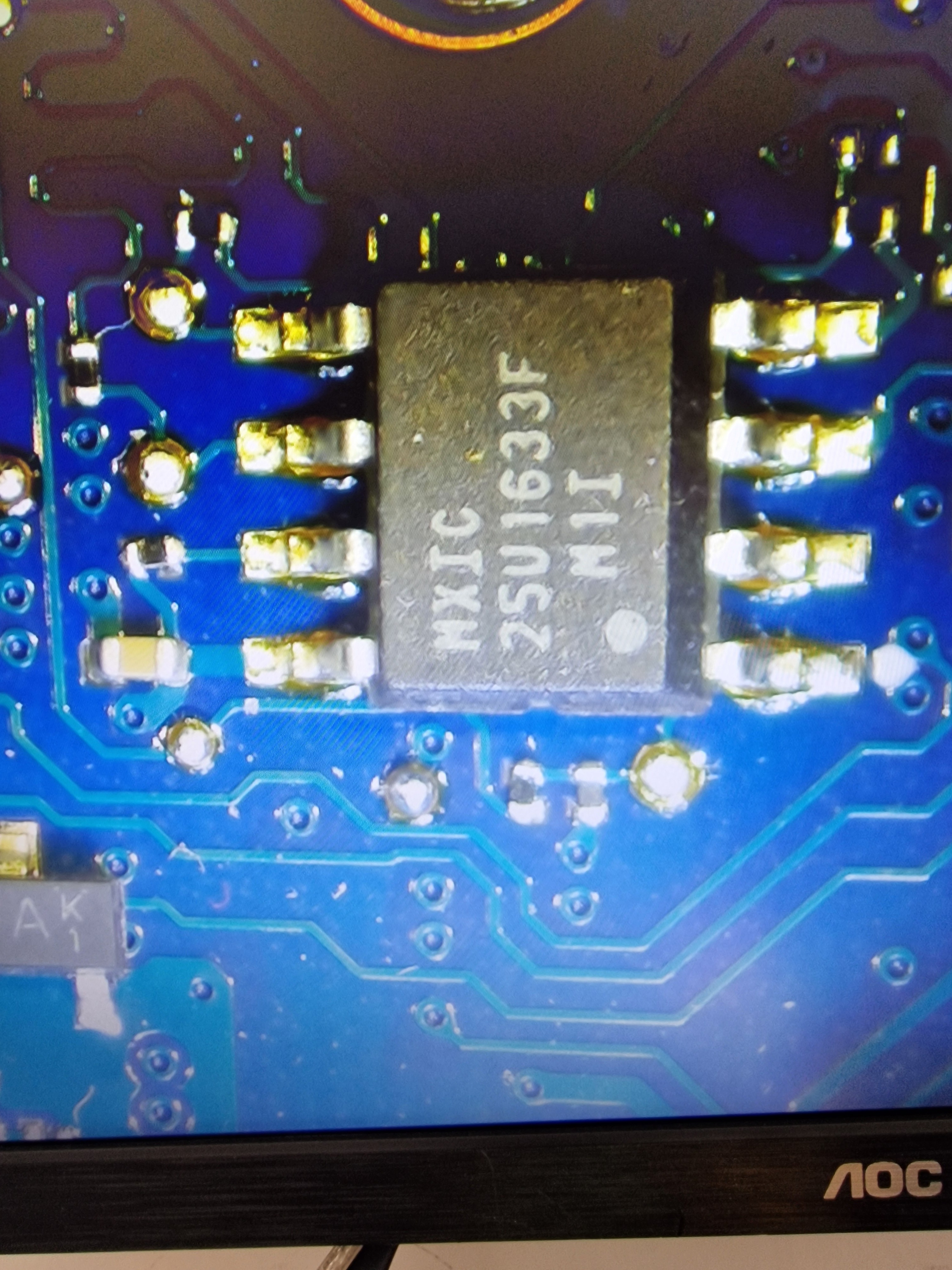

        Find which chip has the number 128 on it, for example: 25Q128DV.
        • DoOm86
          • Nov 2022
          • 42
          • italia
          OK, i found it. it's a "mxic 25u1633f".
          It doesn't have "128" in it but it is the only chip that according to the datashhet is a bios chip.

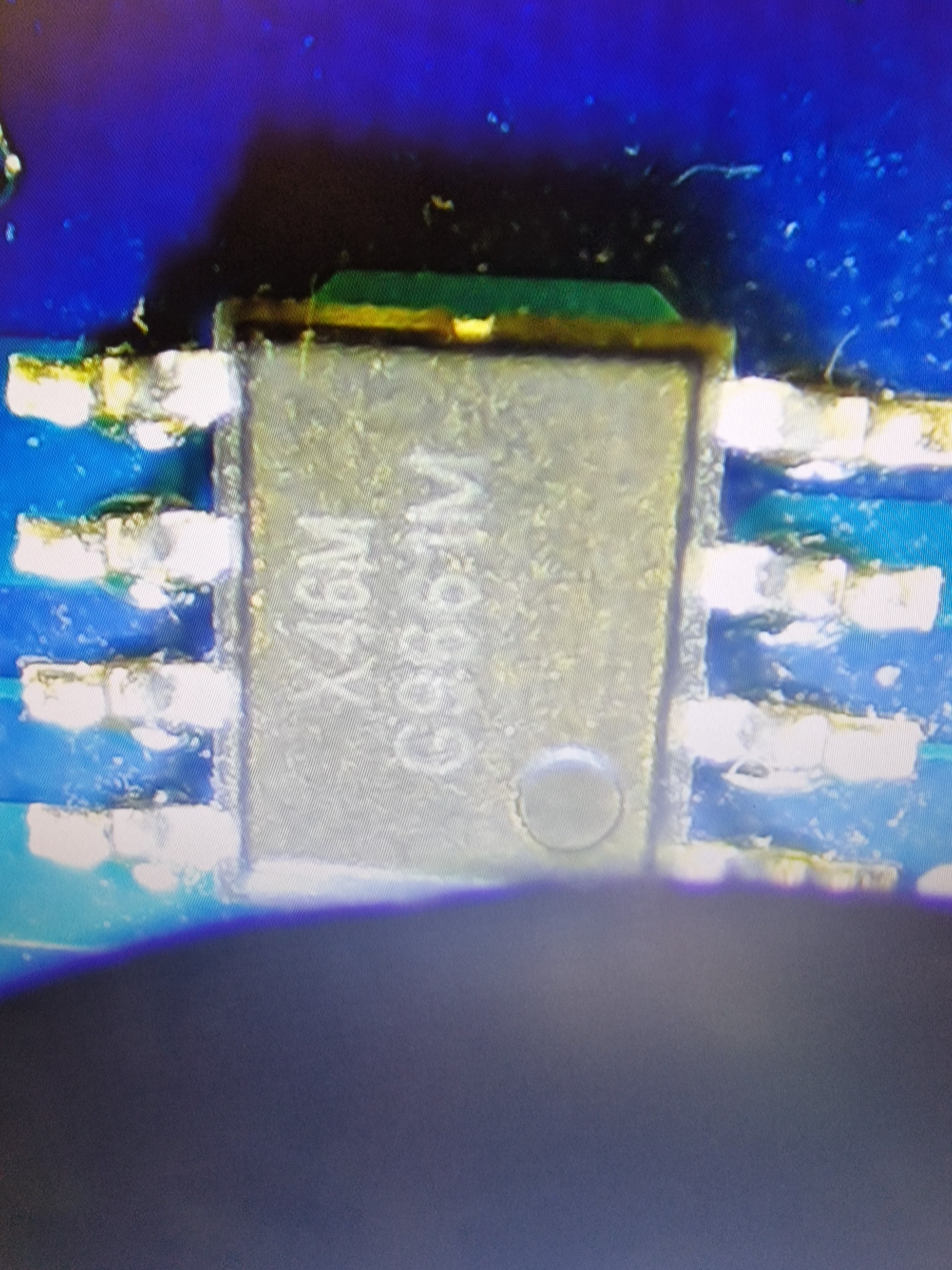

          This notebook has also another chip close to the SIO (IT5570e-256 CXA) which is still a ITE (8308fn CXA). Never seen something like this.
          I backuped the bios (hoping is this one mxic 25u1633f😆) and posted it here

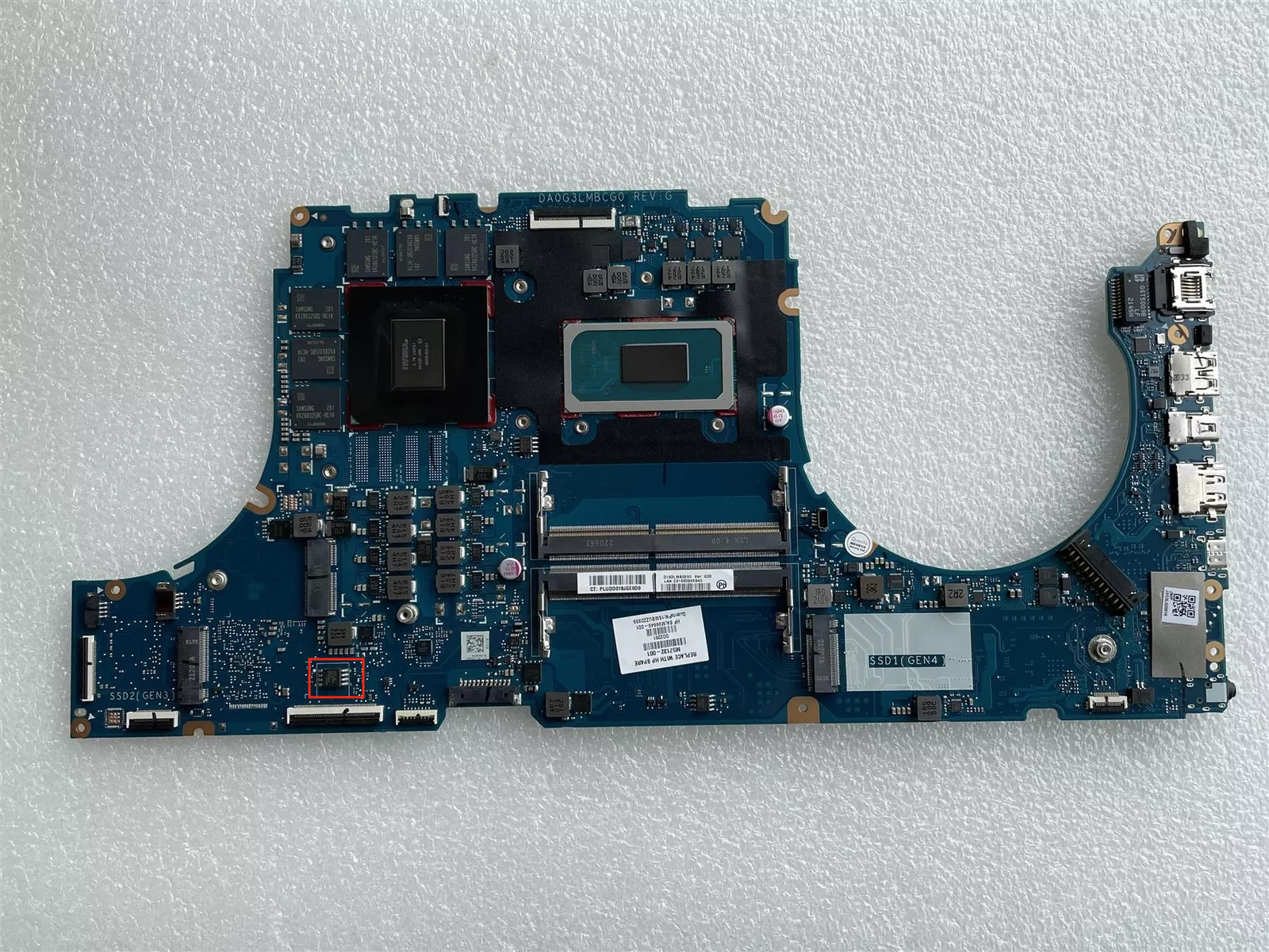

            red square
            • DoOm86
              • Nov 2022
              • 42
              • italia

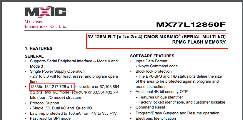

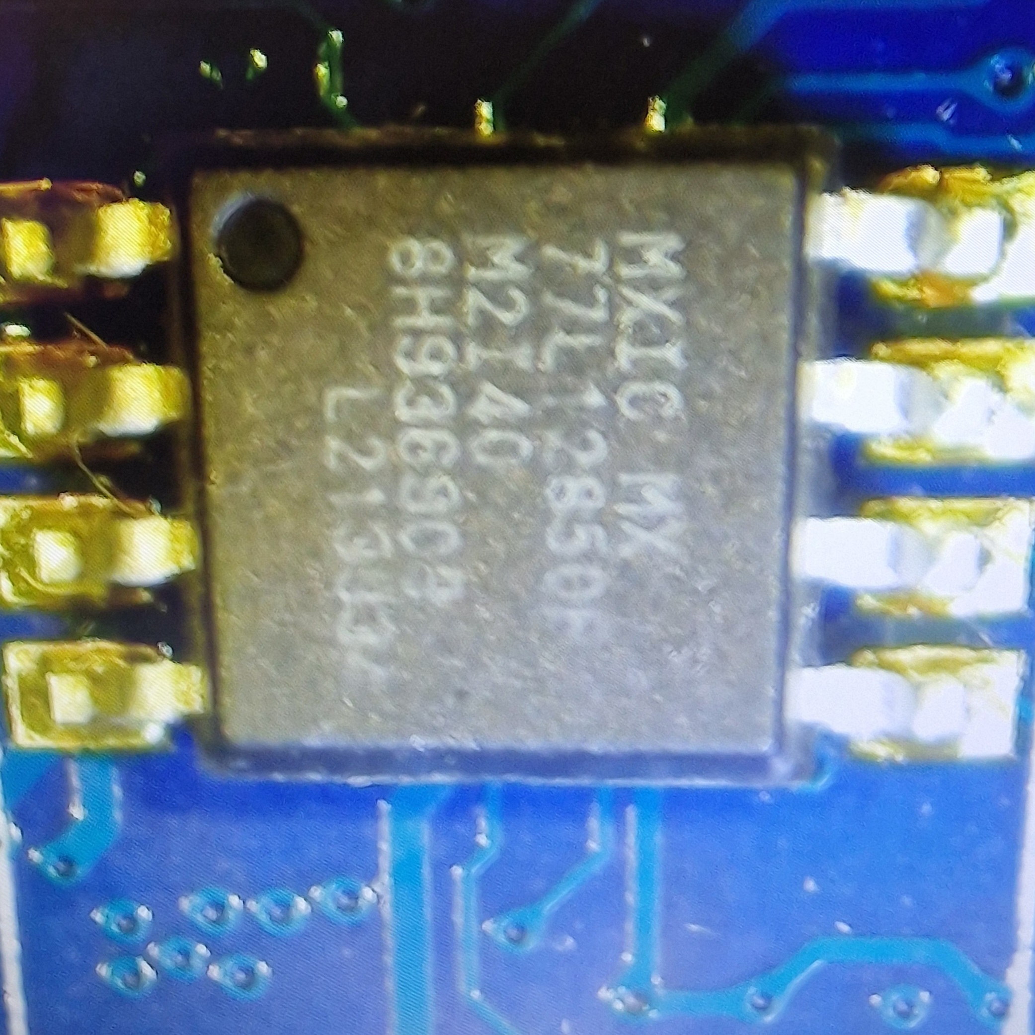

              volinakis The chip in the red square is the pic with the ic "mxic mx 77L12850F" . I took some other pics of ic on the board.
              The ic "mxic 25u1633f" that I upload the bin file previously it was close to the cpu, under the black plastic tape.
              Don't tell me I backed up the wotng bios 😅 according to the datasheet the "mxic 25u1633f" is a bios ic. The "mxic mx 77L12850F" in the red square doesn't have the "25" or "24" at the beginning like the usual bios chip has.
              ​​​​​Obviously there are many things I don't know about ic bios 😅
              Anyway if the "mxic mx 77L12850F" is the bios chip, tomorrow I can upload here the bin file.
              Thanks 🙏🏻
              • volinakis
                • Jan 2021
                • 2875
                • N/A
                Thanks 🙏🏻
                not "if", THAT'S bios chipset.

                  Ok, tomorrow I'll try to back it up and post it here, hoping my cheap bios programmer will do the job (ch341).
