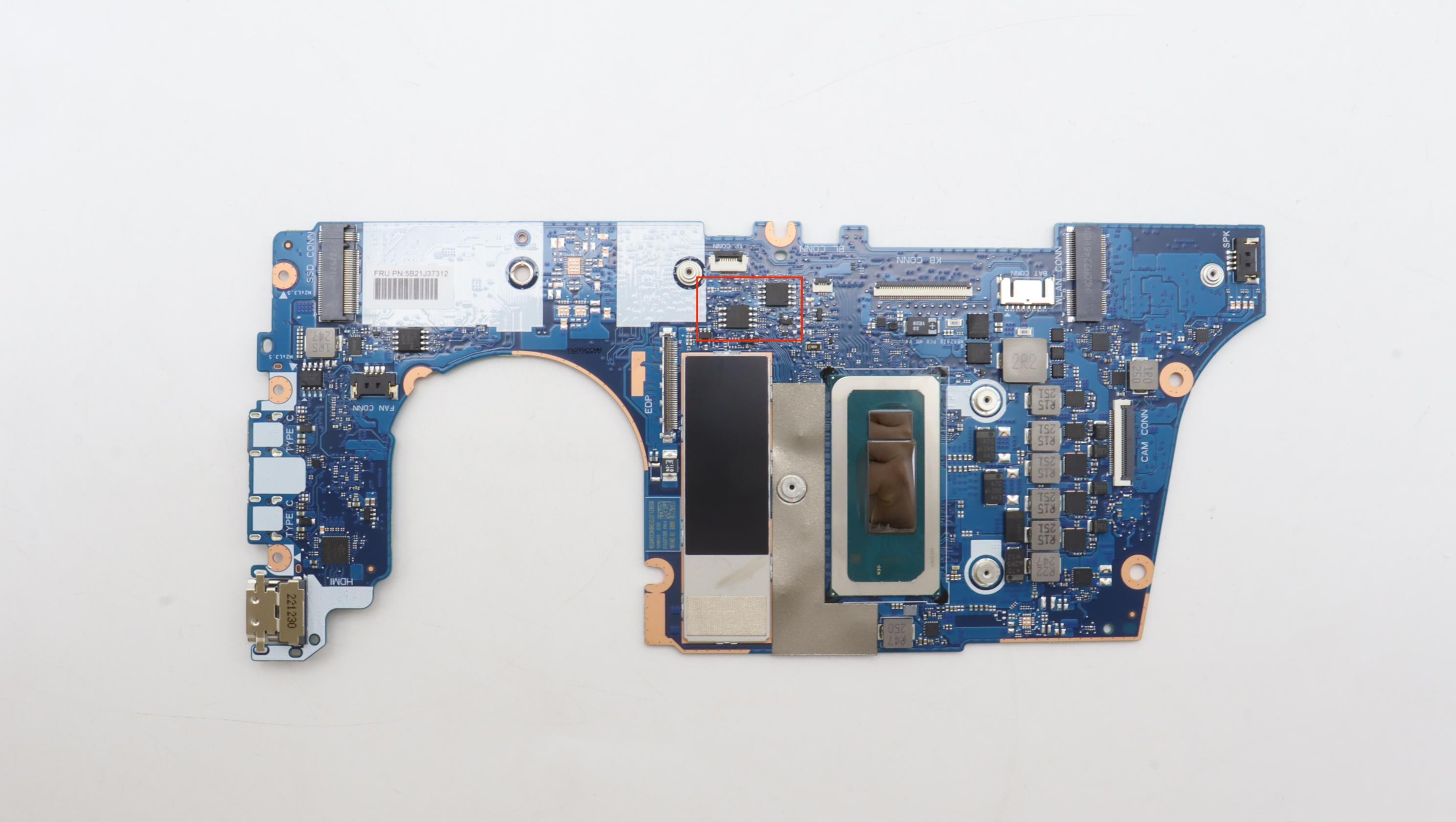

    Hey guys , i need a bios for Lenovo Slim 7 14 IRP8 - S/N YX07AAL8
    Now my laptop are not starting or starting very very hard. it's 3 months old.. Black screen, sometimes the keys are lighting sometimes not...
    Thank you in advance!

      that's not bios chipset, look for 128Mb or 256Mb chipset
        I found it, thank you!

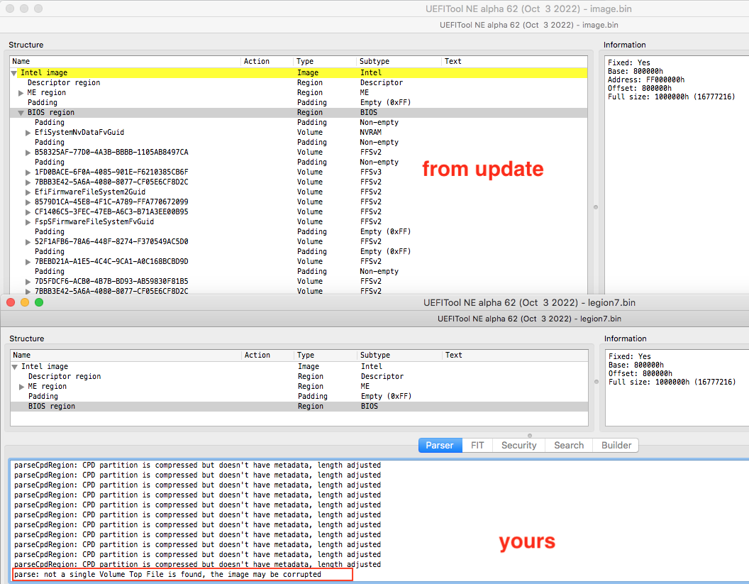

          this is not a good backup of your bios chipset. Read it 3-4 times and compare results, when you have 2 identical files it means you have a good backup. And it seems you have 2 chipsets, read them both. Click image for larger version

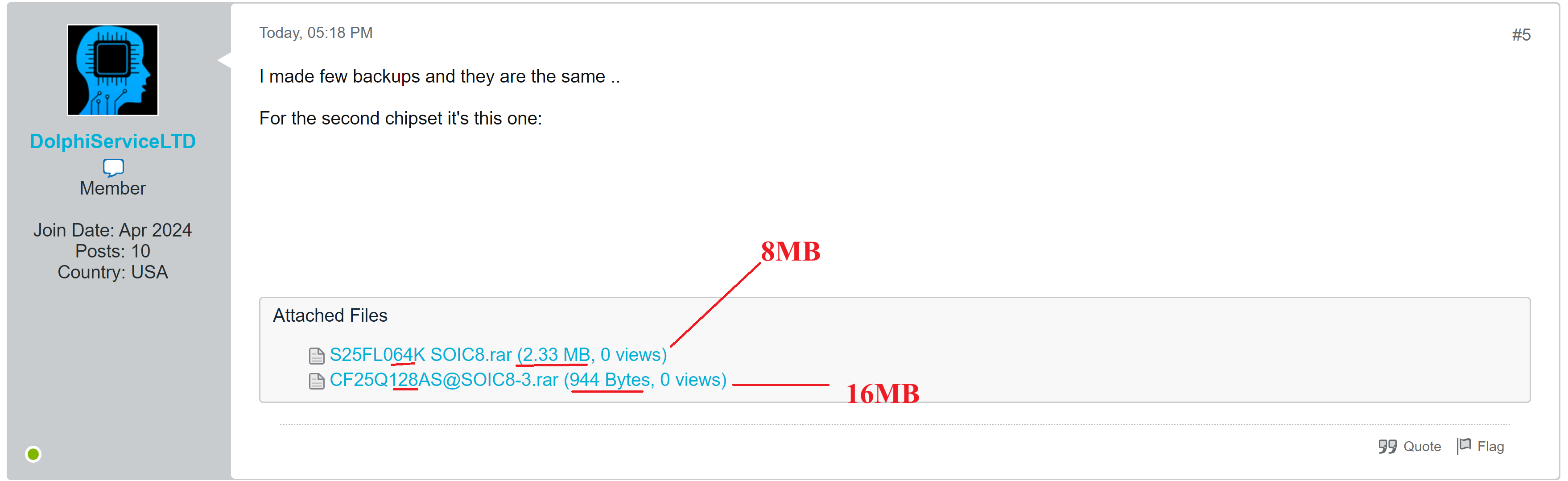

            I made few backups and they are the same ..
            For the second chipset it's this one:
              The 16MB file is still damaged. If you cannot back up this file, we cannot copy the DMI to a new file for you

                your bios region is totally corrupted, it has no volumes. So I can't find DMI and serial and machine type could appear as INVALID. You have bios extracted from update, write both chipsets. After that download and run bios update from Lenovo site (search for serial number to be sure you have the right update) and you have option to write serial and machine type.
                  YOU ARE GOD! Thank you very much!
                  It's working!!!
