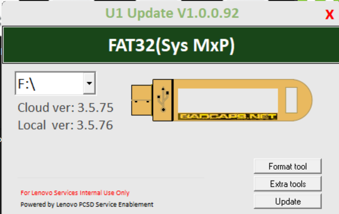

      #42

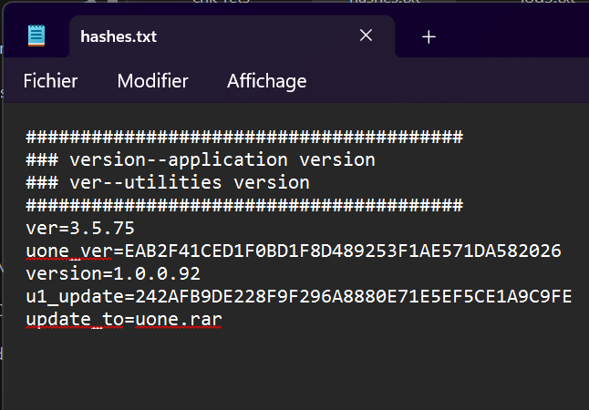

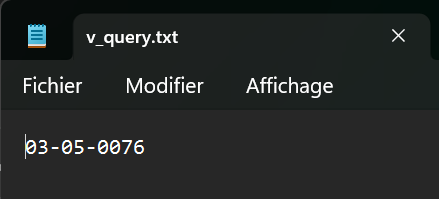

      version 3.5.75 but which is actually the 3.5.76
      downloadable here
      03-05-0076
      https://seservice.lenovo.com/static_...-0076/uone.rar
      With hash SHA-1 | 160-bit : eab2f41ced1f0bd1f8d489253f1ae571da582026
      Previous version of 03-05-0075
      https://seservice.lenovo.com/static_...-0075/uone.rar
      With hash d060859f579d8473b3215ea8332fbec83926e6ca
      The downloadable archives are password protected, I don't yet have a solution to open them directly.
      I use the U1 application to extract the files.
      To download the latest version without having to do all the updates, modify the file " v_query.txt " directly or replace with my file
      Same method as here, just copy new update
      https://www.badcaps.net/forum/troubl...17#post3542717
      For this problem,not solution for the moment

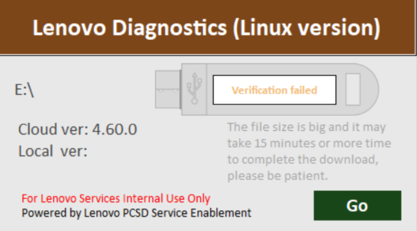

      Not tested, just download
      please give feedback​

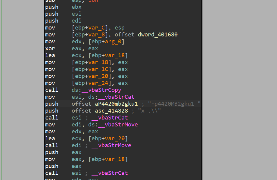

        The password is 4420MB2gku1

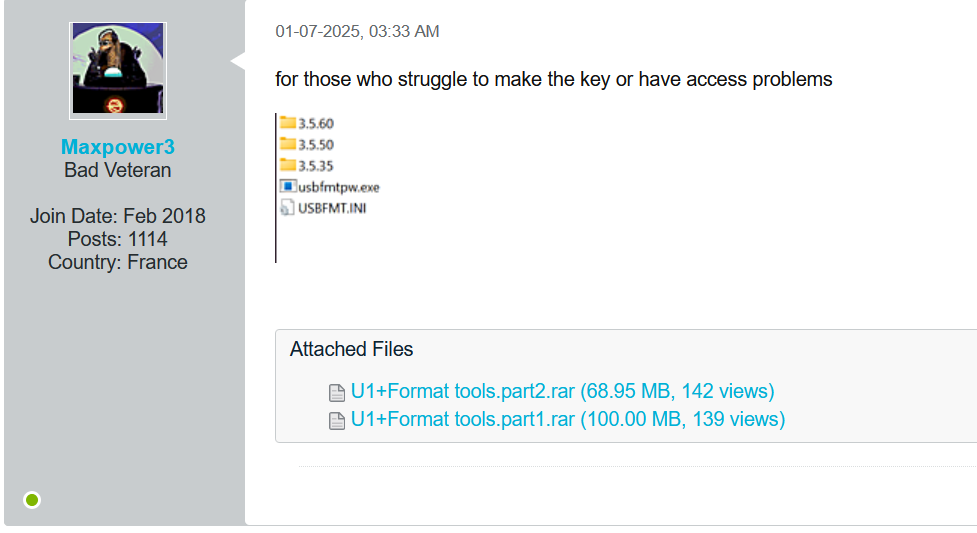

        • Maxpower3
          Bad Veteran
          • Feb 2018
          • 1316
          • France
          #44
          Click image for larger version  Name:	image.png Views:	0 Size:	61.4 KB ID:	3641412
          I tried with the P and the - too. I suspected that it was there

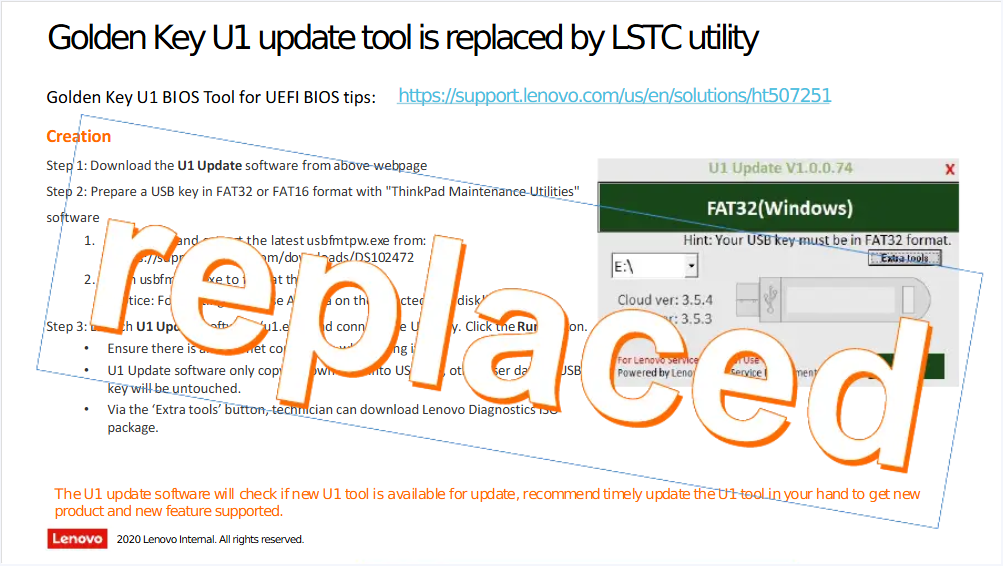

          • SoporteNetFe
            • Aug 2021
            • 121
            • Argentina
            #45
            I think some functions no longer work because the tool has already been replaced.
            The program download the hash of Lenovo Diagnostics ISO, but not the file.

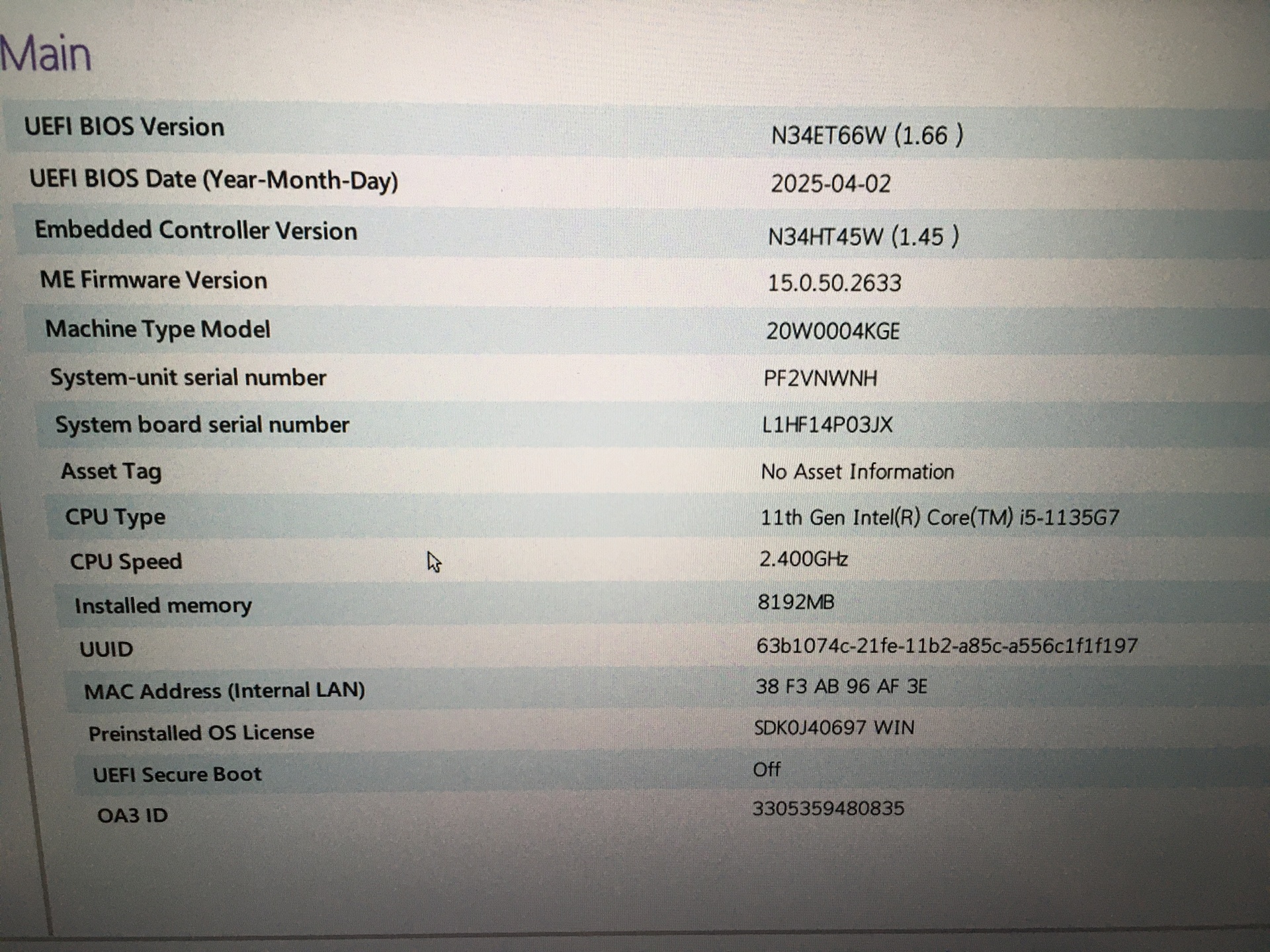

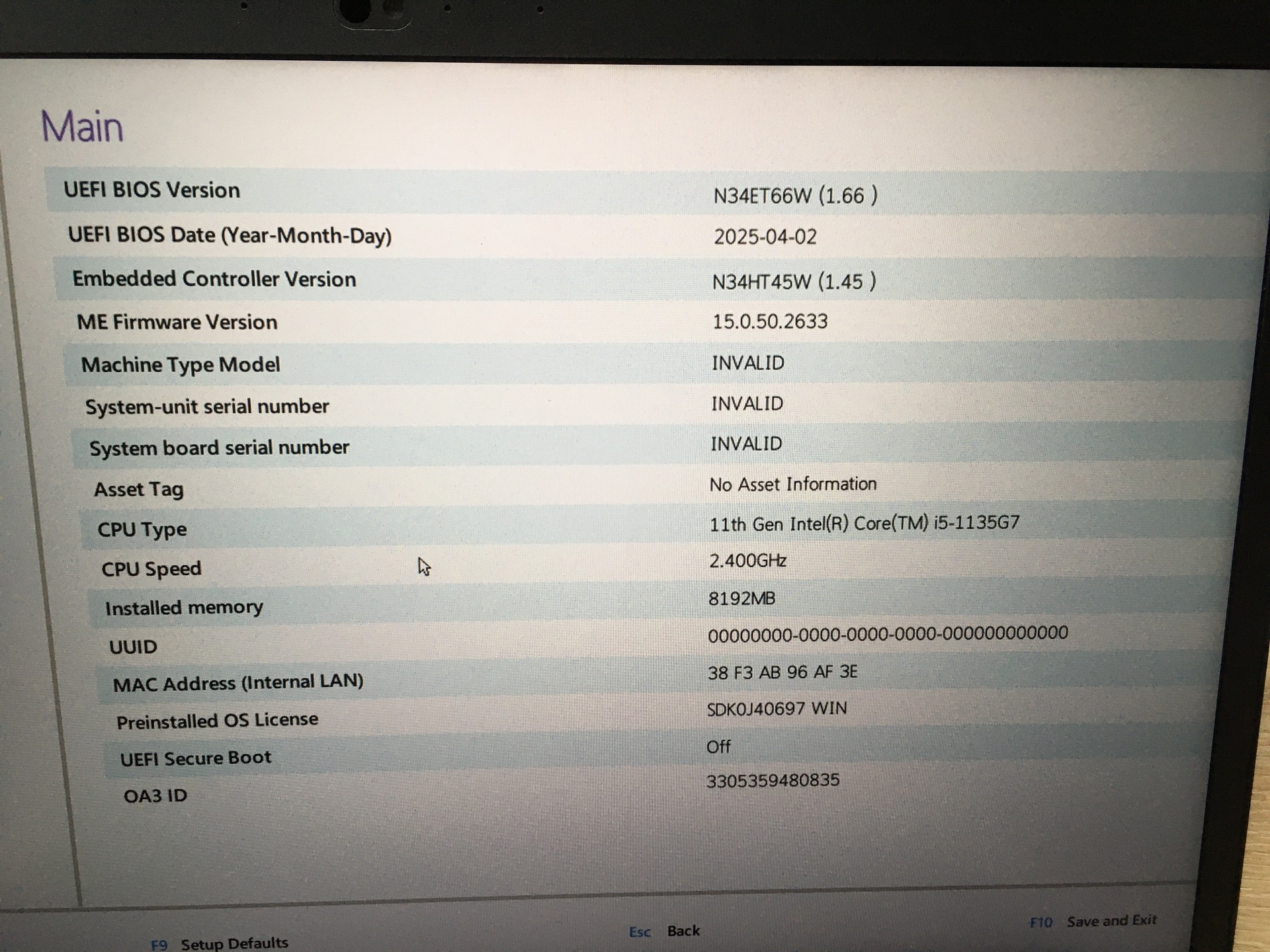

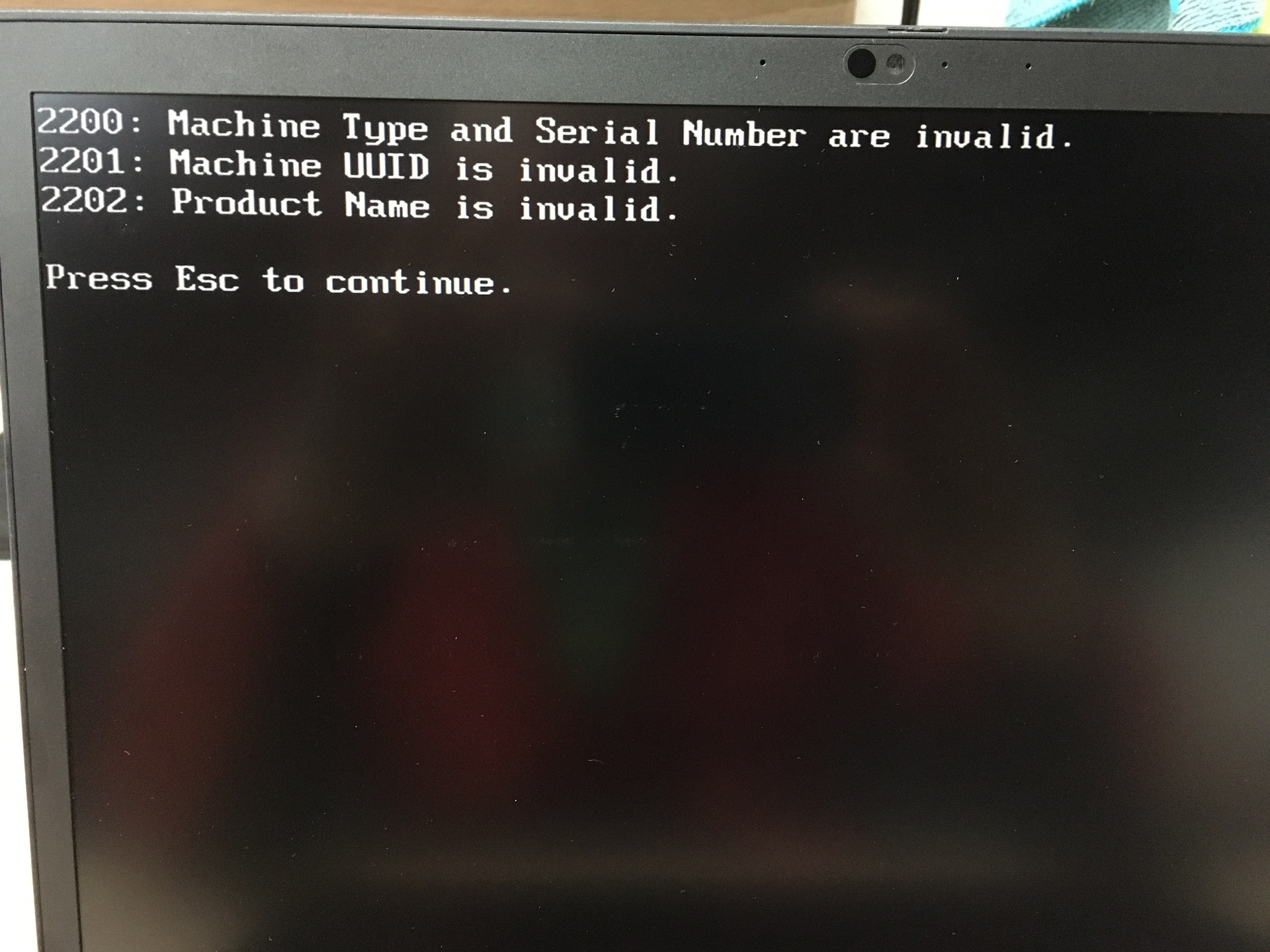

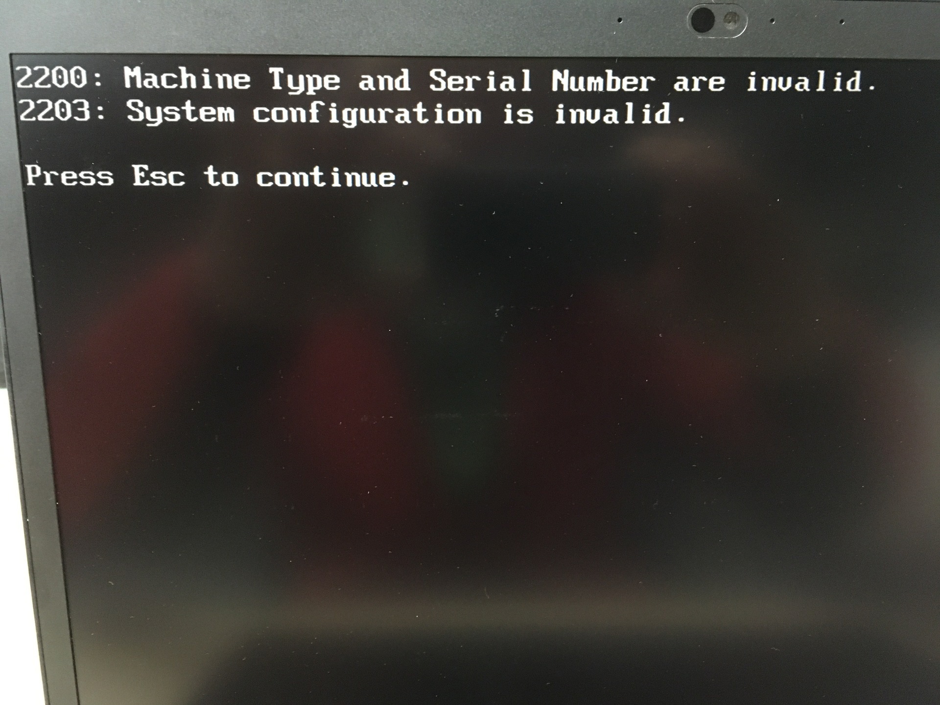

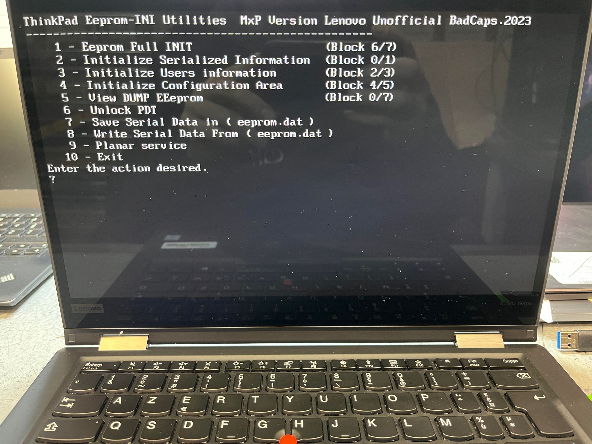

                #47
                Lenovo T14 Gen2
                Serial Number: PF2VNWNH
                Board Number: NM-D351
                Hello a strange behavior by Lenovo Golden Key U1.
                I could easily write the missing data with the tool, but after each restart, the error message 2200 and 2203 appear although all data appear correctly in the BIOS.
                I tried a lot of deleting EEPROM and reentering the data but always errors 2200 and 2203.
                After pressing ESC, the notebook loads as normal very funny behavior.
                Lenovo Tool is U1 Version 3.5.75

                  #48
                  Dear All, good day!
                  All working,
                  Frist : format usb stick to FAT32 UEFI throw cmd command, you can find at Google search - how to make it.
                  Second : After USB formated make update the programm up to last version. Programm will create files on USB stick. Were comleted updates - usb stick is ready. Just what to need reboot throw F12 bootloader and choose USB stick.
                  Enjoy.

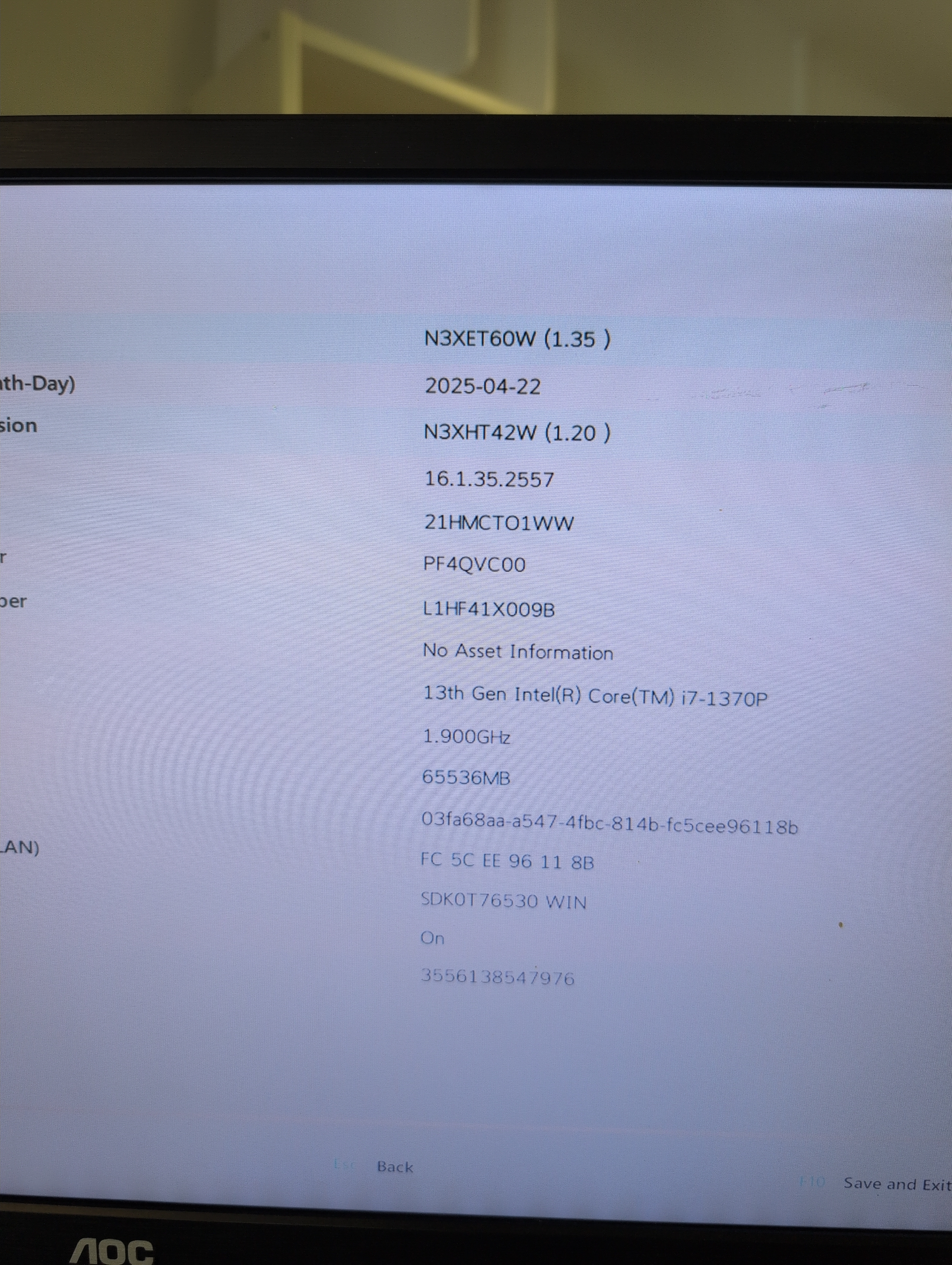

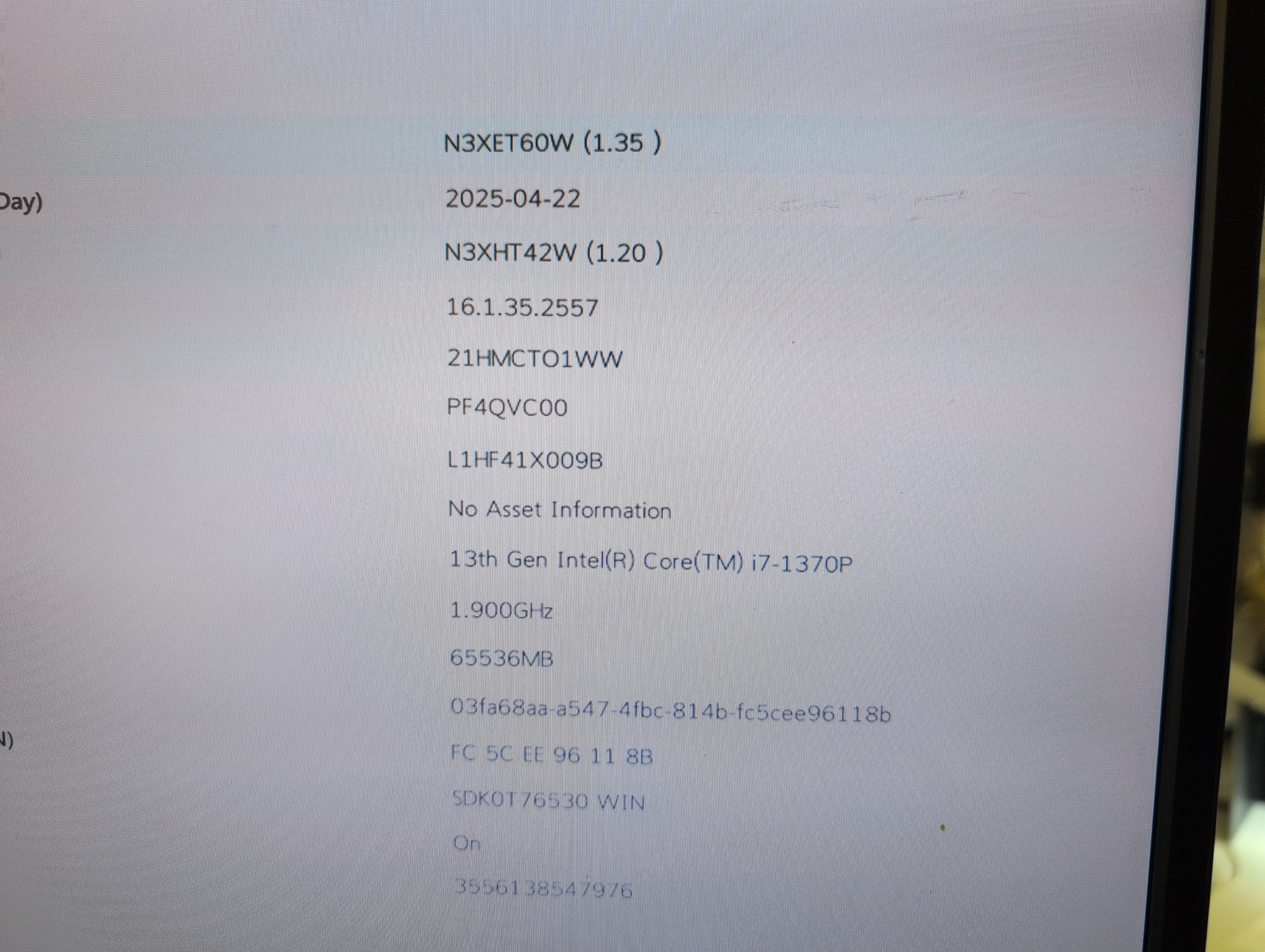

                          #52
                          Guys I Have a Gen 11 X1 Carbon 2023 model I think....the new motherboard from lenovo arrived....I can't seem to set the B0 or C0 ...I managed to set the Mac Lan, I'm trying to.copy the old details from.the old board.

                            As Maxpower3 explained clearly on post #43 all worksa fine. I share some some tips to considered so the process will be end successufully.
                            - use the format USB tool provided on post #43, no matter to choose FAT 16 or FAT 32 and don't worry if at the end of process it will say that EFI information are missed.
                            - copy the 3.56.75 into the root of USB inside this archive there is also the EFI folder.
                            - extract U1 Key updater.zip of post #1 and overwirte the v_query.txt with the one of post #43
                            - next (keeping usb attached) run U1.exe press Update to update the tool on usb key to last version. (actually 3.56.78)
                            To use it on laptop that requires MDM infoe follow this suggestions.
                            - first of all I suggest to update BIOS via software no matter if it will be the same version you have programmed on chip.
                            This is usefull expecailly when U1 Tool show an ERROR 53 TRIGGER while writing DMD infos and doesn't works.
                            - I suggest to remove hard disk so the laptop will ask you to choose or insert a bootable media
                            - as you can read on the first screen use the command SUone.nsh so it will asks all MDM infos and next it will write on BIOS
                            - I M P O R T A N T along the writing process it will looop several times and its possibile that some infos shows "not found" at first. Let it loop and don't interrupt process and wait that the program will wrtie all fields.

                              #54
                              Name 3.56.78 but which is actually 79
