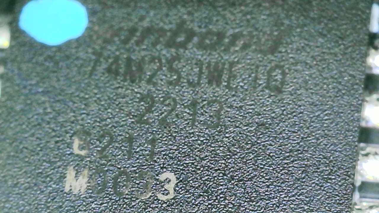

            • badcapjerboard
              • Apr 2023
              • 68
              Badcaps won't let me attach the file I saved from the chip. It's only 2MB. When I try to open the file you guys attached here with my ch341A app it says file length too long and ignores.
              I guess CH341 doesn't support it? It only shows two WQ16 chips seemingly up to 16MB while mine is 32MB.
              winbond 25q16jwn10 2214

                Can anyone tell me which programmer will support this chip?
                • peste
                  • Dec 2016
                  • 13258
                  • ROMANIA
                  look for another chip on the motherboard, which has 32MB, try this.. if it doesn't work, try a similar chip from the database..
                  https://www.badcaps.net/forum/showpo...6&postcount=10
                  https://www.badcaps.net/forum/showpo...04&postcount=7

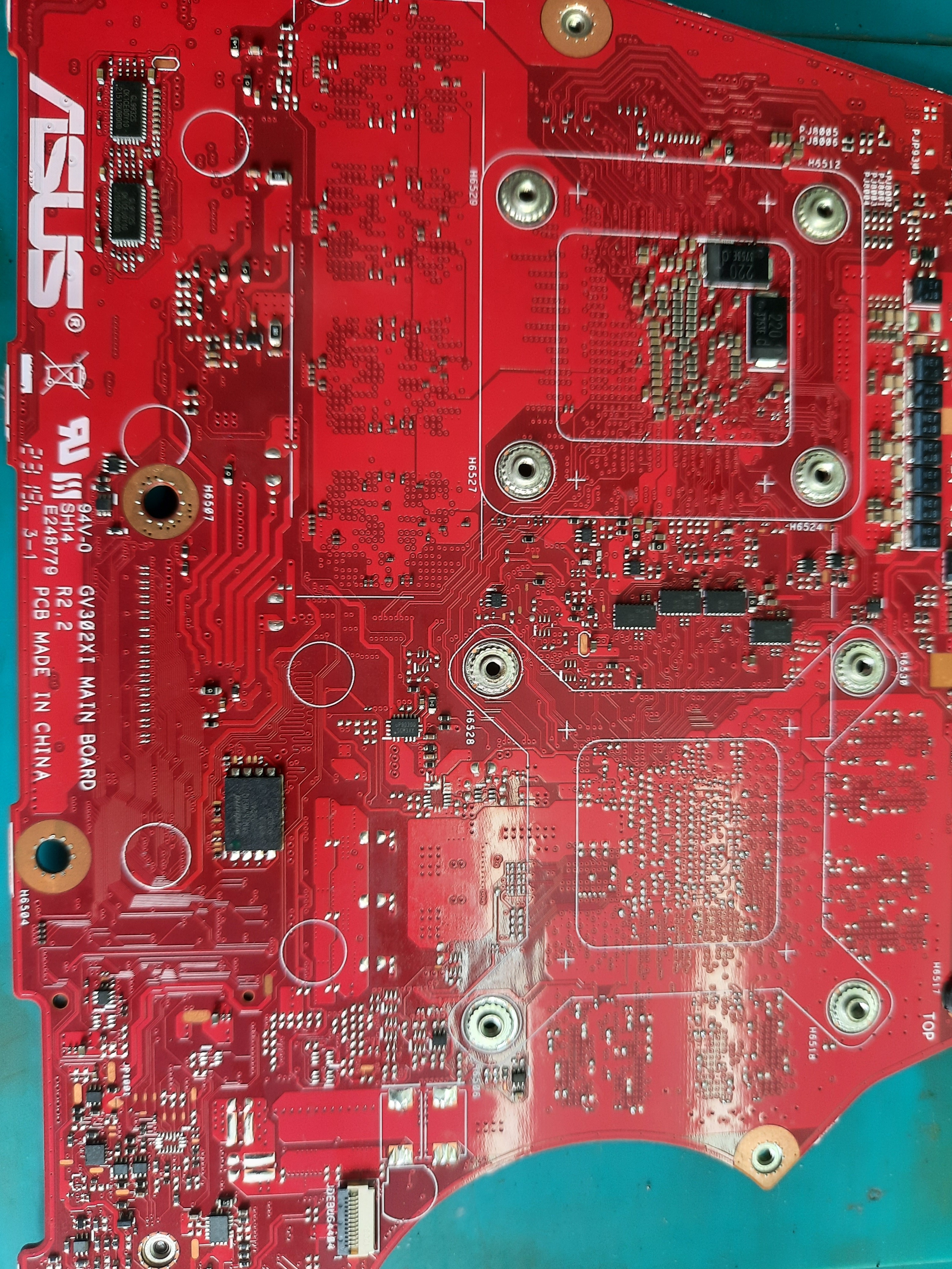

                      There's another winbond, bios looking chip, but google seems to say it's 256mb. Not finding.
                      • Gcs_rma
                        Banned
                        • Dec 2023
                        • 108
                        • N/A
                        here
                        Click image for larger version  Name:	2024-02-27_235441.png Views:	0 Size:	457.0 KB ID:	3224543
                        • badcapjerboard
                          • Apr 2023
                          • 68
                          Yes exactly, but the bin file everyone has is 32mb so don't i need a 32mb chip?
                          Can i have that boardview file?
                        • Gcs_rma
                          Banned
                          • Dec 2023
                          • 108
                          • N/A
                          Boardview not support.
