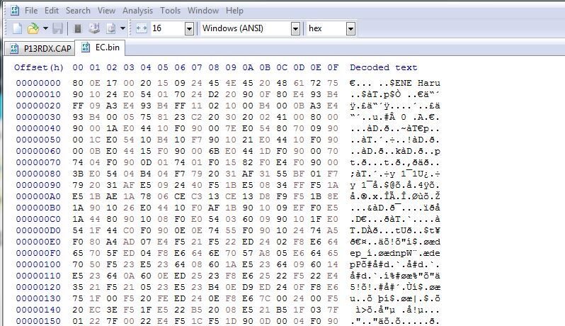

    Hello everybody! I need the Bios EC of the Samsung NP500r5M-XN2BR - S/N:07ZU9QAJ700737H - Ba41 Board 02543A. My EC burned out and I'm replacing it. If anyone can help me, I'd appreciate it.

    Post your bios backup.

      My EC is damaged, installing new KB9028Q-C. I don't have a backup

        I asked you to post your BIOS backup ,not the EC,i know your EC is/was damaged. The EC file can be extracted from your BIOS. The EC can be extracted from the bios update as well - https://www.badcaps.net/forum/troubl...update?t=88206

          SMDFlea, Oops, I didn't imagine, I'm sorry.
          I will provide​

            Follow the Bios of the NP500R5M. I appreciate your help

              SMDFlea, Could you help me verify this EC that I captured from the Bios file? It was my first time, I hope this is correct.

                Verified, well done,great job

                  SMFlea, your tip was of great value! I installed the Bios and everything was ok.
                  I thank you and everyone here who helps so many. Much gratitude.
