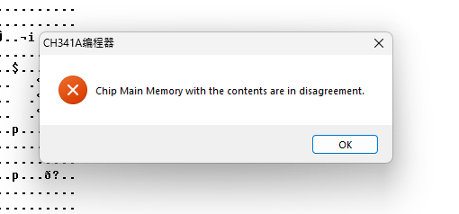

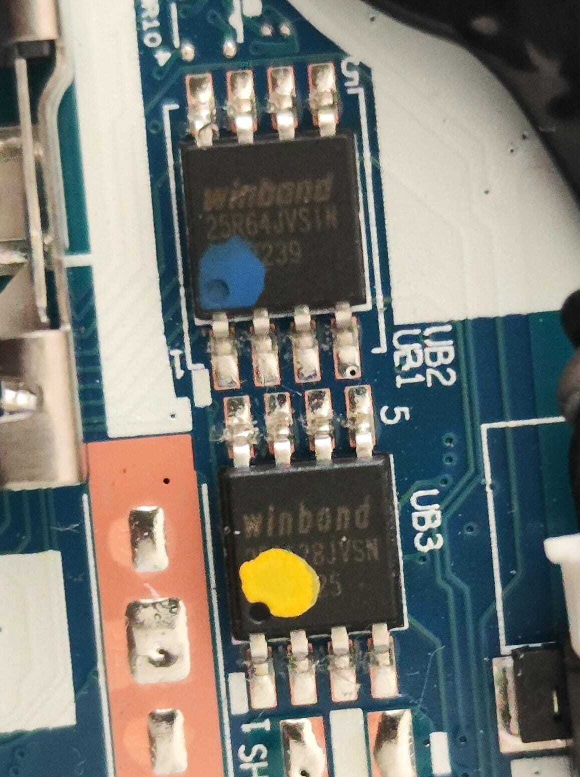

              Hello, I have the Lenovo Ideapad 1 15IAU7 82VY000TBR with no post, the power light keeps blinking and after a while fan turns off
              The bios chip are Winbound 25R64JVSIN and 25R128JVSN (not 25Q wich are found on the program).
              I have tryed all bios above and they did not work for me, any solution or bios that I can try? Thank you

                  Hi, there is my bios saved before trying to re-program and photo of the chip. Is that the dump?
                  Thank you very much every help will be very apreciated

                          Still the same blinking light and no post or video.
                          Maybe the 128 chip is bad and need replace? I get this message on CH341A programmer 1.29 when try to verify
                            Replace chip or programmer.
                              I will buy another chip because the 64 bios works and verifys sucessfully, only the 128 get error.
                              I will donate for badcaps if this solution works and I get able to use my notebook again! Thank you very much!
