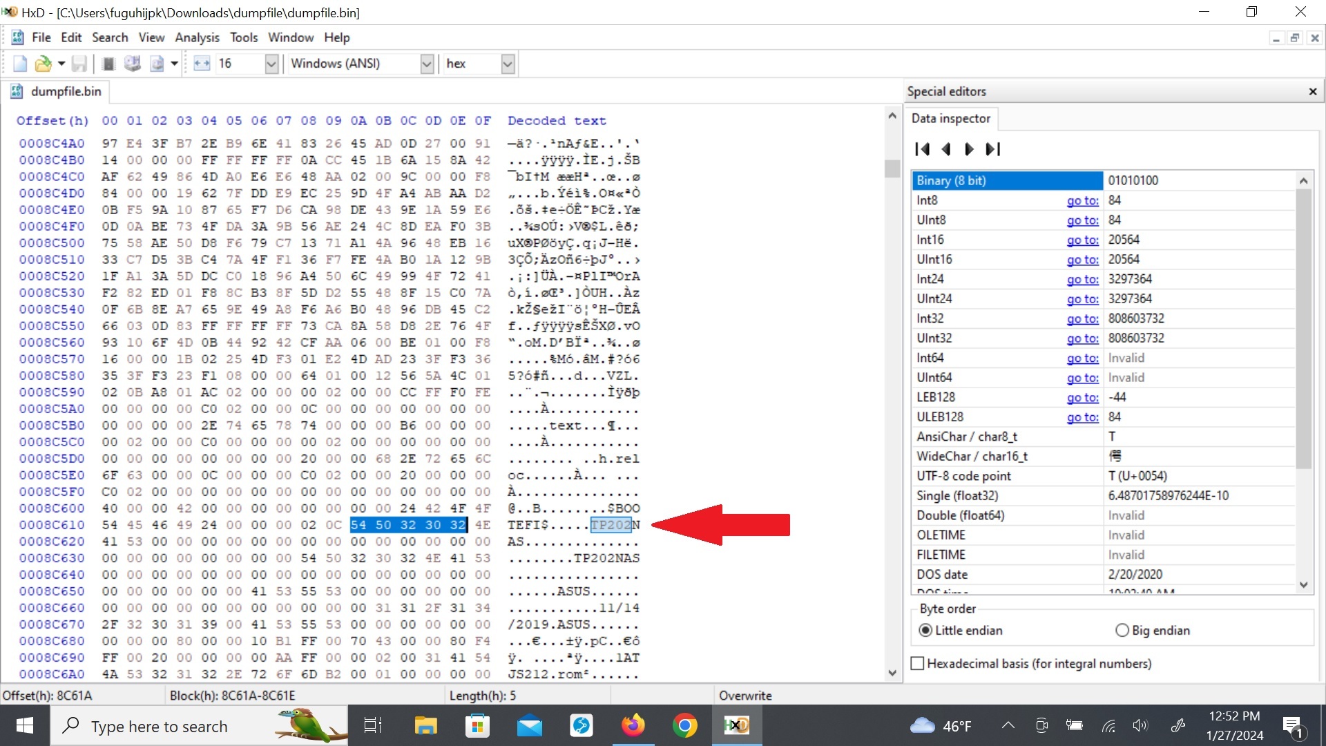

    I've read the tutorial here on using the HEX editor to find the region where the DMI data starts, but I couldn't find the serial number anywhere in the BIOS dump. I also tried opening the dump file with FD44Editor, and I got an error message stating "Error parsing BIOS data. FD44 module not found." I'm wondering if I did something wrong or if this file just isn't supported by any of these methods. I was able to get the laptop working with a modified BIOS file from the ASUS website, but I'm unable to do anything with the corrupt dump file.
    Model number: TP202NA-OS21T
    Serial number: K6N0GR07X2725B
    Board number: TP202NAS

    I followed the tutorial below, but I'm stuck because I can't find the serial number anywhere in the file. I only see where the BIOS version is listed. According to the tutorial, the serial number should be close by. Is the serial number in the dump file encrypted or did I just get a bad readout?

        It's working, but it doesn't have the original serial number. The serial number shows up as SSN1234567890123456
        Also, I wasn't able to disable secure boot in BIOS

          i have same problem, after update bios from windows update black screen.
          Can a help me, modified bios dump.
          ASUS TP202N
          TP202NA_MB REV. V31_1121A
          sn: K1N0GR02N97302C
          bios ic 25LB64CWIG

            serial number?

              serial number?
              sn: K1N0GR02N97302C

                TP202NA

                  all is ok... big thanks
