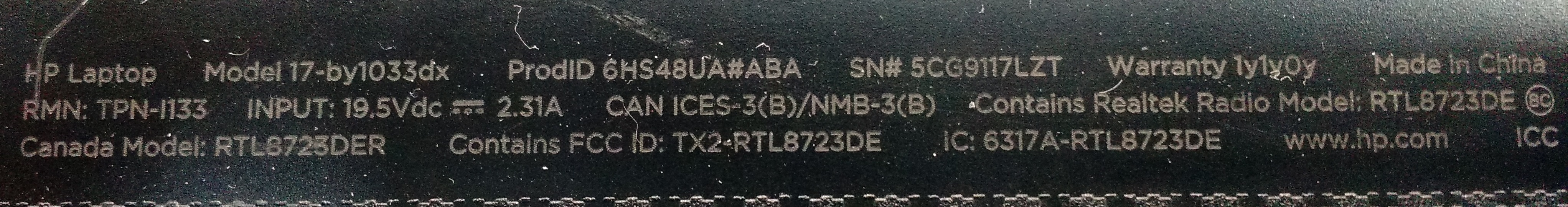

    hi
    i need bios dump for 6050a3168901-mb-a02(A2) 6L
    my old bios dump has the mouse not working.
    bios hp 17-by1033dx
    snape01- 6050a3168901-mb-a02
    sn 5cg9117lzt
    thanks a lot

    • Vesko356
      VIP Moderator
      • Aug 2018
      • 4386
      • Bulgaria 🇧🇬
      Originally posted by alirafee
      not working
      no power
      What did you expect, didn't you read my comment?
      About your issue - I don't think the touchpad isn't working because of a bios problem, also there is a mismatch between the model you gave in the description and the one in the dump you uploaded (17-by1xxx vs. 17-by3xxx). Also there is a serial number mismatch. Maybe the back cover was changed or someone before you flashed an incorrect bios.
      Here is a virgin bios (same F.09 Rev.A) matching the model and type with the bios backup from your first post, both DMI and Windows Key are transferred:
