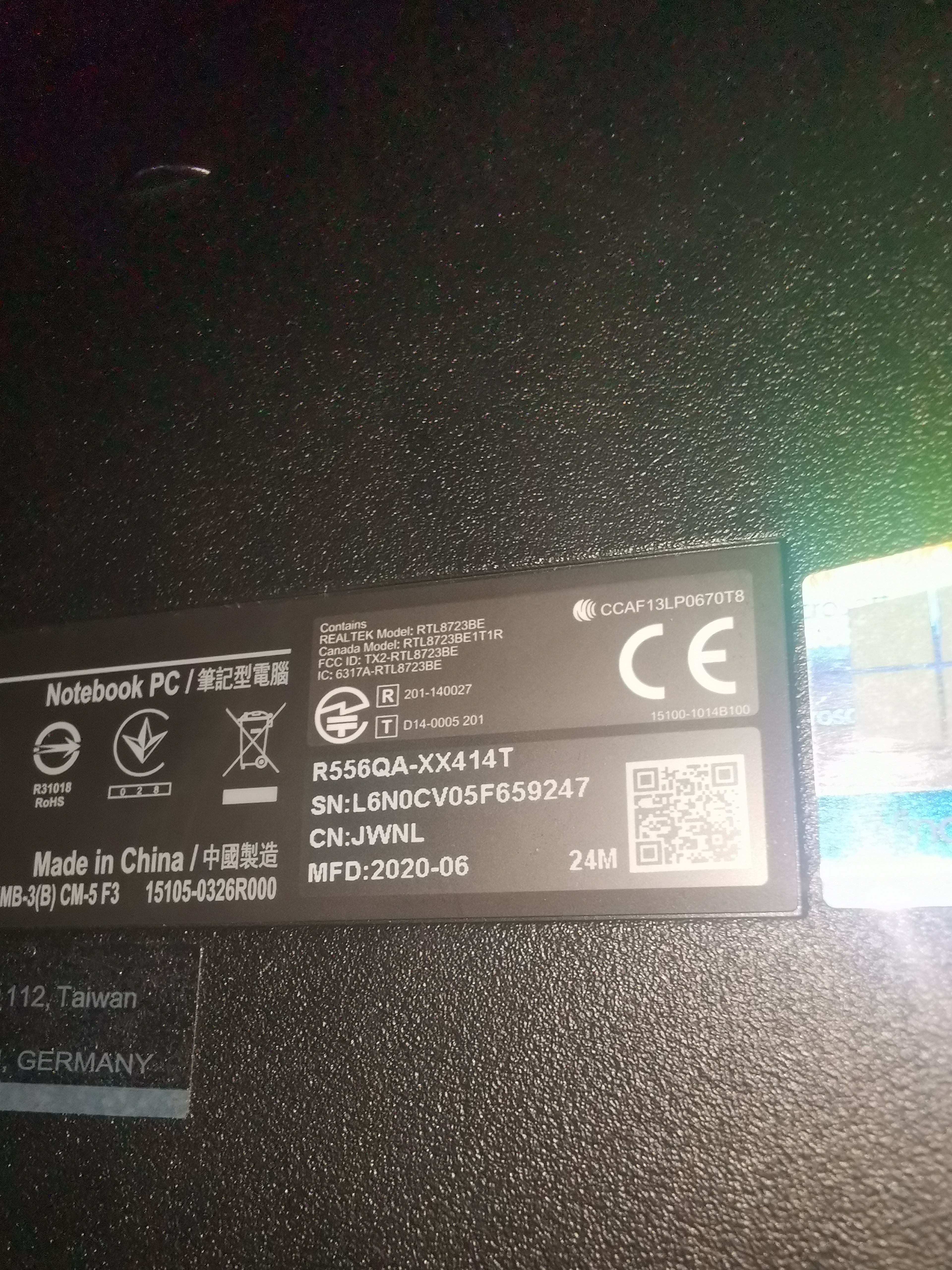

    Hello everyone
    Please can someone help me I can't find the bios for this model
    Asus x555qa
    Mb x555qg Rev 2.0
    Cpu AMD a10
    I try a lot of file,, doesn't work
    Chip is 25q64fw. 1.8v
    Just black screen
    ORIGINAL DUMP

    POST SERIAL NUMBER/SERVICE TAG:-
    • omaryou
      • Aug 2017
      • 84
      • mexico
      where i can find sn ??,
        SMDFlea commented
        Editing a comment
        On the base cover
    • omaryou
      • Aug 2017
      • 84
      • mexico
      SN / L6N0CV05F659247
      CN / JWNL
        CN / JWNL
        try
            NO VEDIO 😢 THE SAME THING
            it means you have a hardware problem, bios was extracted from latest bios update and inserted your DMI.

              That's right, I can confirm that too - it's a latest version 329 from the Asus support , so IF the chip was programmed properly and there's no change means the issue is not bios related.

            when I touch the CPU I I feel so hot

              can we disable ram on board ?
                Hello everyone
                Asus x555qa
                Mb x555qg Rev 2.0
                Cpu AMD a10
                Just black screen
                ORIGINAL DUMP
                I work your original file , and disable ram onboard, try ths file and comment me if you work ...
