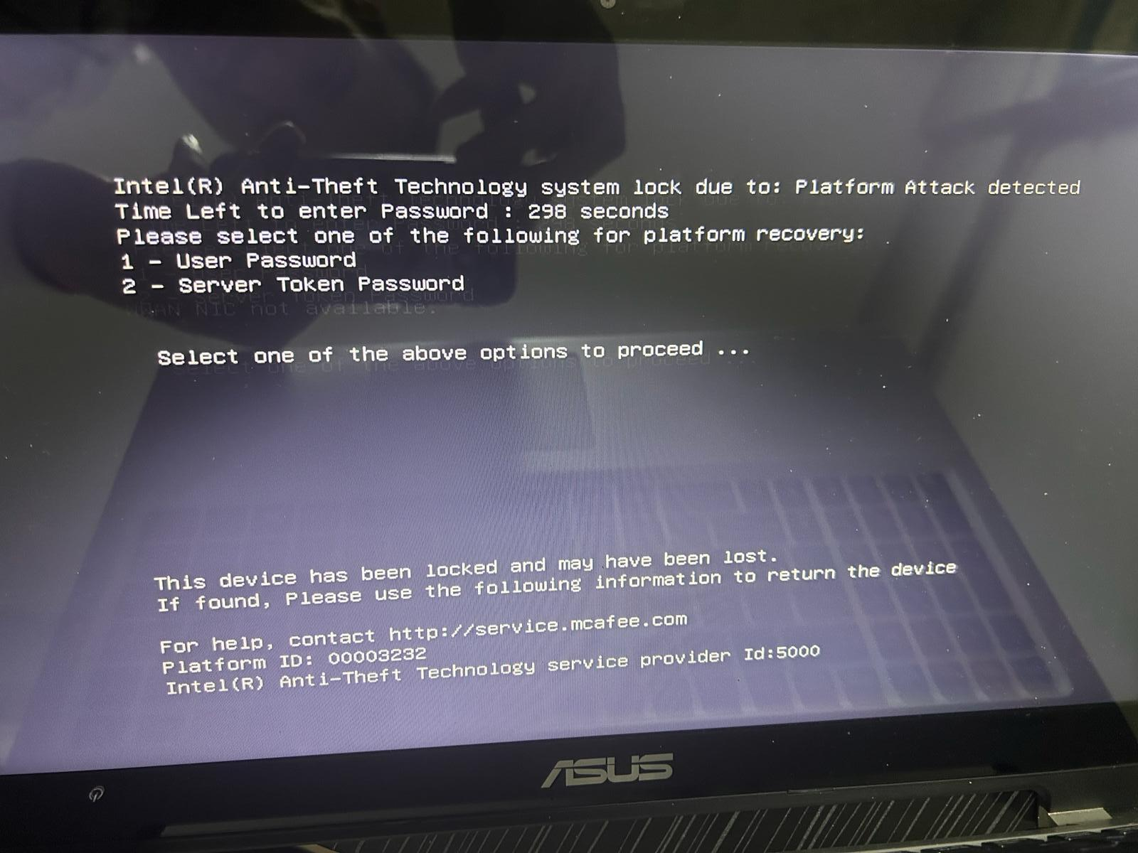

    hello, I have installed the original bios, how do I see the password in this, the computer wants a bios password at startup, or can you give the deleted version of the bios password?"https://www.asus.com/tr/supportonly/s550cm/helpdesk_bios /" i downloaded it, I dialed a thousand, but the image didn't come, I downloaded it with a serial number
    Laptop Asus s550cm-cj026h
    Serial Number :CCN0AS36389651F

    try
    • ramadanemrullah
      • Aug 2023
      • 16
      • Türkiye
      No, it asks for the password again and we do not know these passwords. It asks as soon as you press the computer power-on button.

        that's NOT bios password! is asking for USER pass or server pass - both linked by a mcafee account.

      I need to clear the Intel Anti-Theft System Lock mcafee was not installed, I have installed it before, but I don't remember anything, can you help me with this?

          I THINK THIS BLOCKED SCREEN IS FOR TPM in motherboard and not for bios.

            try this bios without DMI - I think Intel anti-theft is linked with serial.
              it didn't disappear, it's coming to the same screen again automatically

                the original bios I uploaded what I shared with you has not improved again
