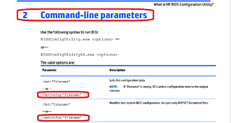

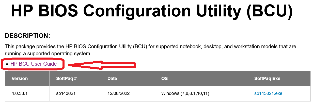

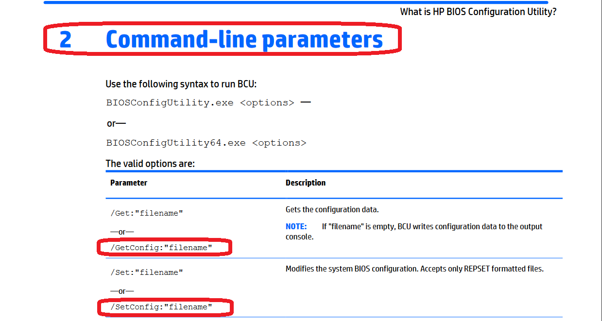

            There's no need to search anything about how to use the program, there is a user manual link at the same page (with command line parameters and syntax).
            Click image for larger version  Name:	Screenshot 2024-01-07 at 20-47-14 HP BIOS Configuration Utility HP Client Management Solutions.png Views:	0 Size:	18.7 KB ID:	3174477
            Click image for larger version  Name:	Screenshot 2024-01-07 at 20-48-59 BIOS_Configuration_Utility_User_Guide.pdf.png Views:	0 Size:	53.1 KB ID:	3174478
            About the DMI location, there's a different approach for every make and model, for example in your case searching for the serial number with the hex editor points the DMI area easily.
