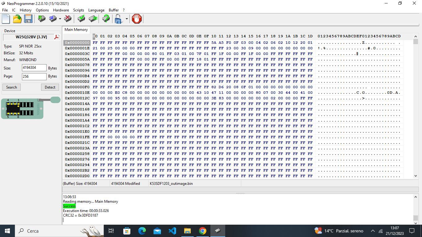

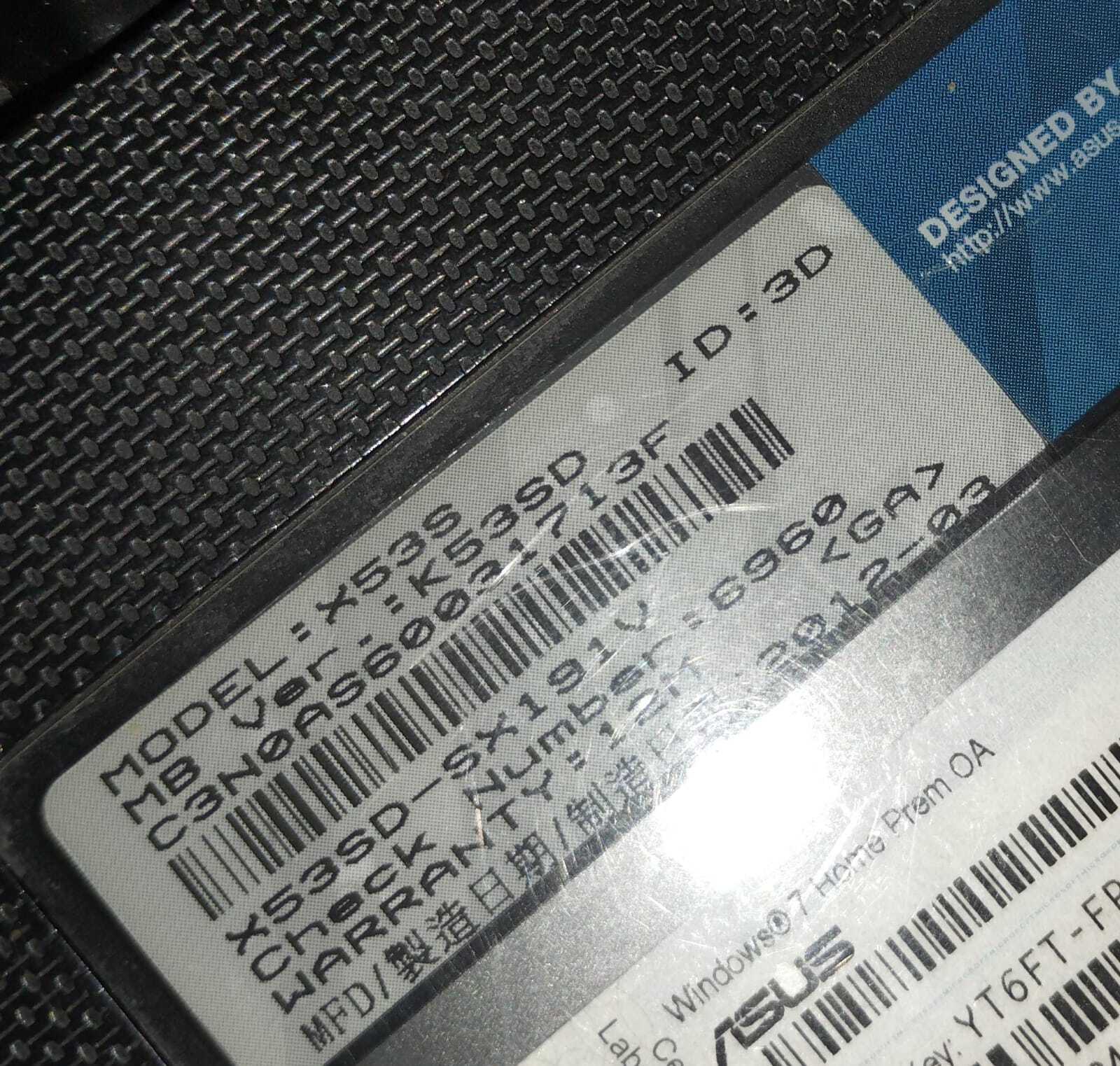

      i dont have the original bios of the pc, i took dump (copy) on this forum
      MODEL :X53S
      MB VER:K53SD ID3D
      C3N0AS60031713F
      X53SD -X191V
      CHECK NUMBER :6960
      CHIP WINDBOND 25Q32BVSIG1150
      PROGRAM NEOPROGRAMMER - CH341A V2.2.0.10

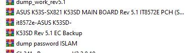

            i don't have the original bios file of this computer, do you know where can i get it? I have the one from this forum but it doesn't work
            • Lisa Su
              Badcaps
              • Apr 2021
              • 216
              • Taiwan
              F1 Engineering BIOS
              • CICCIVALENTI
                • Dec 2023
                • 15
                • italia
                Originally posted by Lisa Su
                F1 Engineering BIOS
                Unfortunately it doesn't work,its's stuck on Asus screen . i don't know what to do, thanks anyway for the reply

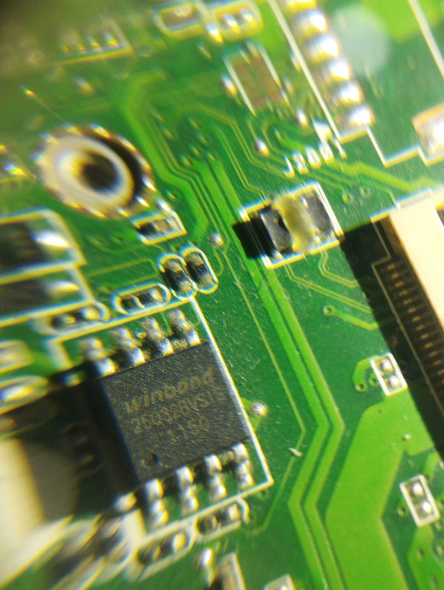

                        I'm starting to think that it's no longer a Bios problem, but I can't understand what it is... are we sure that that chip in the photo is the bios? or I don't know if there is a second bios chip?
                        Thanks for the reply
                        Yep, this is a bios chip.

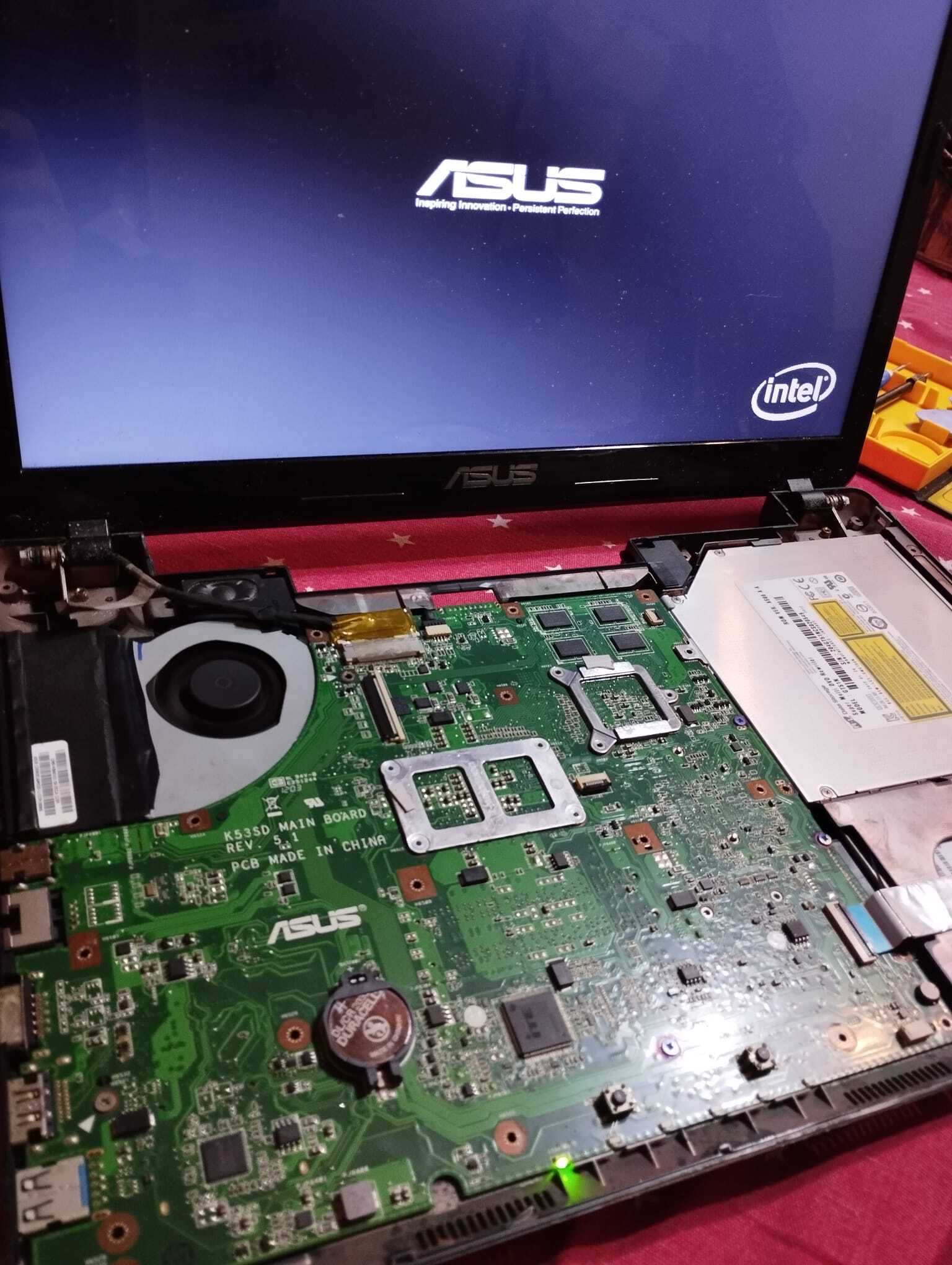

                        noticed something, the highlighted part when touching it is very hot immediately, do you think this is normal?

                        • ash91
                          • Jun 2023
                          • 34
                          • SAUDI
                          Well my friend just do this steps
                          1 - remove the main battery and cmos battery if they installed
                          2 - carfuly unplug screen connector on the motherboard and check for any damage or dust on the connector
                          3 - after you check the screen connector replug the screen caple or if you have external monitor try connect it via vga or hdmi and power on the laptop
                          as for the heat in the marked area .. is it from the bottom side of the board maybe pch or graphic card just see what is it and reply

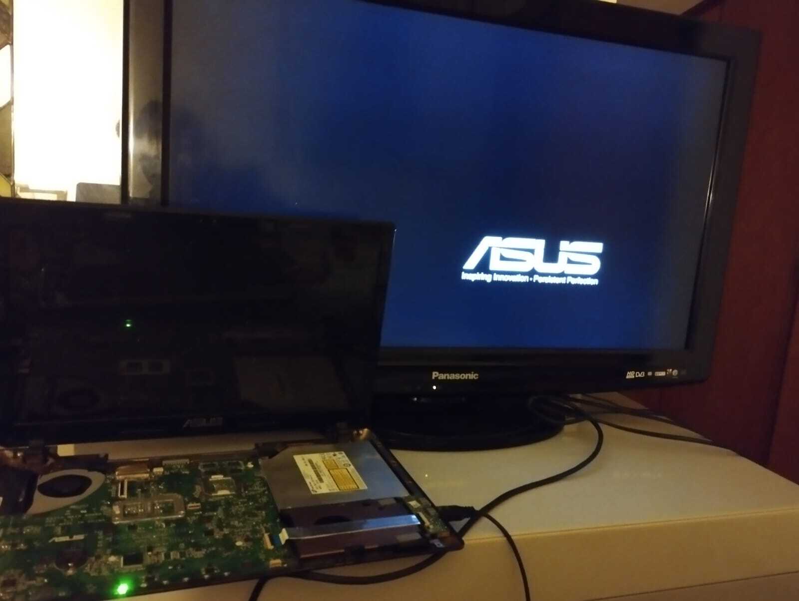

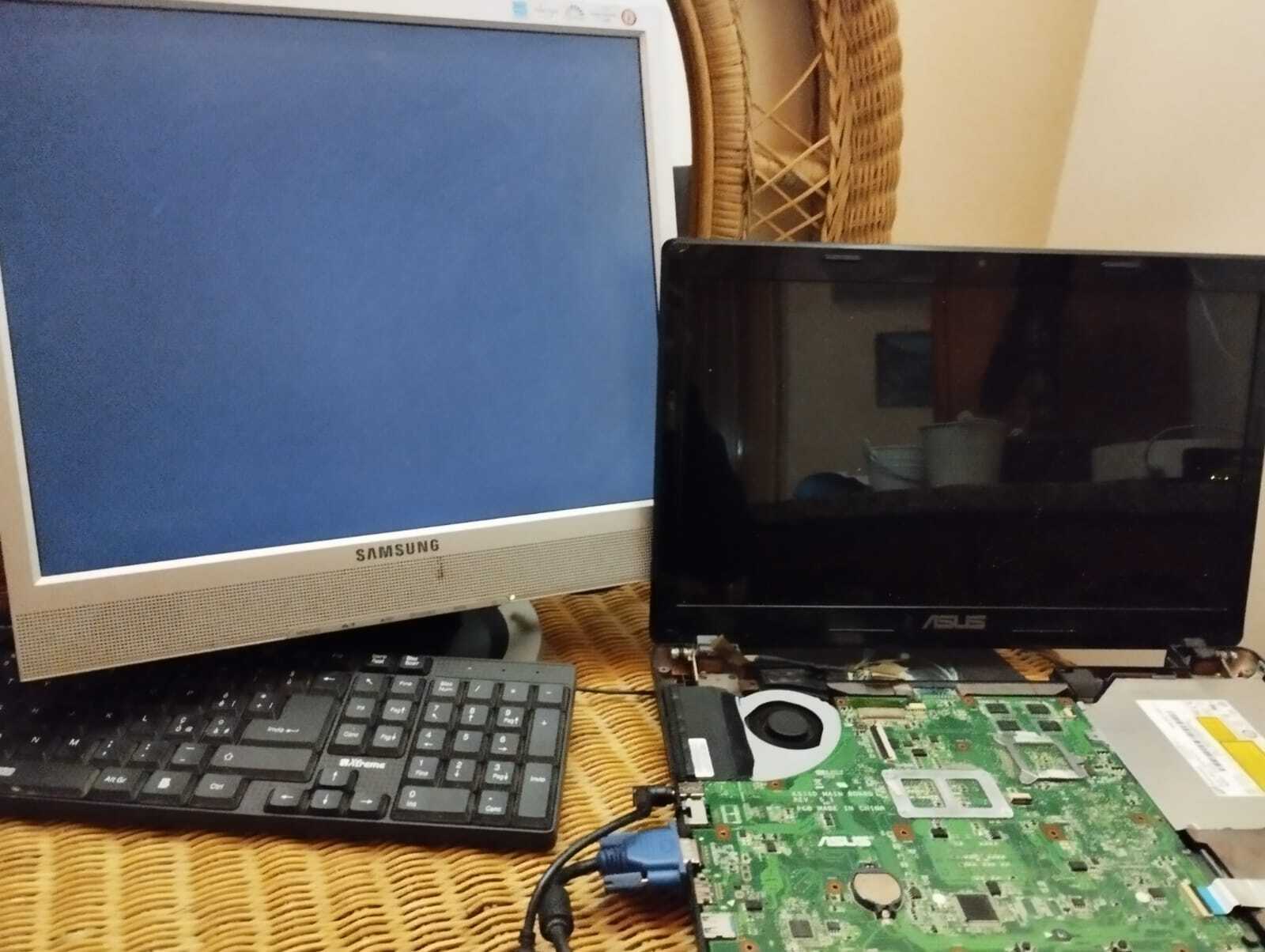

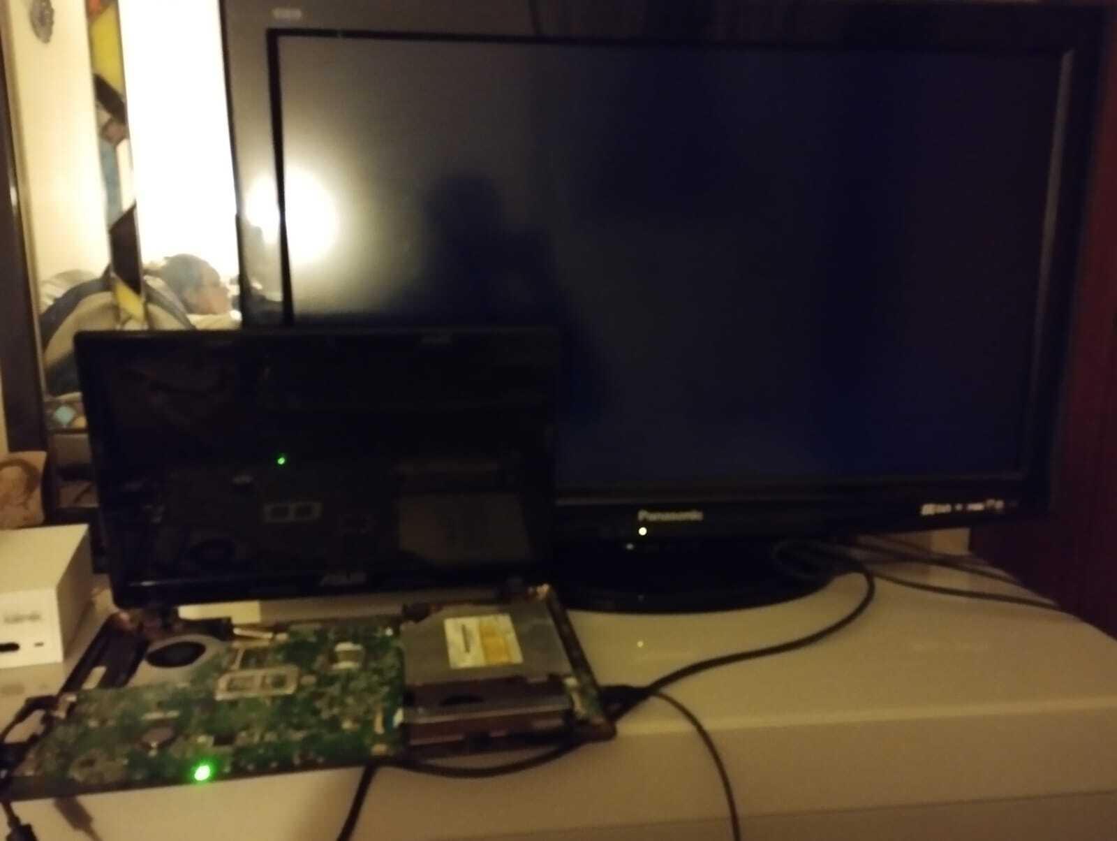

                            1-Yes removed
                            2-removed flat cable, cleaned.
                            3- connected VGA and HDMI
                            VGA without flat cable connected to the LCD result: black screen,
                            VGA with flat LCD cable connected Asus logo screen.
                            HDMI without flat cable connected monitor result: black screen.
                            HDMI with flat cable connected M result: Asus logo.
                            Thank you​

                              What abot the hot spot on the other side of the motherboard is there any change ?
                              is your graphic card integrated or not (nvidia , amd or intel )
                              • CICCIVALENTI
                                • Dec 2023
                                • 15
                                • italia
                                on the other side of the motherboard only USB inputs.
                                NVIDIA GFORCE 610 2GB integrated video card​
                                • ash91
                                  • Jun 2023
                                  • 34
                                  • SAUDI
                                  my friend is seems like a pch or gpu proplem
                                  on the other side of the motherboard (bottom) there are the cpu,pch and gpu chips
                                  the nvidia card is not integrated card
                                  if you have some expirance i sugest to isolate the nvidia gpu first or what it called (dis to uma)
                                  search it on the internet and see the result
                                  • ash91
                                    • Jun 2023
                                    • 34
                                    • SAUDI
                                    forget to sugest removing the hard drive if it attached
                                    and the discreted of the gpu in this asus model done by removing tow coils that are next to gpu ram chips
