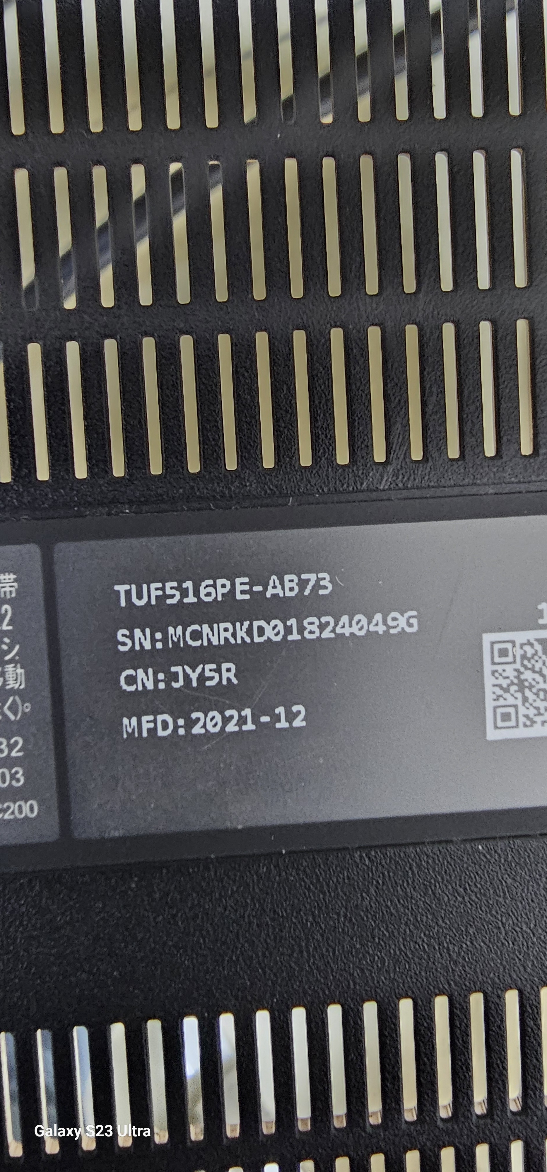

                • jwan4u
                  • Jan 2016
                  • 11
                  • iraq
                  sn:MCNRKD01824049G
                  and old file not work in attachment

                • hoaca388
                  Badcaps
                  • Jan 2022
                  • 12392
                  Originally posted by jwan4u
                  sn:MCNRKD01824049G
                  Backup not ok, reread again.

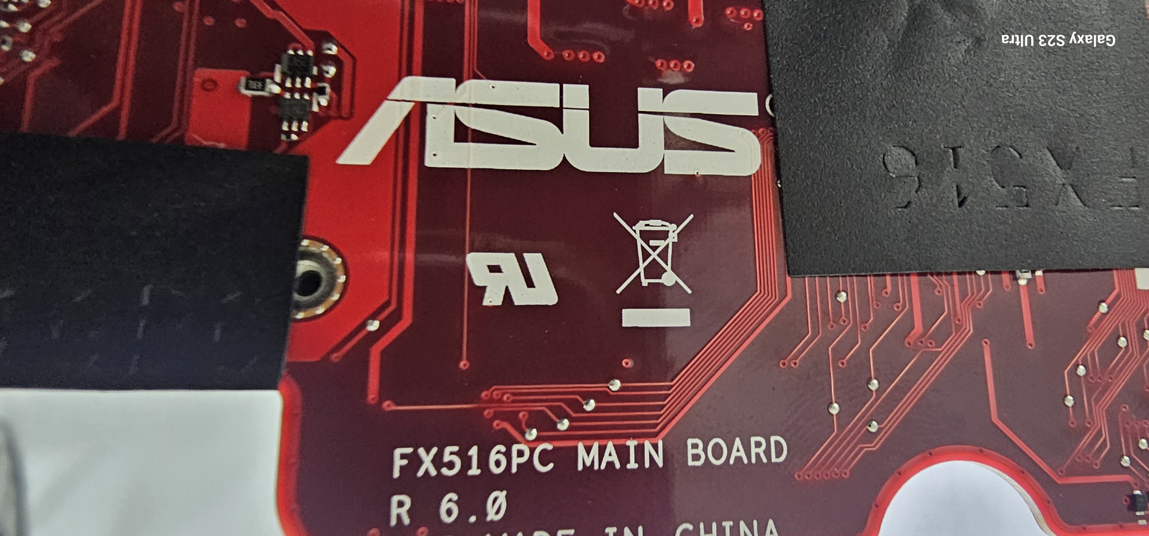

                    sn:MCNRKD01824049G
                    post S/N, full name and model, motherboard model,etc.
                    post the picture here, with a white square (QR code), inscribed on the motherboard ...
                    • jwan4u
                      • Jan 2016
                      • 11
                      • iraq
                      ASUS TUF FX516PC
                      AND THE OLD BIOS IN ATTACHMENT BUT NOT WORK
                      LAPTOP ONLY CHARGE and not work
                      • peste
                        peste commented
                        Editing a comment
                        Don't post pictures unless asked...write with the keyboard..
                    • jwan4u
                      • Jan 2016
                      • 11
                      • iraq
                      This
                        sn:MCNRKD01824049G
                        Your laptop is TUF516PE, uses FX516PE BIOS
                        Try, based on post # 31 from here: https://www.badcaps.net/forum/troubl...64#post3534464
                        DMI added
                        FX516PE
                        S/N MCNRKD01824049G
                        • jwan4u
                          • Jan 2016
                          • 11
                          • iraq
                          thanks work ok
