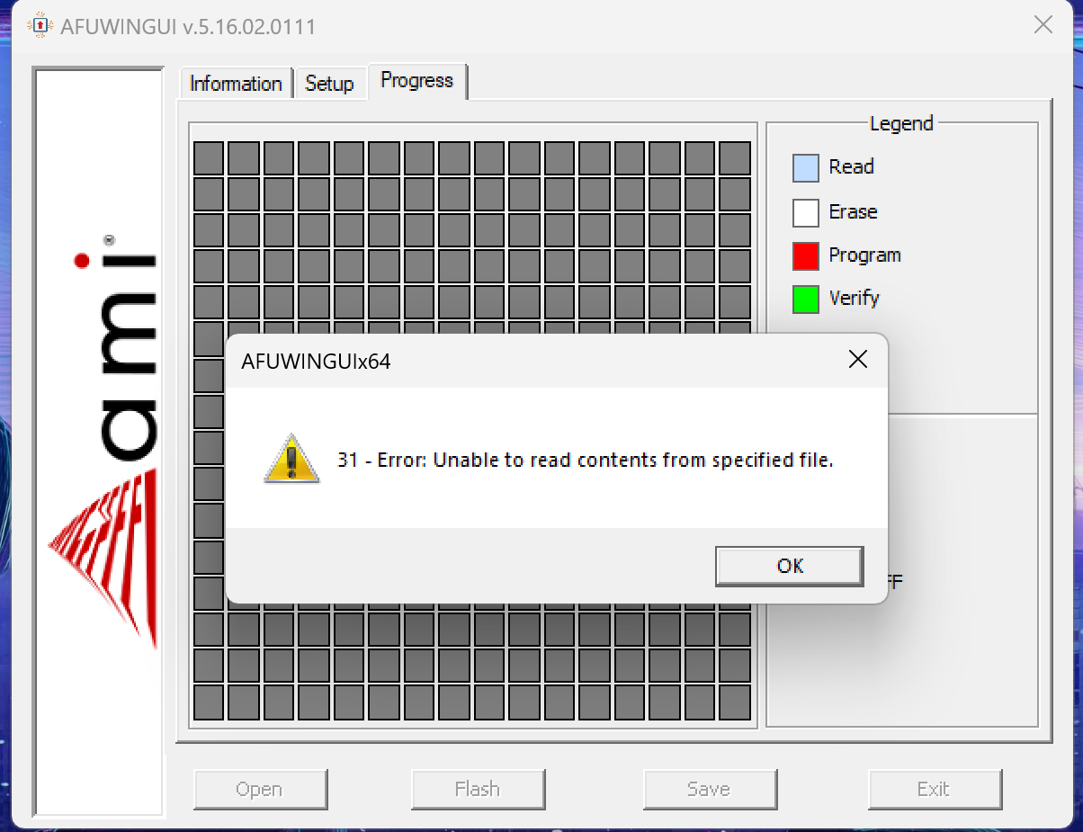

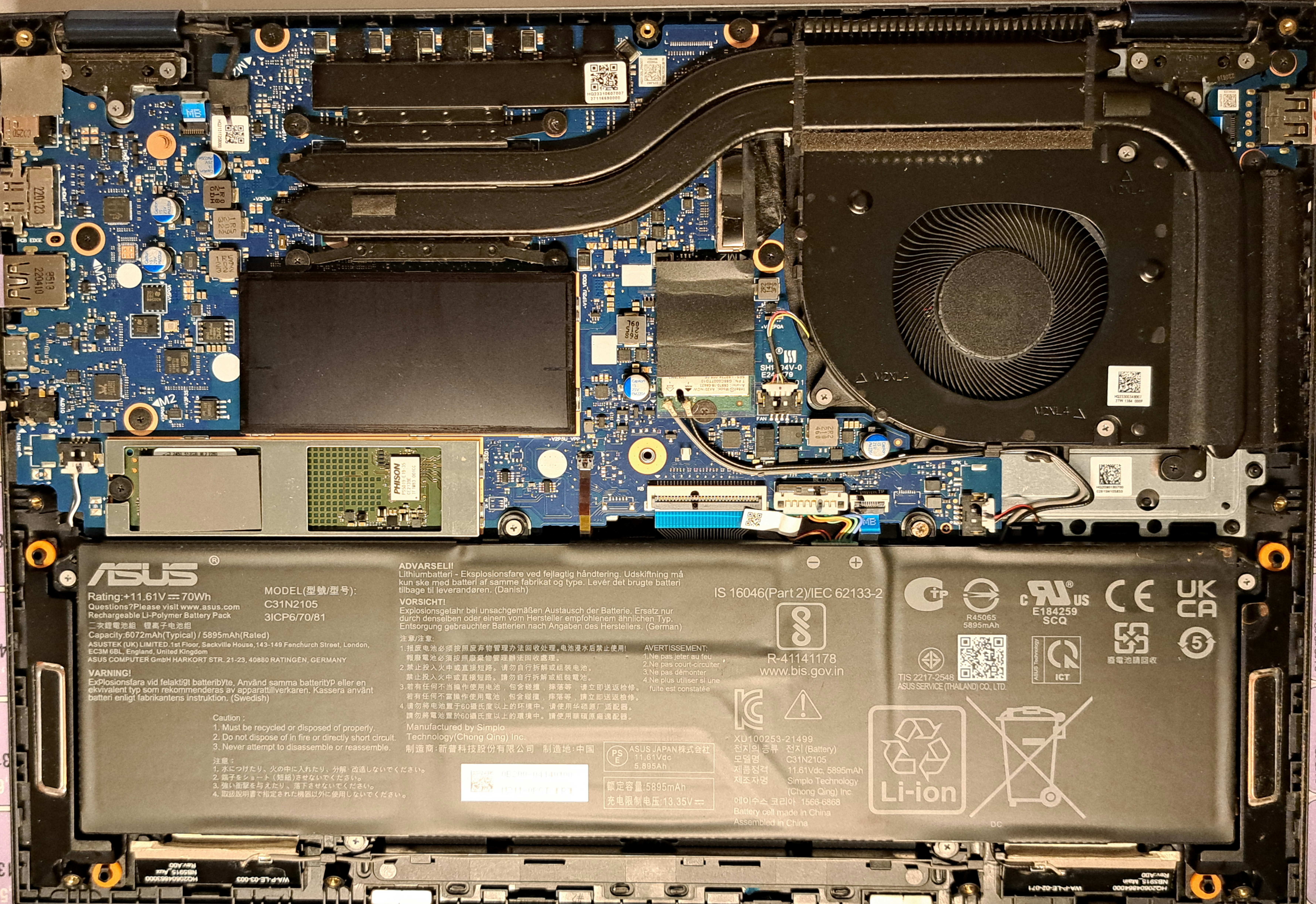

    I'm an owner of an Asus Vivobook S 14 Flip OLED TP3402 laptop (TP3402ZA-KN063WA)
    with serial number: NBN0LP019584459
    and I lost the BIOS password that I set in this laptop one year ago.
    I tried to recover the password using the AMITSESetup method described on the forum. I found that it is possible by software to obtain the BIOS file from my computer (afuwin.rom), but when trying to do so in AFUWINGUIx64 I received the error number 31 "Unable to read contents from specified file" shown in the attachment. I don't have a programmer, hence my request for help if it is possible to do something to decode my password. Or does anyone know how else I can regain access to the BIOS without buying a programmer?
    Thank you in advance for your help.

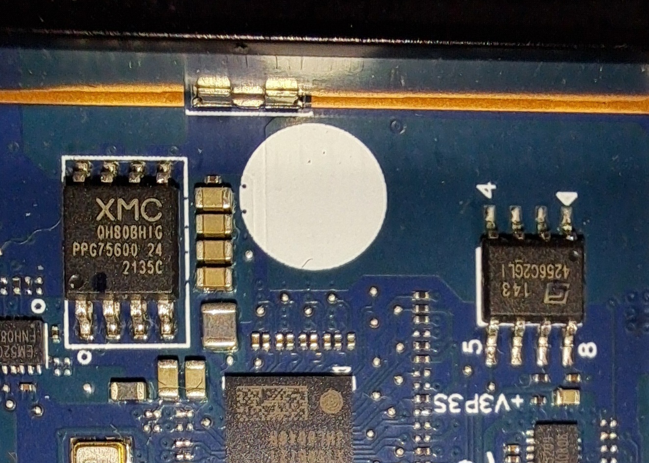

        I got the programmer and software can't identify the chip. I'm using SOIC8 clip and I don't know what's wrong. Which chip is the correct one: XMC or G? Can it be a problem with the clip connection?
        • kalilinux25
          • Mar 2018
          • 2084
          • ZAMBOANGA SIBUGAY
          XM25QH80BHIG try to manual search it inside the spi programmer​
          • Przmx
            • Jun 2024
            • 12
            • Poland
            I was using 1.8V adapter and without it the program automatically managed to identify the chip and save the dump. I don't know if my file is corrupted or the program itself badly reads the chip. I'm using RT809F programmer with SOIC8 clip and compared different dumps and with other model selected in the software and all are the same. Can someone help me with decoding the password? Thank you in advance and below is what i saved:
            • kalilinux25
              • Mar 2018
              • 2084
              • ZAMBOANGA SIBUGAY
              XM25QH80BHIG​ is a 3v chip maybe try not using the 1.8v add
              • Przmx
                • Jun 2024
                • 12
                • Poland
                I removed the 1.8V adapter and the attachment from previous reply is what I got with 3.3V
                • kalilinux25
                  • Mar 2018
                  • 2084
                  • ZAMBOANGA SIBUGAY

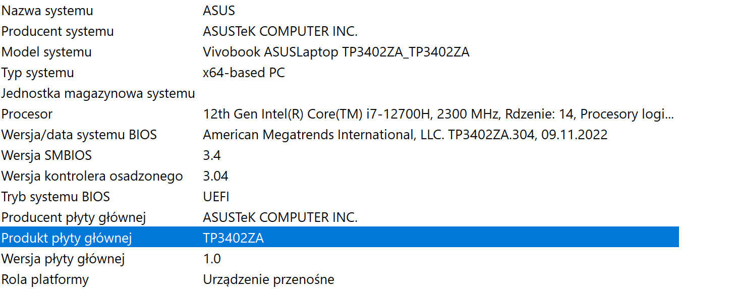

                  looks like the bin you send is not the right size please give the motherboard model so we can look in the schematic or boardview ,,,, if theres a available one
                  • Przmx
                    • Jun 2024
                    • 12
                    • Poland
                    It's TP3402ZA (detailed from Asus invoice: TP3402ZA-KN063WA)

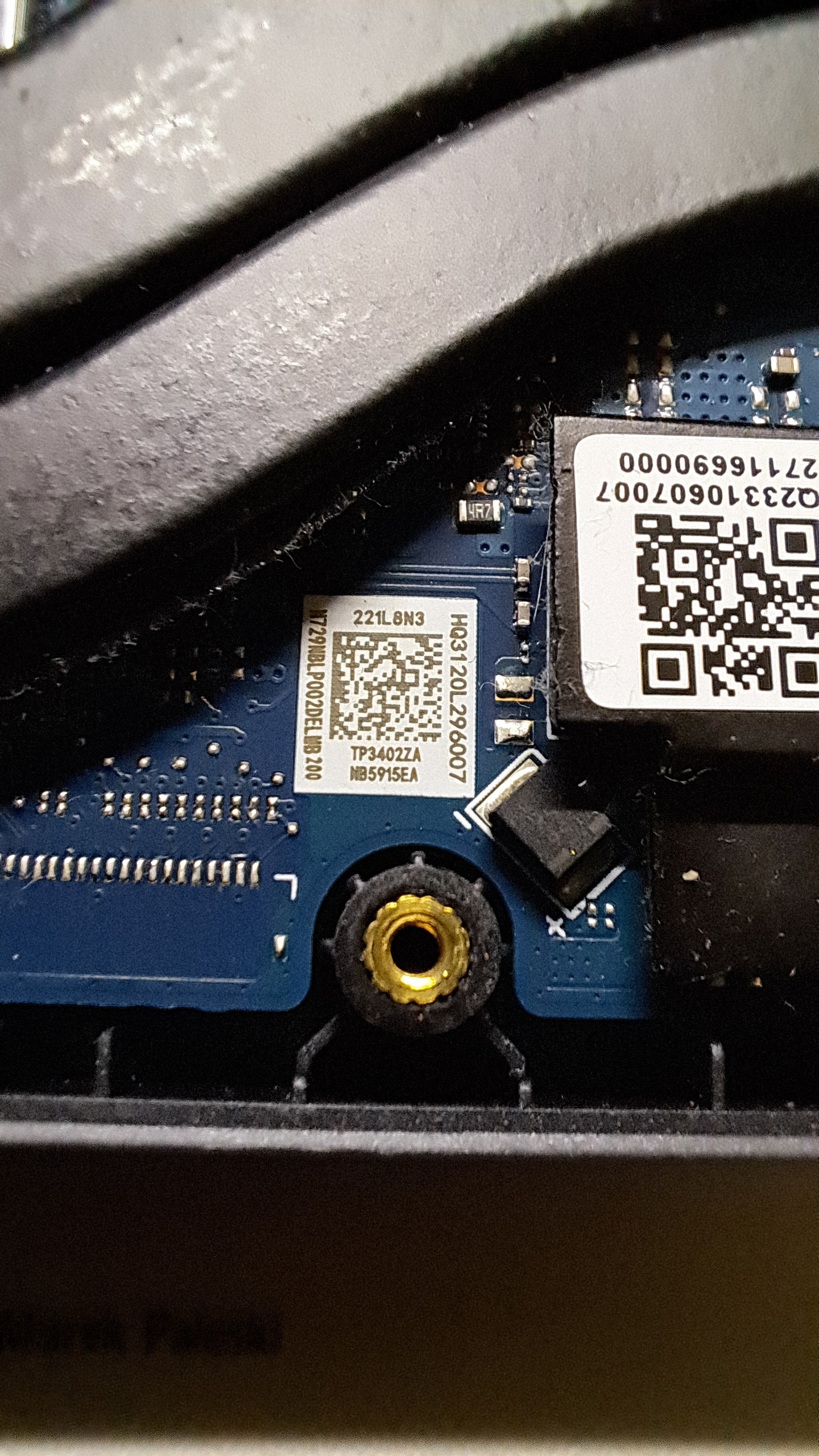

                      I think the laptop is new also , no avaialble schematic or boardview avaialble try looking under the ram so we can see the labeld in the board
                      • Przmx
                        • Jun 2024
                        • 12
                        • Poland
                        I didn't find anything under the RAM but I found this:
                        • hoaca388
                          Badcaps
                          • Jan 2022
                          • 11630
                          Do you have any other SPI chips ? XM25QH80BHIG only conten 1MB data.

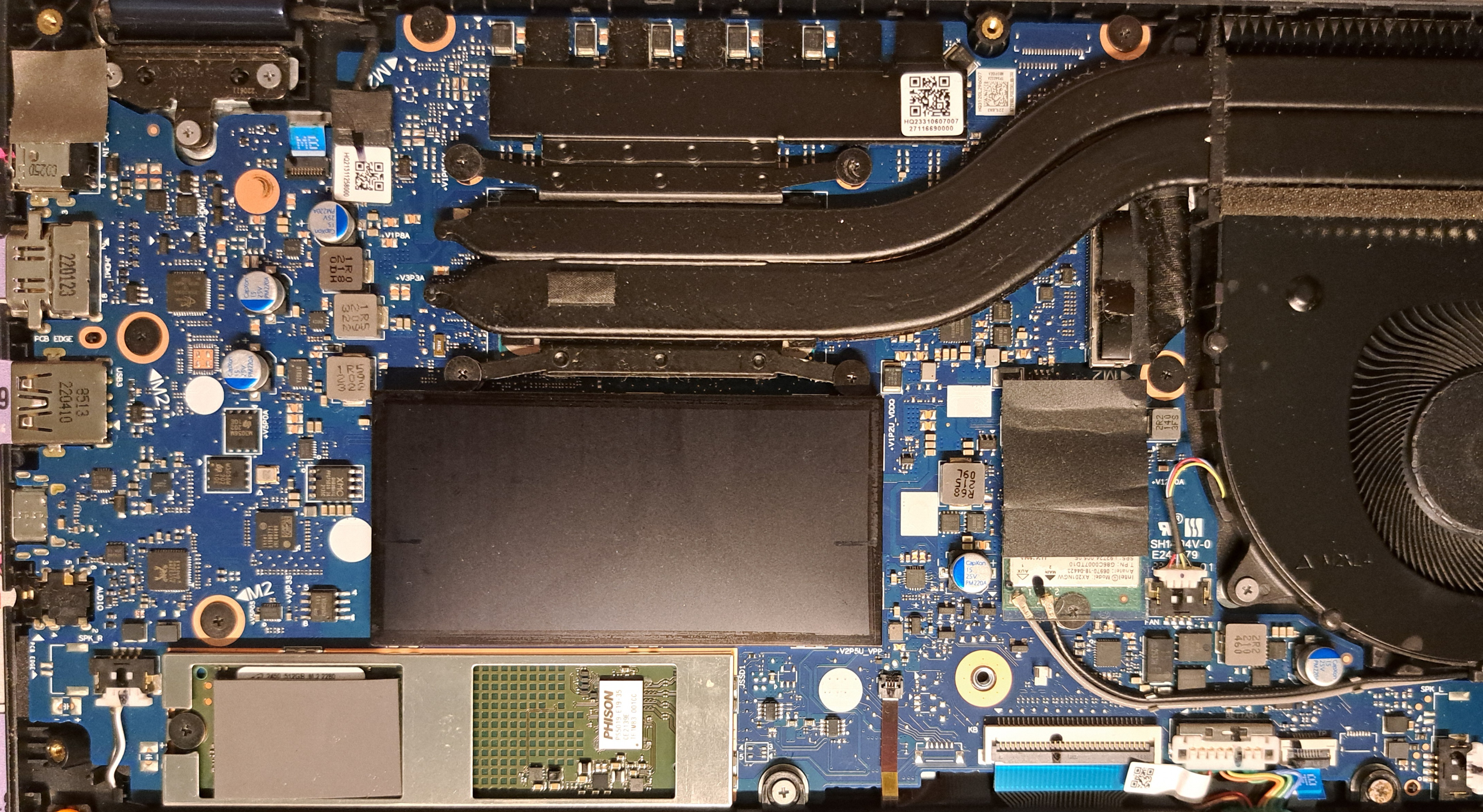

                            I only found these two chips (1 attachment). I can't find any other, especially near the processor but here are photos of my laptop and motherboard closeup (attachment 2 and attachment 3).
                            • hoaca388
                              Badcaps
                              • Jan 2022
                              • 11630

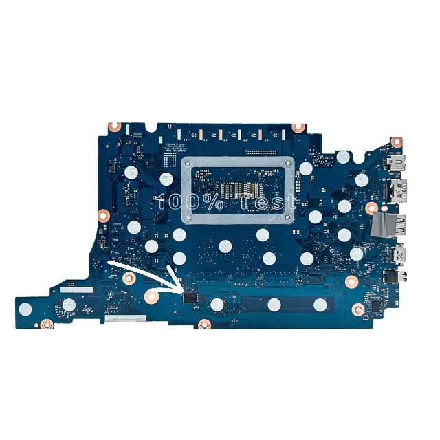

                              The other side of the motherboard ?
                              • Przmx
                                • Jun 2024
                                • 12
                                • Poland
                                Indeed, I checked the motherboard model on AliExpress and the BIOS chip may be on the other side. Thanks.

                                    Hello guys, I finally managed to disassembly whole motherboard from the laptop. Here in the picture is the BIOS chip Winbond 25R256JVEN. The problem is my SOIC clip can't get connection with the chip because its pins are so small. Do you have any tips for reading the chip without desoldering it? Thank you
                                      https://shopee.vn/Bigdealsnice-Sop8-...d-61da90513723
                                      Your options are C or D.
