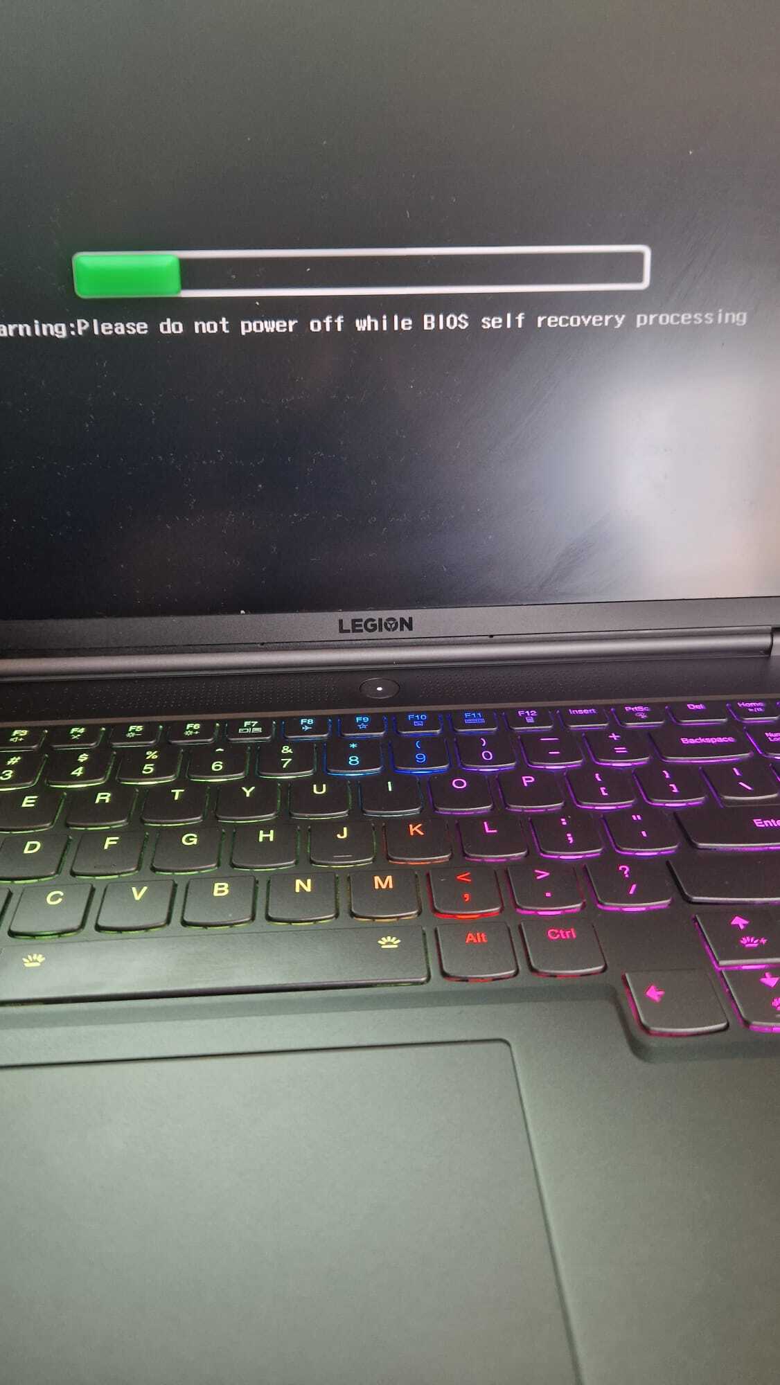

                                          Lenovo Legion 7 16ITHg6 BIOS problem
                                          by mr.Data
                                          This Lenovo Legion 7 16ITHg6 booted Windows fine but then suddenly got a power loss on a BIOS update.
                                          Now it keeps on Self-healing bios processing.
                                          When this is done it reboots and the same thing starts again, looping through self-healing.
                                          Can I fix this somehow or do I need to flash the chip with a working BIOS?...
