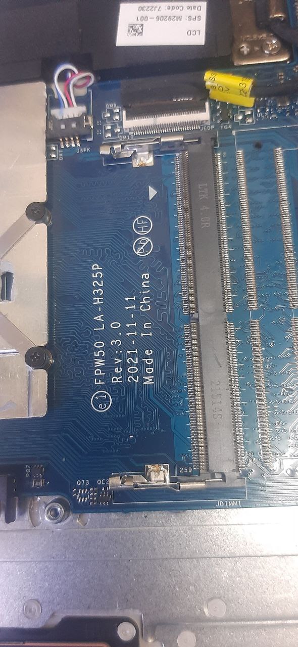

    hello guys i need a bios dump
    HP 15-dw1025nk
    serial: CND2010BLL
    MB:FPW50 LA-H325P REV 3.0

    If you have a backup post it,then we can find the BID and where the DMI is.
    BIOS guides, methods, resources and tools
    https://www.badcaps.net/forum/showthread.php?t=103526
    6. Finding bios update packages
    6.1.8. HP
    See:
    https://www.badcaps.net/forum/showthread.php?t=122195
    [Guide] How to extract ready for programming dump from HP update executable file
    https://www.badcaps.net/forum/showthread.php?t=121948

      Re: need bios dump HP-15 LA-H325P REV3.0
      if any one need it
      LA-H325P REV3.0

        It has DMI from a different machine,and no Win key.
        For anyone else interested the 15-dw1025nk BID is BID085F5
        DMI is at these offsets:
        3C7000 - 3C7FFF
        3C5000 - 3C503F
