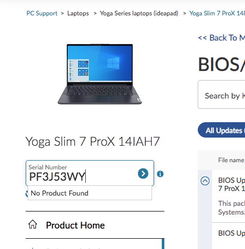

      Ahh, sorry I forgot.
      This is my backup BIOS not working.
      S.N. : PF3J53WY
      After BIOS update via Windows updates, after restart notebook not started .
      I dont find any binary file for this model on the internet.
      Thak you so much for any help with solved thi problem.

        your SN doesn't mach to any lenovo. Assuming is Yoga Slim 7 ProX 14IAH7 use this bios, your DMI is missing from your dump, is possible to use LMU to write back DMI.

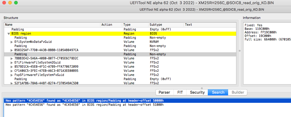

          The DMI is there ,its encrypted, search for the word LENV .Lenovo have moved the DMI area to a new offset in the new bios region ,i don`t know why.
          backup 11EC000 - 11EDFFF ,there`s 2 LENV ,the length of both being 2000h
          new image 11EB000 - 11ECFFF ,there`s 2 LENV ,the length of both being 2000h

            OK, thanks for info, I was searching for LENV in UEFITool and didn't found anything. If bios is working he knows now what he has to do to get DMI thanks to your infos.
                Newer versions of UEFITool don`t seem to search as good as the older ones. Sometimes i can find text with A57 but not A61, guid searches are ok
                  yep, after you draw my attention I did a search for hex LENV (4C454E56) in UEFITool and ... surprise! it was found in 2 places!

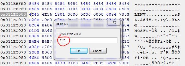

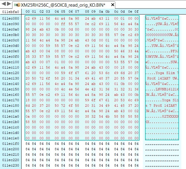

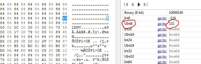

                    Originally posted by SMDFlea
                    Re: Please BIOS for YOGA Slim 7 PRO X 14IAH7
                    EXAMPLE
                    Click image for larger version  Name:	encrypt dmi.jpg Views:	6 Size:	435.3 KB ID:	3271903
                    decrypt with xor 5F
                    look at the value that stands out the most
                    xor 84 in this one
                      • 21517
                      EXAMPLE
                      decrypt with xor 5F
                      Click image for larger version  Name:	photo_2022-02-14_15-52-06.jpg Views:	0 Size:	186.4 KB ID:	3271922
                      xor 84 in this one
                      HxD can`t XOR ,i`ve been using TinyHexer,it has an XOR script .
                      HxD with data inspector and Tiny Hexer XOR value
                      Click image for larger version  Name:	Uint8.jpg Views:	0 Size:	41.6 KB ID:	3271936 Click image for larger version  Name:	XOR TinyHexer.jpg Views:	0 Size:	51.5 KB ID:	3271937

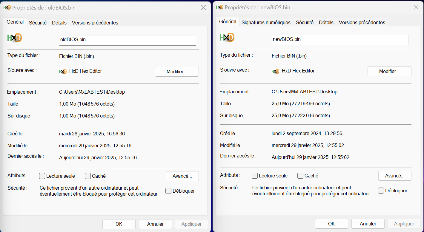

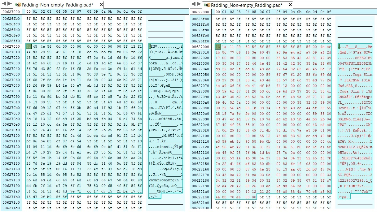

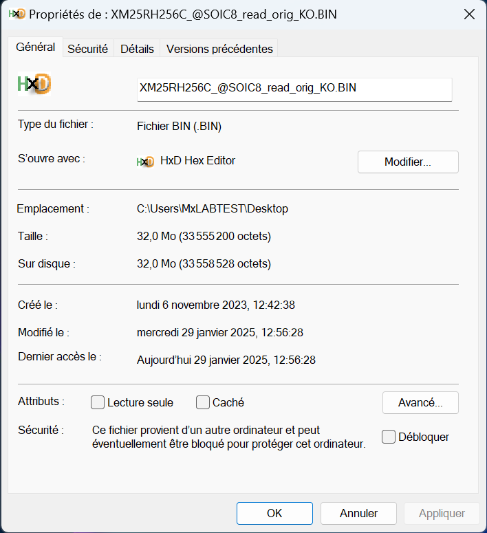

                                        Click image for larger version  Name:	image.png Views:	0 Size:	80.5 KB ID:	3559471
                                        nothing matches in the sizes
                                        32mo is good size ​
