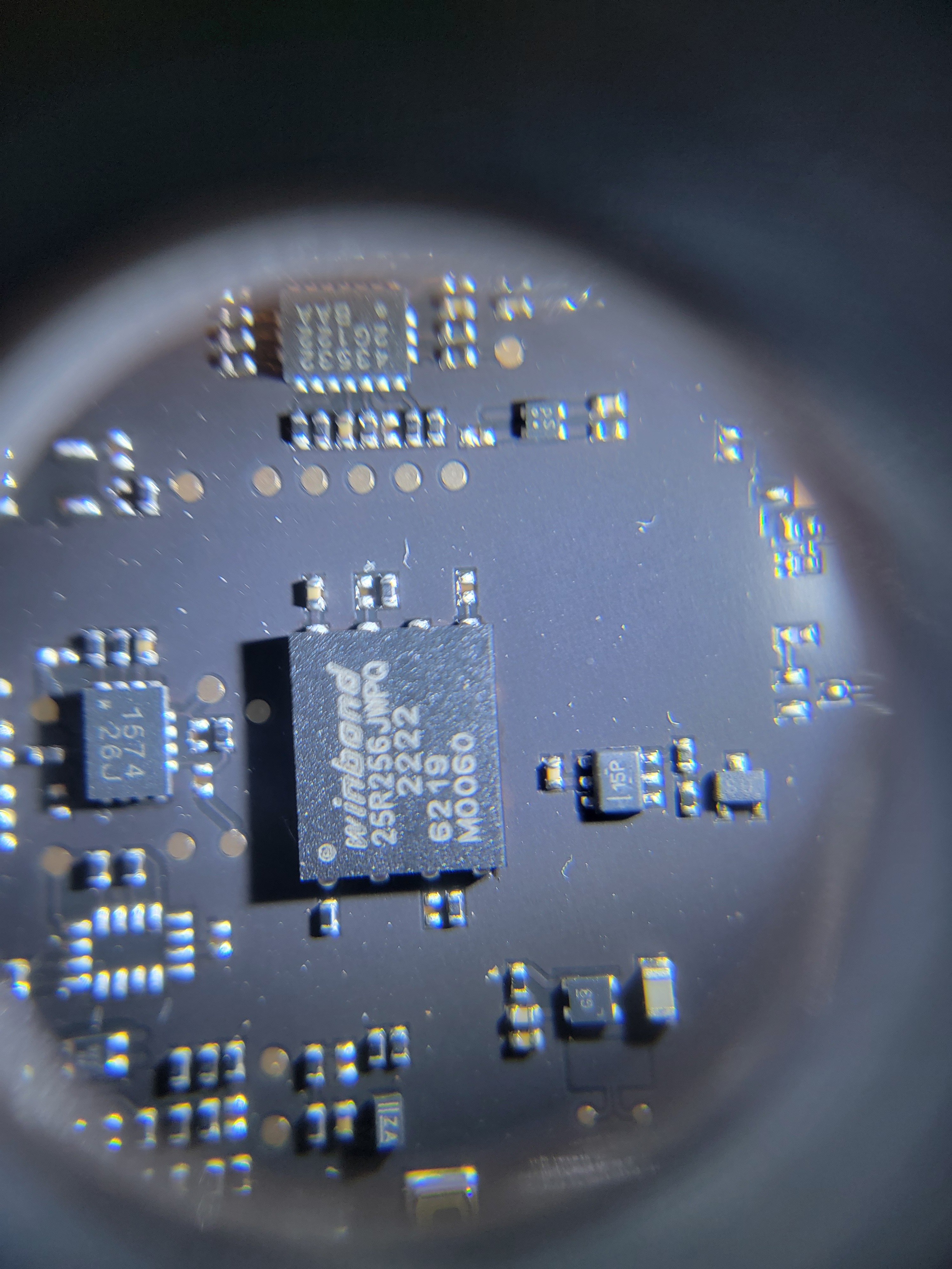

                            volinakis I'm wondering if you're able to help me. I'm in a bit of a pickle now. I bought a ebay bios chip with the attached .bin on it. I installed the bios, and my surface on boot now shows the windows logo for 3 seconds, but won't get past that. I'm wondering if you'd be able to help me determine if the bin file (Attachment: Microsoft Surface Laptop Studio 1964 M1138155-008 11th) the ebay seller loaded onto the chip is wrong.
                            I have a programmer now, and I pulled the attached dump bin (Attachment: dump_2024.12.09.bin) from the original bios after removing it. Maybe I should reinstall the dumped bin to make sure I don't have a hardware problem instead. Yikes 😅

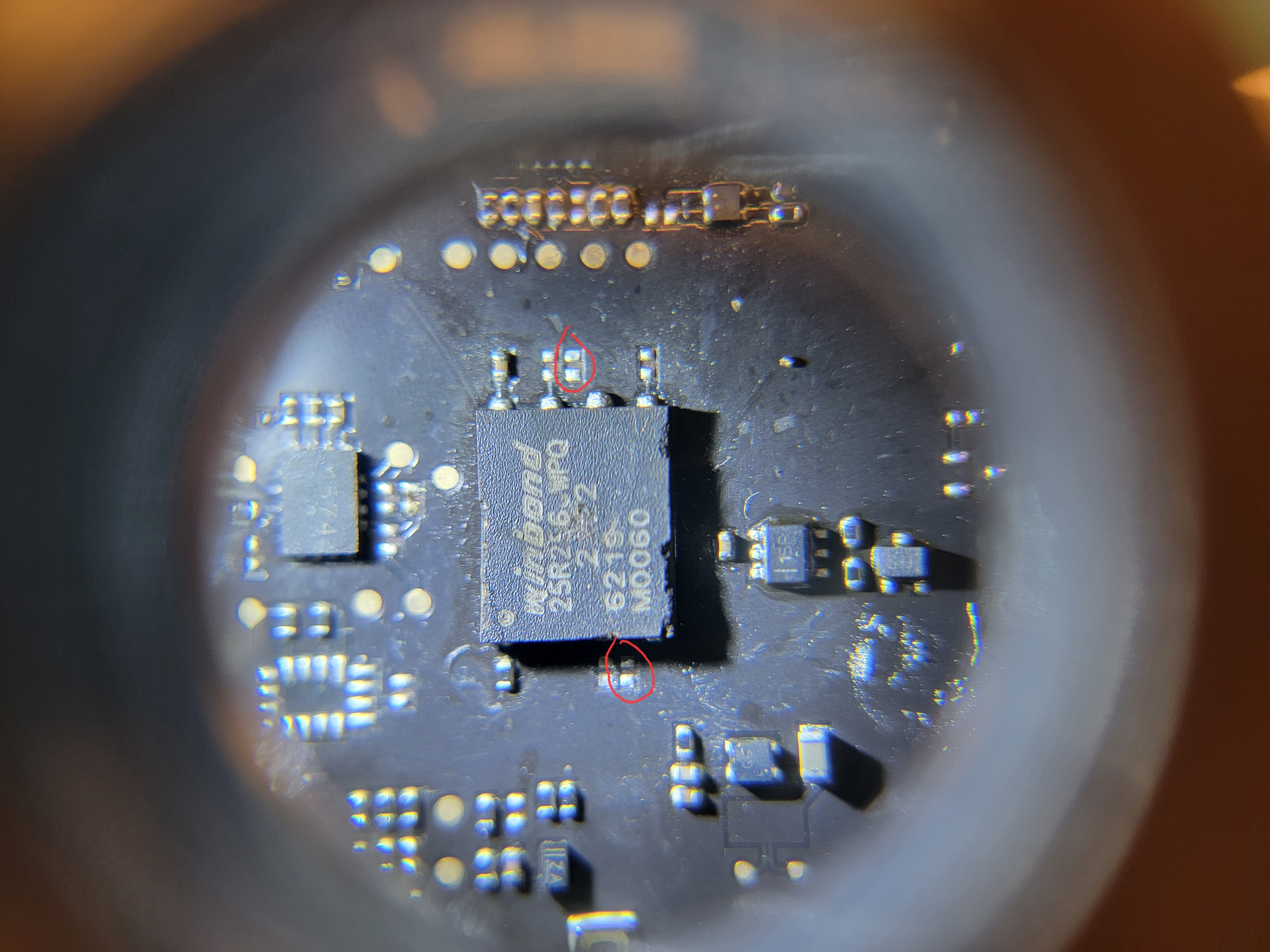

                              • brightest_z
                                • Nov 2024
                                • 17
                                Got it loaded onto the board successfully, but accidentally blew away two resistors of unknown value. I suspect they're 10k pull up 0201's because they're connected to pins 3 and 7 (IO2 and IO3) but don't have access to another board to measure :-(
