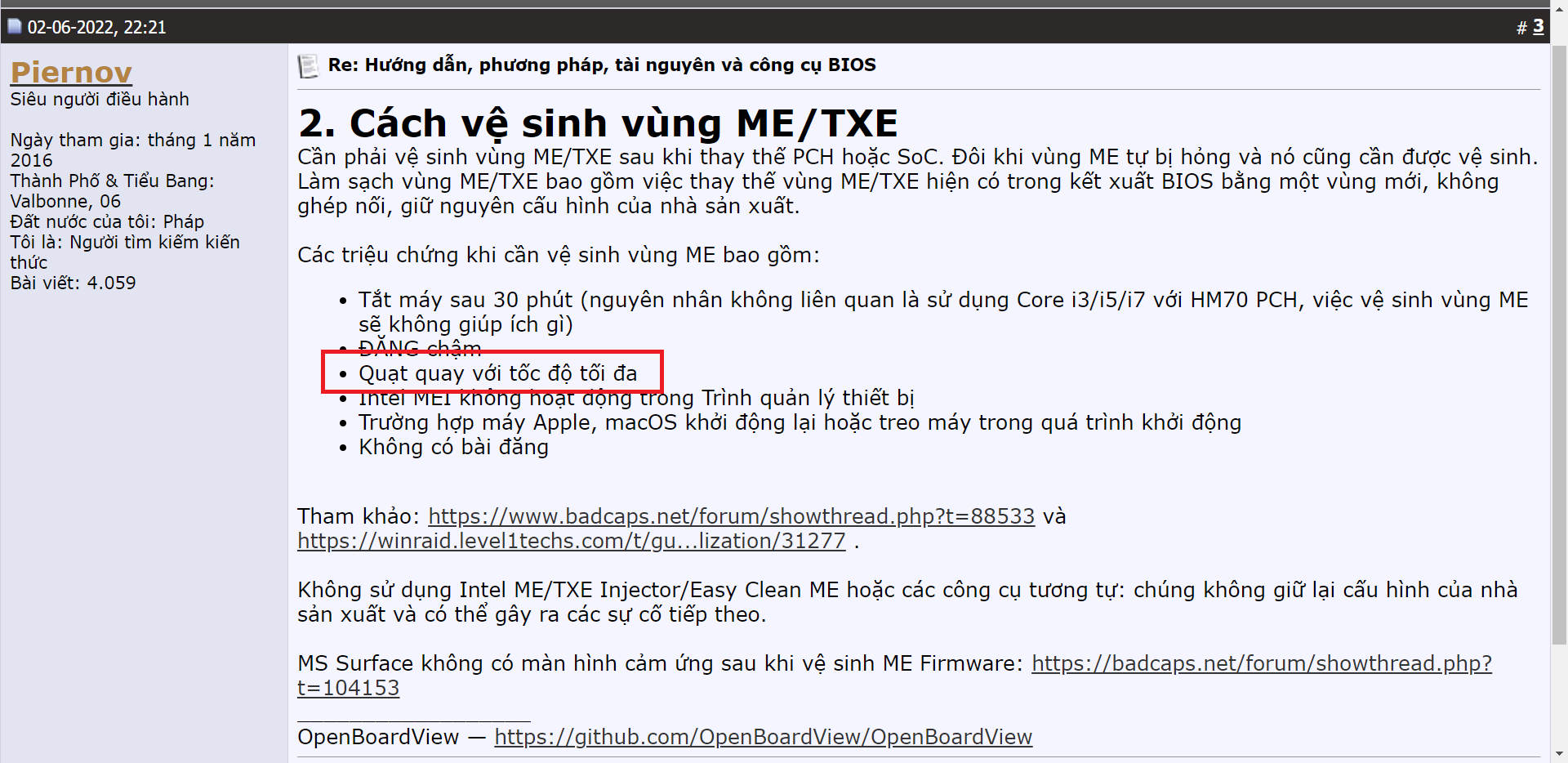

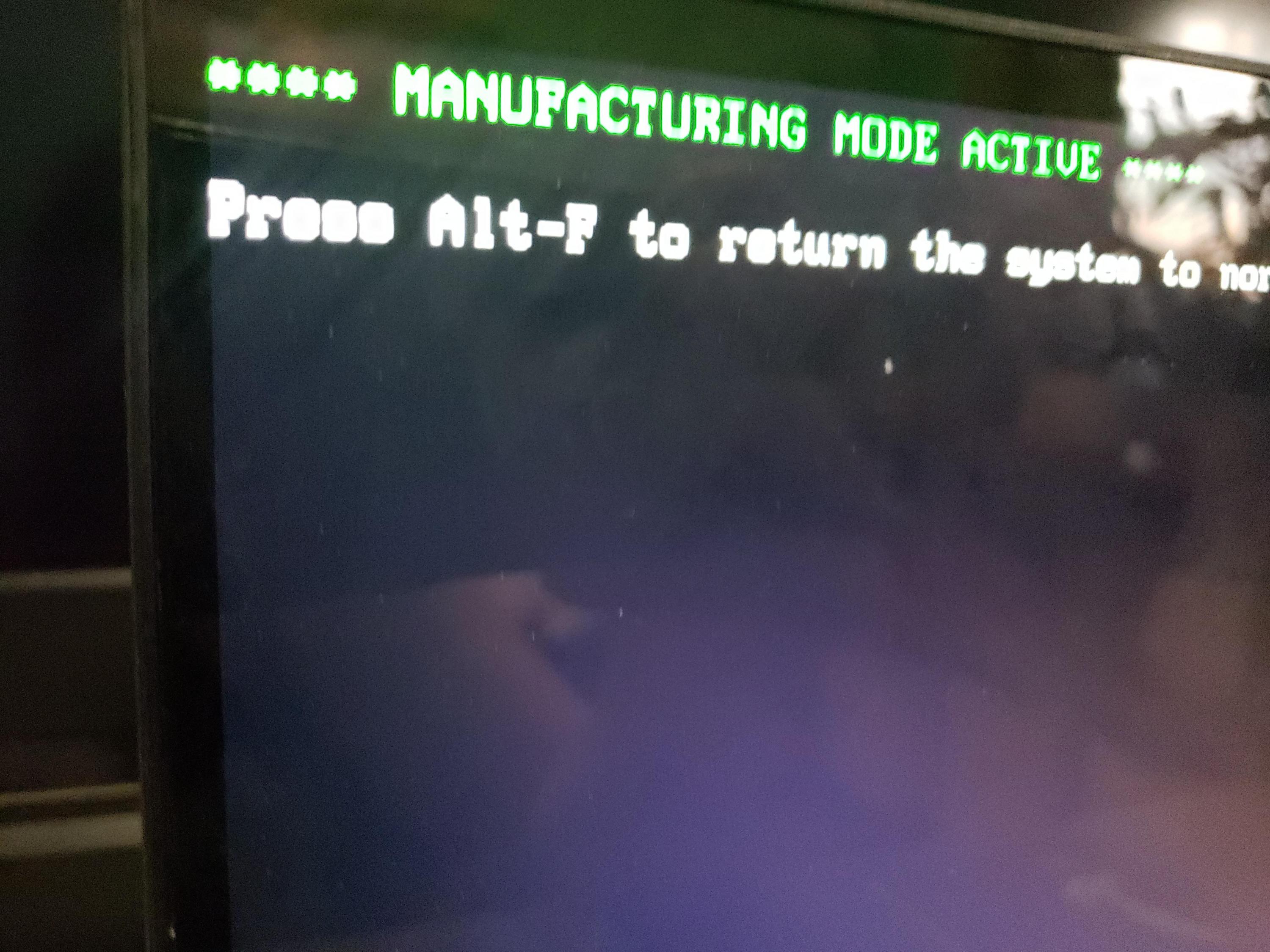

      The password has been completely cracked, but when I turn on the fan, it runs continuously and is quite loud. I've tried resetting it to defaults and downloading a new bios, but the fan still spins continuously.
      • hoaca388
        Badcaps
        • Jan 2022
        • 11813
        Re: dell Precision 5680 pass bios
        https://www.badcaps.net/forum/showpo...41&postcount=3

          Hello, did you exit manufacturing mode with Alt + F?
          • trunguntilyou
            • Aug 2022
            • 328
            • Vietnam
            The problem has been resolved,, thank you comrades
