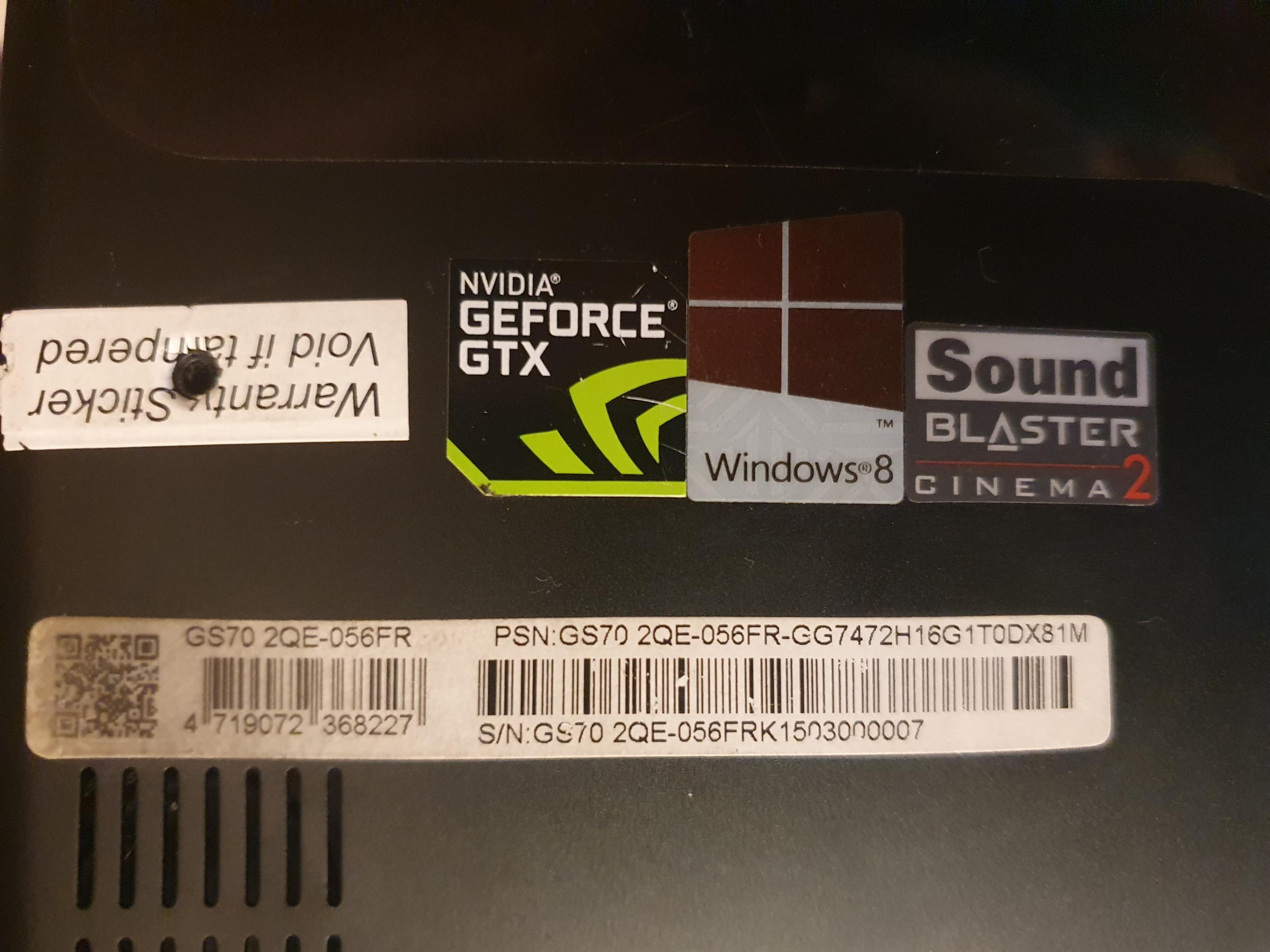

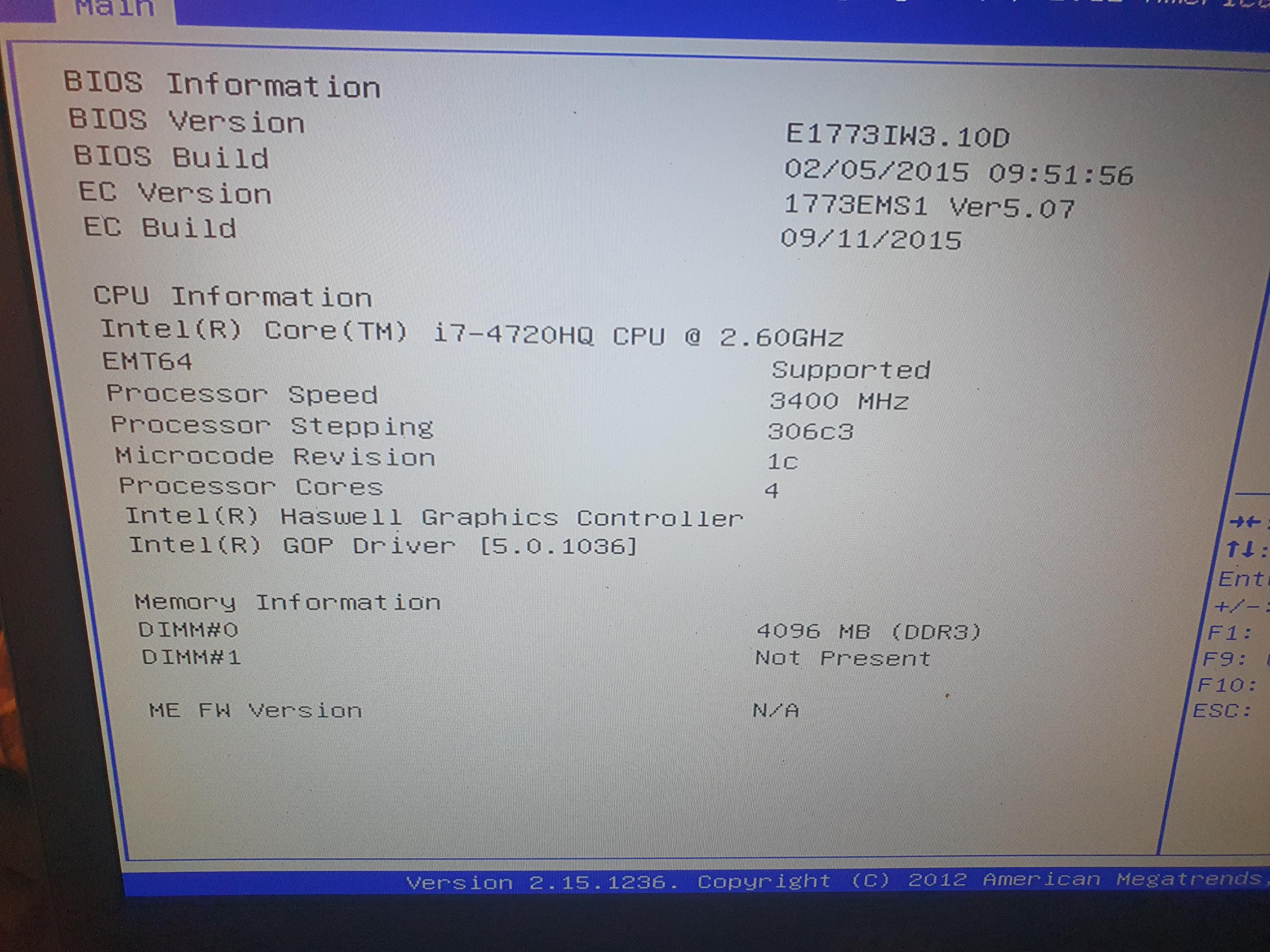

    hello ... I have a msi gs70 2qe ms 17731 rev1.2 laptop that remained locked at startup on the MSI logo ... I found a bin on the forum that I wrote and now it works ok, except that it doesn't take my serial id, it doesn't recognize my motherboard, as a model in aida64 it appears as unknown and my logo doesn't appear at startup... it goes directly into windows... I tried to do cleanME but it gives me an error with flashtool... you may have a good bios or what can I do to make them work correctly for me ... thanks
    I attach the original bios

    Please post the laptop serial number

      Re: Bios ms-17731 Ver 1.2 problems
      Tnx
          it doesn't work ... it does the same as the original one ... it freezes at the MSI logo ...
              if the bios on the website doesn't work, you have another problem..
              https://www.msi.com/Laptop/GS70-2QE-Stealth-Pro/support
