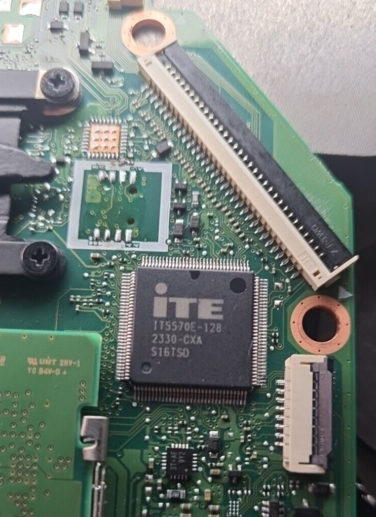

                Hello all, can you help remove the password please, no luck with RCUnlocker.
                HP 15s-fq2571sa
                S:N 5CD336PT04
                Motherboard : DA0P5HMB8JO REV J
                Thanks.

                  the bios you posted does not have the password...RCUnlocker works very well...look for another chip on the board and see there..

                    Thanks for reply mate. That's the only 8 pin bios chip on the board, the back of the board is blank nothing on the back.
                    I do have a ITE5570E-128 chip and the bios is right next to it. could the pass be on this chip like Lenovo
                    Can svod4 do this with a keyboard adaptor. seems to be a socket right next to it too. any one know?
                    Thanks.
                    Edit, Just found another post on this chip it is programmable.

                      Try this one

                        Thanks mate, I will get around to trying this over the next day or 2 and will give an update, thanks again.

                          The password is gone mate, thank you very much for your help.
