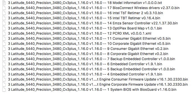

    you are welcome, your text proves once again that you should start knitting ... Yes, NEVER happened to me because I read chipset 2-3 times and compare results, if I have 2 identical it means I have a good backup, now you did learn something you didn't think in your MORE than 10 years experience ... look at this picture and maybe (but slim chances) you'll understand why you have to provide bios backup and serial ... If you ask nicely I will teach you how to extract modules from update package ...
          Click image for larger version Name:	Screen Shot 2024-10-04 at 13.47.10.png Views:	0 Size:	131.9 KB ID:	3476217
          Would you please be so kind to teach me how to extract modules form update package, because that's for sure a thing I don't understand, and I'm willing to teach. And yes, compare file results would be the best and safest way of checking a file, but I didn't, because I never did run into this problem before with the new programmers. When using the older EZP I whas more aware of it, and I need to do that again with this type of model laptop. Also I check ME for corporate and consumer, but always consumer. Even when I worked at a company where we fixed motherboards from laptops it whas ME consumer, because it always where consumer laptops. For this model I see only ME corporate on paid site, and also on this site when downloading files. And I must be honest that I spend some time to find ME 16v online, but I couldn't find it, so I couldn't play with files.
          So, now you showed me something I don't know nothing about, so if you are still up for it, than please teach me.
                Download Bios_Utilities from github by master platomav, install Python (you have in Readme the command), download update exe from Dell site, move it to Bios_Utilities, rename it without dots or spaces (i.e Latitude_5440_Precision_3480_1.16.0.exe to Latitude_5440_Precision_3480_1_16_0.exe) and use Dell_PFS_Extract.py in cmd ( Dell_PFS_Extract.py [space] Latitude_5440_Precision_3480_1_16_0.exe.) You have to merge 32Mb and 16Mb files to have full bios image then use MFIT 16.1 to decompose full bios image then replace Bios_rgn and ME_Subpartition with ones extracted from update, renaming them as in Decompose folder ( bios_region as BiosPlugin#BiosRegion.bin and ME firmware as ME Sub Partition.bin) Then hit Built tab, MFIT will split bios image in 2 files, one for 32Mb and another for 16Mb chipsets.
                Class dismissed!

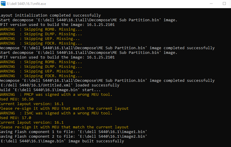

                  now try these files ...
                          I tried your files, but they didn't work. With all files I got same result. Only Dell logo with 'Secured with Dell safebios'. Also fan spin is high.
                          Also I tried to go through the steps, but I can use some extra information/class. Would you like to help me? You tell to install python and that the command is in the readme file. Does this mean that while installing python I need to use a command during the install, or are the commands needed later on when opening python? The readme file is full of information, and it's not clear to me what is command is important. For now I just installed python 3.13.
                          I downloaded Dell update bios, placed in BIOSUtilitie, and renamed it. Went to CMD, but the command is not recognized as an internal or external command. So, I'm doing it wrong, and it seems that it's good to already have some knowladge how to use python, and also I need to find MFit 16.1.
