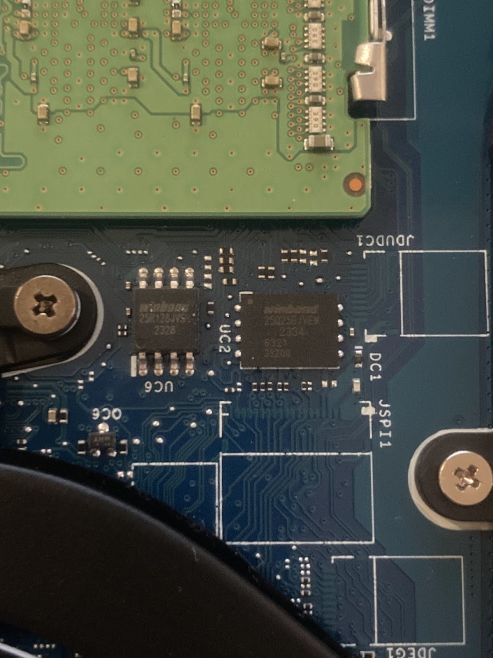

                                    This is my first BIOS unlock and I congratulate you guys for understanding this Rocket Science stuff.
                                    So, I have a bios locked DELL Latitude 5440 (motherboard la-m401p) and serial number ST: J6BKSV3.
                                    I have two chips that look like a bios :
                                    - Winbond 25R128JVS -> Dissoldered and read content (backup validated twice)
                                    - Winbond 25Q256JVEN -> Not read yet, I don't have the part to read it
                                    The bios dump I read is 16Mb and I see that in this thread most of the dumps are 32Mb. So either I read the wrong chip or I don't have the same configuration as you.
                                    Thank you in advance.

                                      #58
                                      HI ahmed lachtar
                                      Upload Winbond 25Q256JVEN which is 32MB flash. Your 16MB dump dont have required data to modify

                                        #59
                                        Thank you Struart, I will dissolder and send the dump here

                                          #60
                                          Do you have an idea how to dissolder this chip ? With the 16Mb, it was quite easy because the pins were exposed, I added solder and the used the air gun. But with this one the pins are quite small. I tried adding flux and rising the temps (400°C) but no luck. Here is the image, it's the chip on the right.
