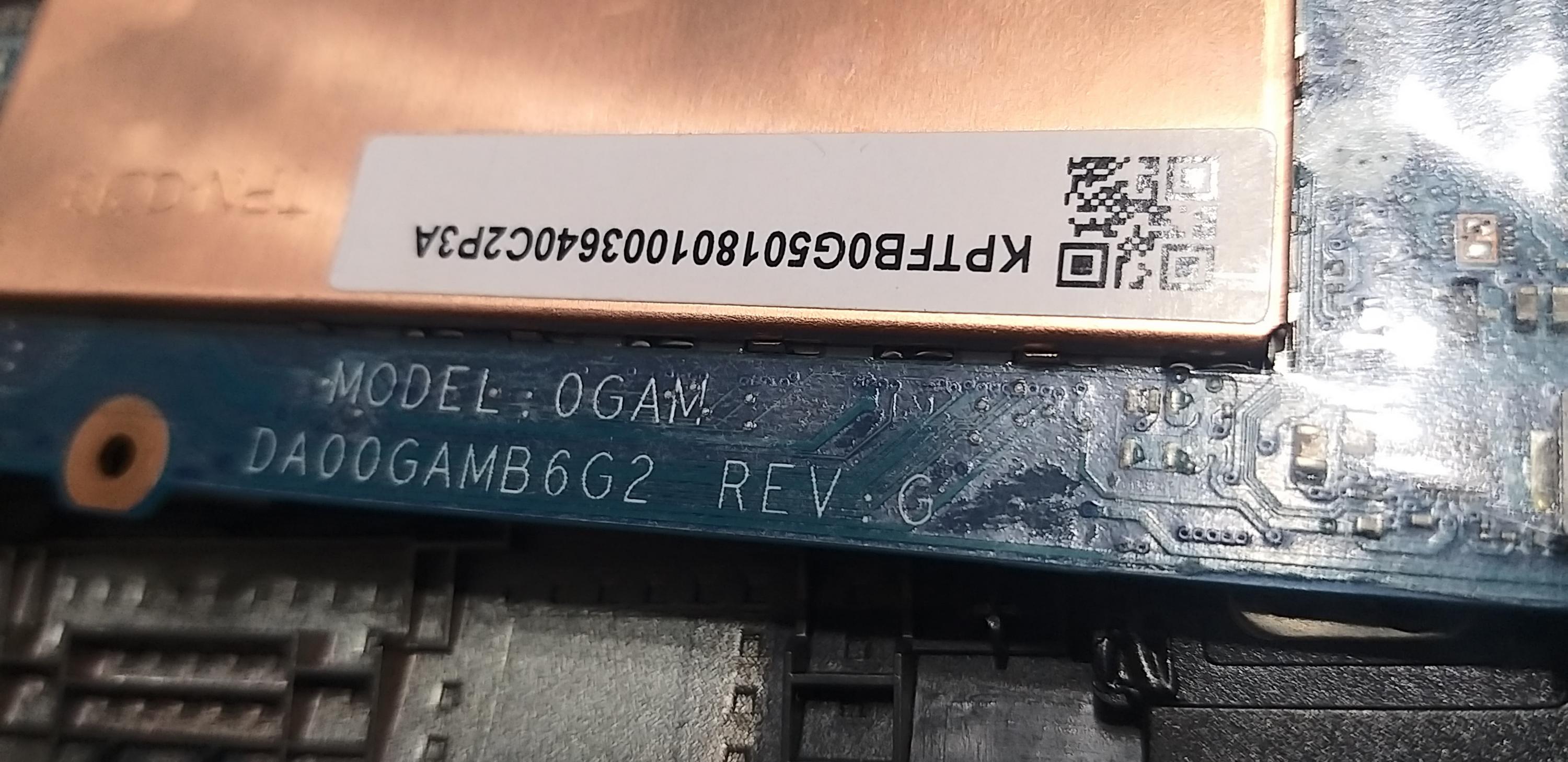

hp chromebook x360 11 G3 EE bios password no one can unlock it
  • tinto
    • Jul 2017
    • 74
    • serbia
    hp chromebook x360 G3 EE
    i try HP unlocker, RCUnlocker, i try to change value in hex editor devmode,enrollment..... nothing
    every time developer mode is disabled on this device by system policy....
    every time is locked
    i cant recovery new chrome os...at the end thay have some error....
    this is original locked bios

          • volinakis
            • Jan 2021
            • 2695
            • N/A
            Re: hp chromebook x360 G3 EE bios password no one can unlock it
            if you can't recovery OS and you got "an unexpected error has occurred ..." message, read this thread:
            https://www.badcaps.net/forum/showpo...05&postcount=1
            before doing what is written there write unlocked bios from attachement.

                volinakis
                i try your bios dump.... but nothing, just like my original...hrome OS is missing or damaged
                then i try your tutorial.....as you wrote,
                when “Chrome OS is missing or damaged” message appeared I pressed Tab key and found: read only firmware id: Google_Rammus. xxxxx.xxx.x.
                my is Google_Meep.xxxxx.xxx.x
                ,but On "https://chrome100.dev/#recovery-images , Google Meep does not exist
                    volinakis
                    look for chromebook model, x360 11 G3 EE, and you'll find it as "octopus". I mean, really, you need to be guided letter by letter?
                    And bios is NOT "just like my original", it has 4 modifications, do you understand that you HAVE TO REINSTALL after writing new bios?
                      volinakis
                      I have a lot of work to do and this chromebook annoyed me a lot for a few days...
                      I did everything as you wrote and it works like a Swiss watch
                      thank you very much and this should be on top and sticky
                      very useful and the only solution for all other colleagues who have the same problem
                      Thanks volinakis and everyone else who tried
