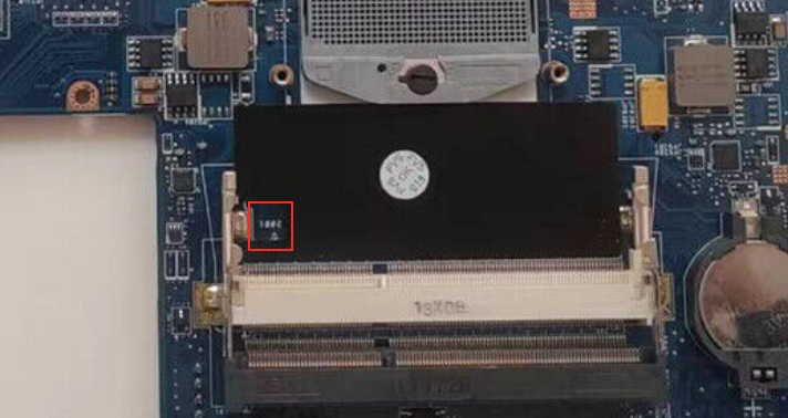

          Re: toshiba satellite c670-1CK BIOS password
          Originally posted by 24gsm
          can one help me for this bios files .
          this model has bios reset pads near RAM slots, see photo. Remove RAM, plug charger and keep pads shorted for 15-20s
          • 24gsm
            • Mar 2017
            • 36
            • algeria
            not worked already tested . the unique solution is writing a bios
