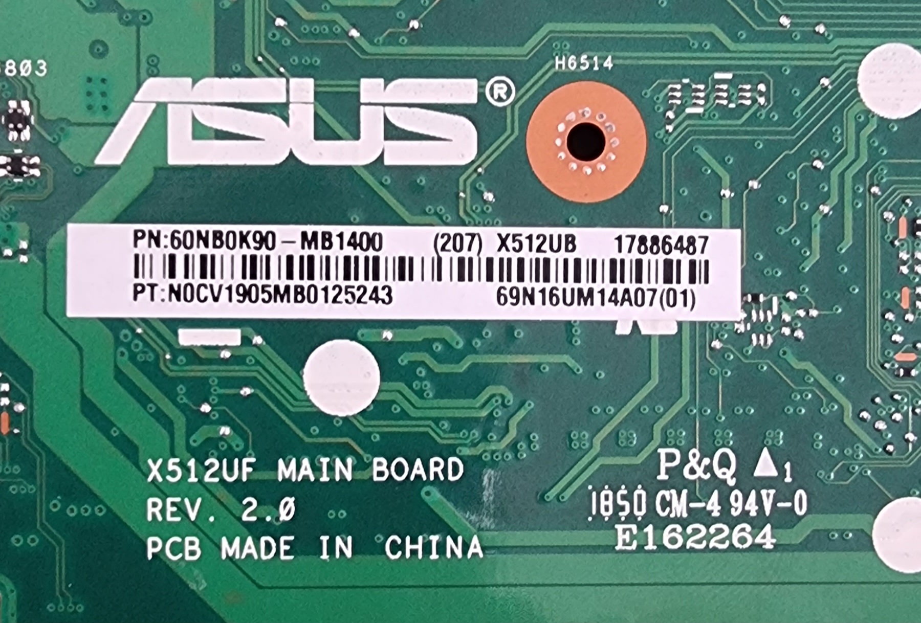

    Hi. I have a problem with an Asus F512U.
    It had a short capacitor that did not allow the start. Once the capacitor was removed, the PC started but did not give video. I flashed dump found on this forum and now the PC turns on without problems, but does not recognize the battery (which used to work). What can I try? If I upload the original bios, is it possible to do something?

    post here the original bios and clear pictures with the stickers in the RAM memory area or a square with white paint with a QR code..

      Re: Asus F512U BIOS - Main X512UF
      Other thing. Asus logo appears after about 15 seconds.

        try..
          Thanks! Delay problem solved! I still have battery problem. But, maybe, it could be my fault. Because before I found the capacitor burned, I changed a Mosfet and now I’m not sure if it was the right Mosfet...

            Hi, ASUS Vivobook F512U, board X512UF rev2.0, i3 cpu intel graphic only.
            After turning on the laptop, it polarizes the LCD screen and then turns off after a second.
            I am attaching the old bios, I don't know if it is original because the bios chip was soldered.

              Serial number. This is a forum rule and you already have 164 posts, do you need to be reminded again ?

            Sorry, but I couldn't find the serial number on the laptop. The computer doesn't display a picture, so I can't enter the BIOS.
            edit 12:00
            I downloaded the file from this topic (#4), moved the 2400C0-242BE0 data block from the old BIOS and the laptop started.
            We'll see what happens.
