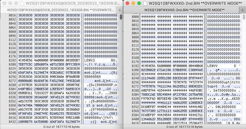

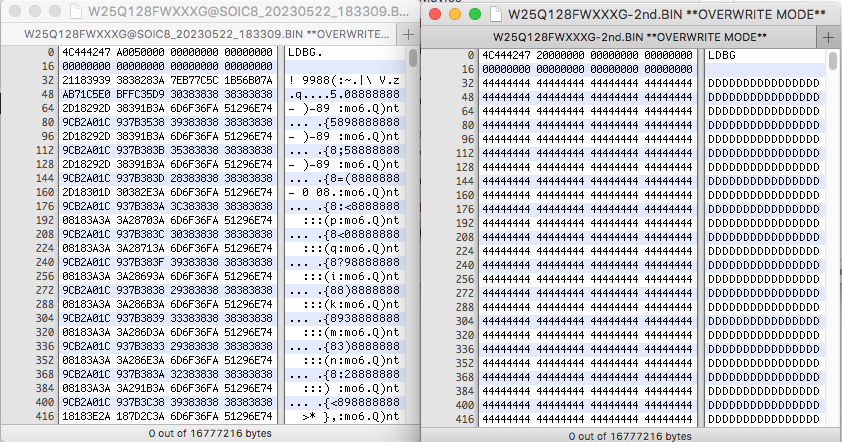

    it came with no display, power button blinking all the time. I did read bios and saw it has some strange bytes in Padding area, I thought is a bios bug so I wrote a new bios extracted from lenovo site. All was ok, after few days laptop came back with same symptoms, i did read again bios and noticed Padding area having again strange bytes. Maybe someone can help me understand why this is happening, what can cause this strange thing.thank you.

        It's not a strange bytes, if you mean the data between (0-3000h) it's the DMI of this Lenovo Laptop, it will be empty in the Virgin BIOS so you will need to move it from the Original dump to the New one to keep the DMI save.
          The code before that LDBG is probably Debug code ? ,not sure.
          Edit: LCFC debug

            I really don't know what this code is, but I think it's used to arrange the DMI, because I can see it mentioned many times between the encrypted DMI.
            I always copy the data from "LDBG" to the end of the DMI (no matter what length it was, 2000h, 3000h or 4000h) and it's always working fine.

              I think DMI is between 1000-2FFF - usually i search for "LENV" to find DMI data.
