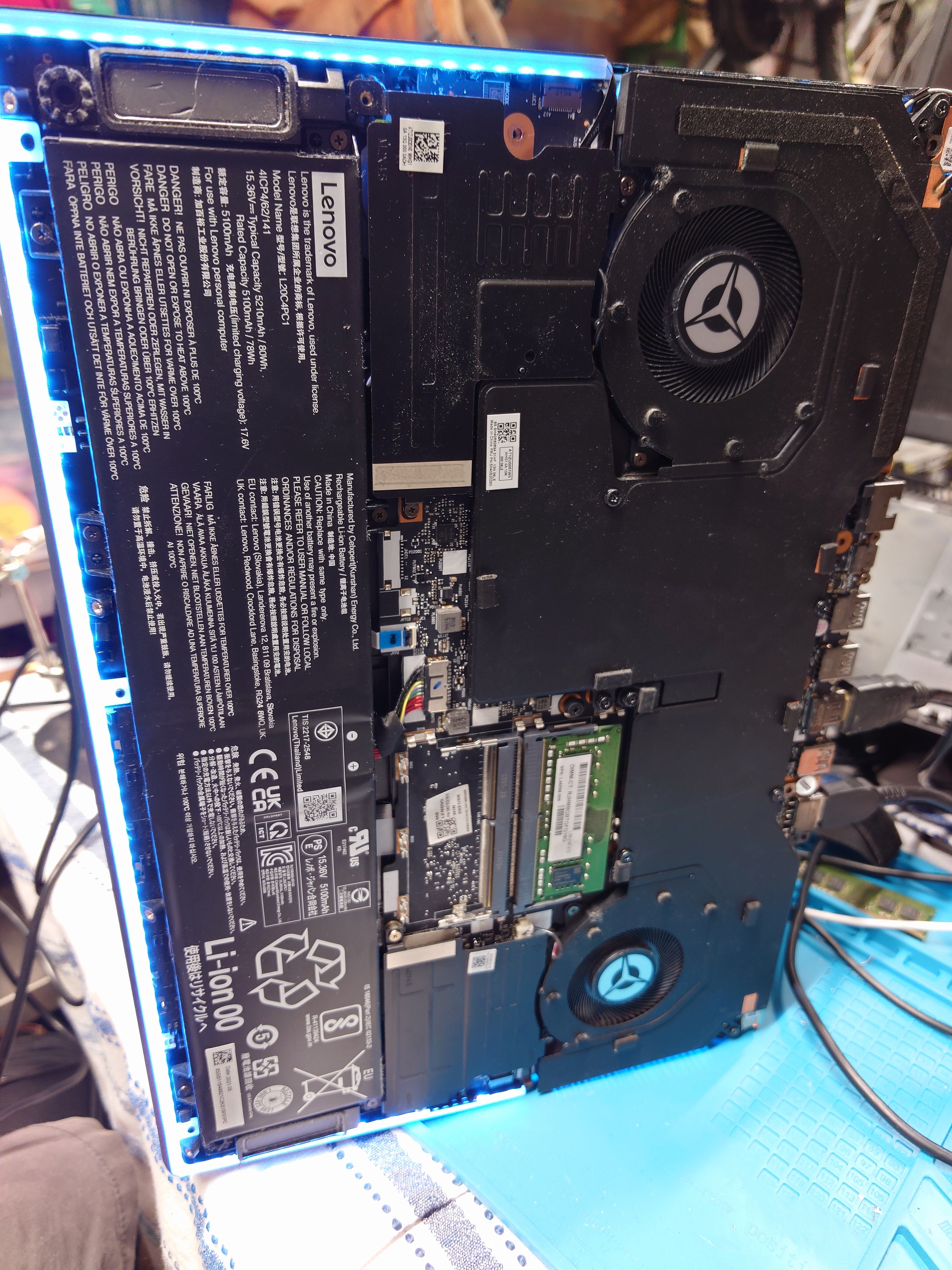

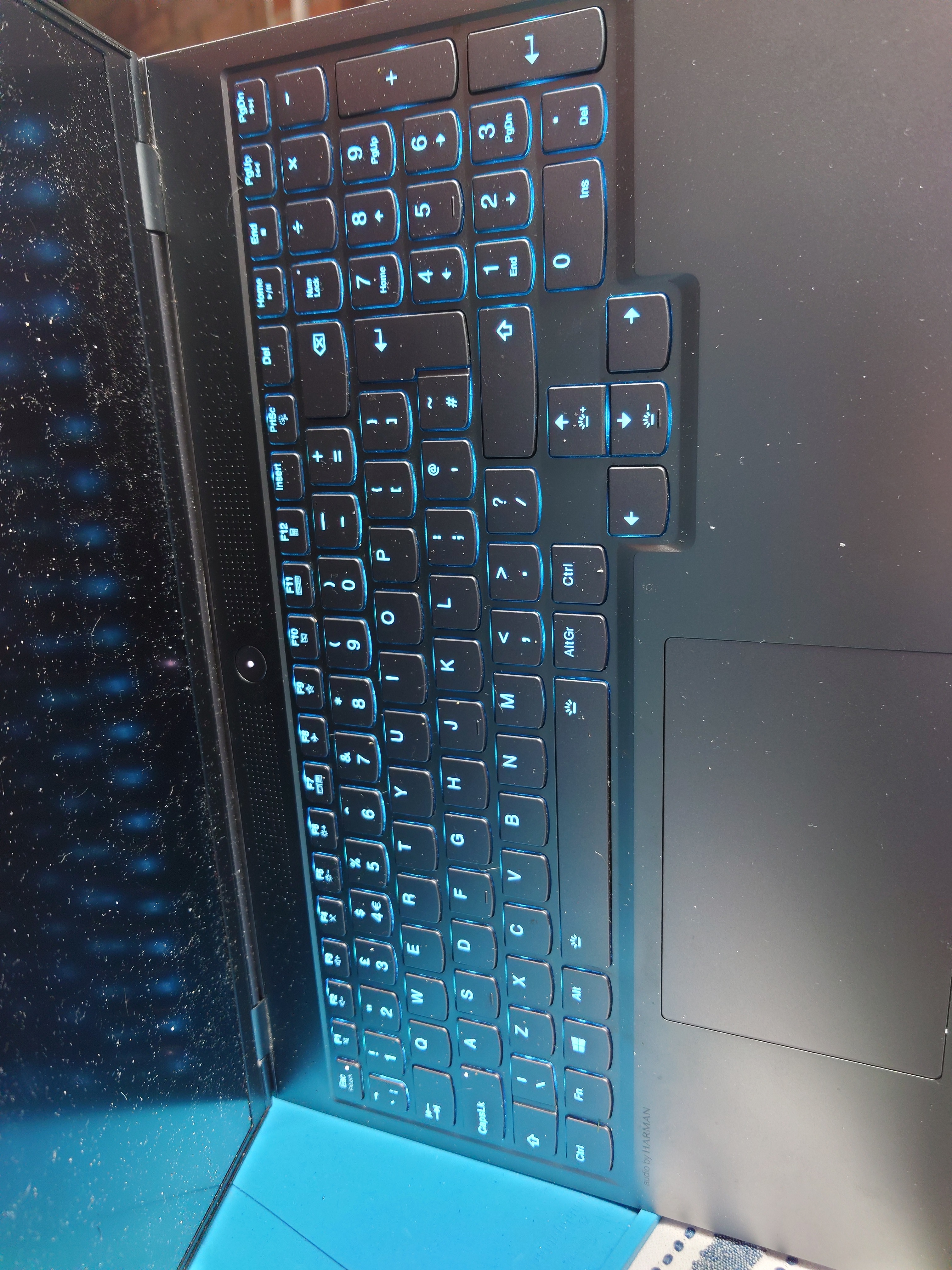

            • Lenovochris
              • Aug 2024
              • 59
              • United Kingdom
              Bios Request please
              Lenovo Legion 7 16achg6 s/n PF30C3Z0
              Keyboard lights come on, Fans spin for a split second, Esc/fn lock light stays on the whole time. No display. It is charging and i have power light, It post loops in a sense as it will wait a minute then spin fans again then stop then fans again.
              Please see bios dump attached,
              Many Thanks

                Originally posted by Lenovochris
                Bios Request please
                Many Thanks
                try
                      Unfortunately same symptoms although have caps lock light now as well. I've attached pic and a video.
                      bios is extracted from update with your DMI transferred. Let it run 2-3 mins, if doesn't work look for hardware fault. Put just one RAM module, remove SSD and wifi, battery.
                      • Lenovochris
                        • Aug 2024
                        • 59
                        • United Kingdom
                        Ah ok thanks
                        I've tried running it for around 5 mins with nothing connected apart from charger and 1 ram module
                        Keyboard lights up up fans spin for 3 seconds
                        Lights go out after a minute or so then fans kick in and the cycle repeats, all while having no display.
                        I'm not really sure where to start to be honest.
