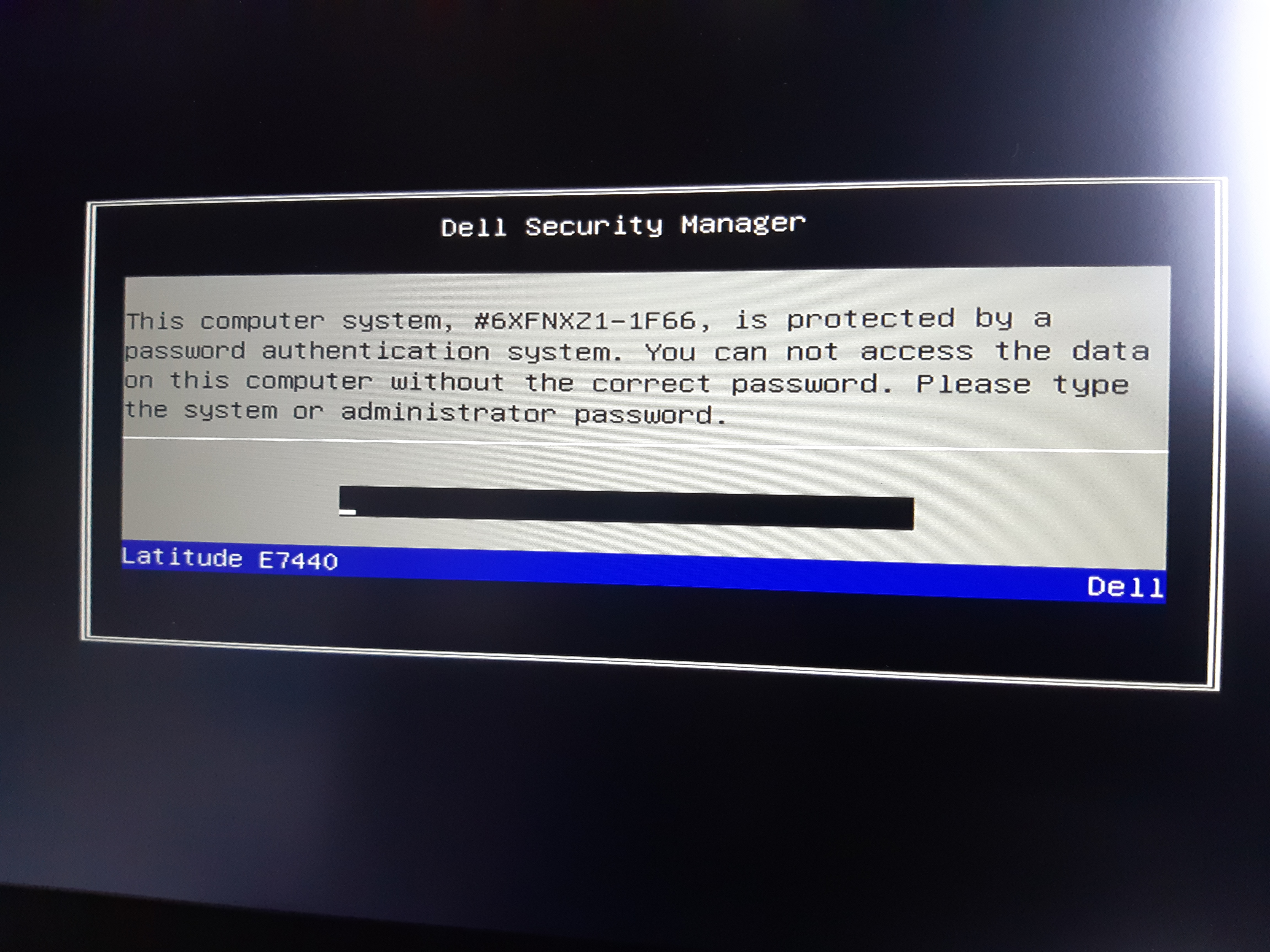

                #47
                I had an old Latitude 7440 (2014), but the admin password is blocked.
                I've try BIOS-PW.org, but it doesn't help me... more I'm now blocked on the Dell Security Manager page at each restart (picture attached).
                Is there anyone to help me ?

                    • 20745
                    #49
                    https://www.badcaps.net/forum/troubl...23#post1622423
                    Dell laptops store the password in EC. However, some generators exist depending on the code suffix.
                    See: https://beta.bios-pw.org/ .If the website is offline try: https://web.archive.org/web/*/https://bios-pw.org/
                    Note: All passwords must be entered with a US QWERTY Keyboard,you can use a USB one.
                    Note: The 6FF1 suffix has a bug,use your service tag with the 1F5A or BF97 suffix instead,Example: 1234ABC-BF97 .
                    Note: The list of examples does not include some other suffix codes that do work,such as E7A8 .
                    Note: If the BF97 suffix does not work try it with the E7A8 suffix instead.
                    Note: There is no publicly available 8FC8 generator available at the moment.
                    The CTRL-ENTER-ENTER keystroke after the password only applied to laptops with a suffix (xxxxxxx-8FC8 for example), until Dell also required it in some laptops using System Disable 16-Hex algorithm, on which only the Password+ENTER was needed at first and then in some models you needed the CTRL-ENTER-ENTER to properly delete the system passwords, otherwise the password would remain SET upon the automatic system reboot if just doing Password+ENTER until the proper CTRL-ENTER-ENTER keystroke was performed in certain models.
                    8FC8 Patcher software: https://www.badcaps.net/forum/troubl...l-8fc8-patcher
                    • AWA62
                      • Jan 2025
                      • 2
                      • Belgique
                      #50
                      Originally posted by LBTT1121
                      attach bios
                      No access to the parameters of the computer
                      Only S/N 6XFNXZ1, as shown in the attached picture
