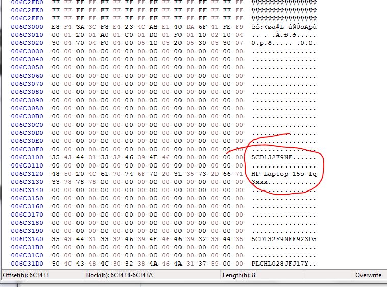

    Hi i've got HP 15.6 inch Laptop PC 15-d3000 which runs but no display i would appreciate it if someone help me with a working bios. The board number is DA0P5KMB6F0 rev f here's my old bios
    • 22084
    Re: DA0P5KMB6F0 Bios needed
    Always post as much info as you can !!! .Post the laptop serial number, it looks like the wrong bios has been flashed.
      both Laptop model BID is same
      Dump Attached Try
      • Stunt
        • Oct 2019
        • 203
        • South Africa
        Dump Attached Try
        Thanks man it's working
