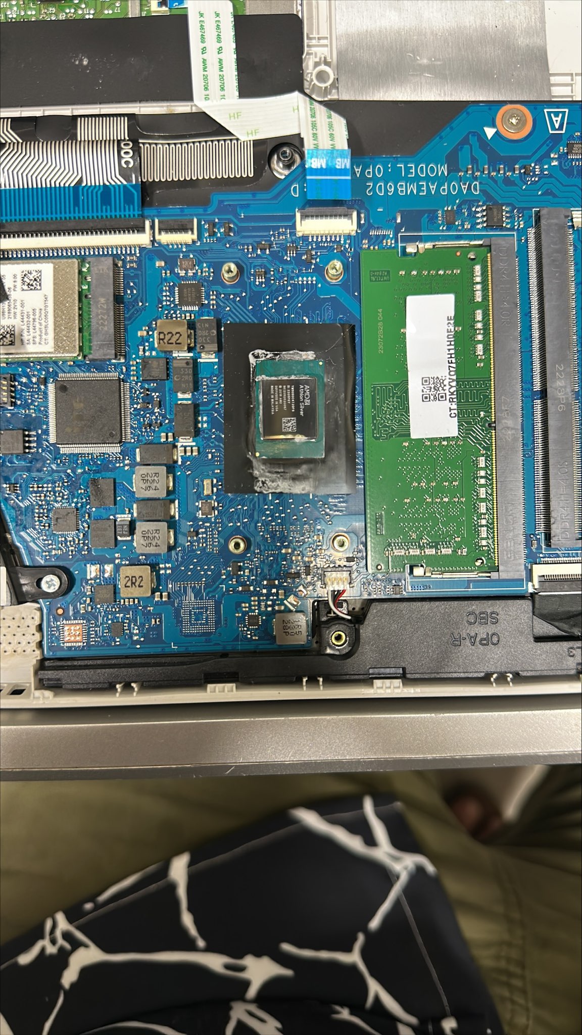

    hp 14-fq0028ca nee bios
    hi need bios for
    hp 14-fq0028ca
    DA0PAEMB6D2 REV
    MODEL:0PAE
    CPU: AMD AthlonSilver

      Hi all, I am working on this Hp 14-fq0028ca (motherboard # DA0PAM16A1 Rev: A) is it possible to inform me the Serial # & Windows Keys OFFSETs of this Hp BIOS.. found the BID 087B7 & the Serial # 5CD132989L, but Window Keys I must have missed. Can someone please inform me the OFFSETs of both or anyone update this inform for me in the Virgin BIOS 087B7. I have uploaded the Original BIOS & the Virgin BIOS. Thanks in advance.
