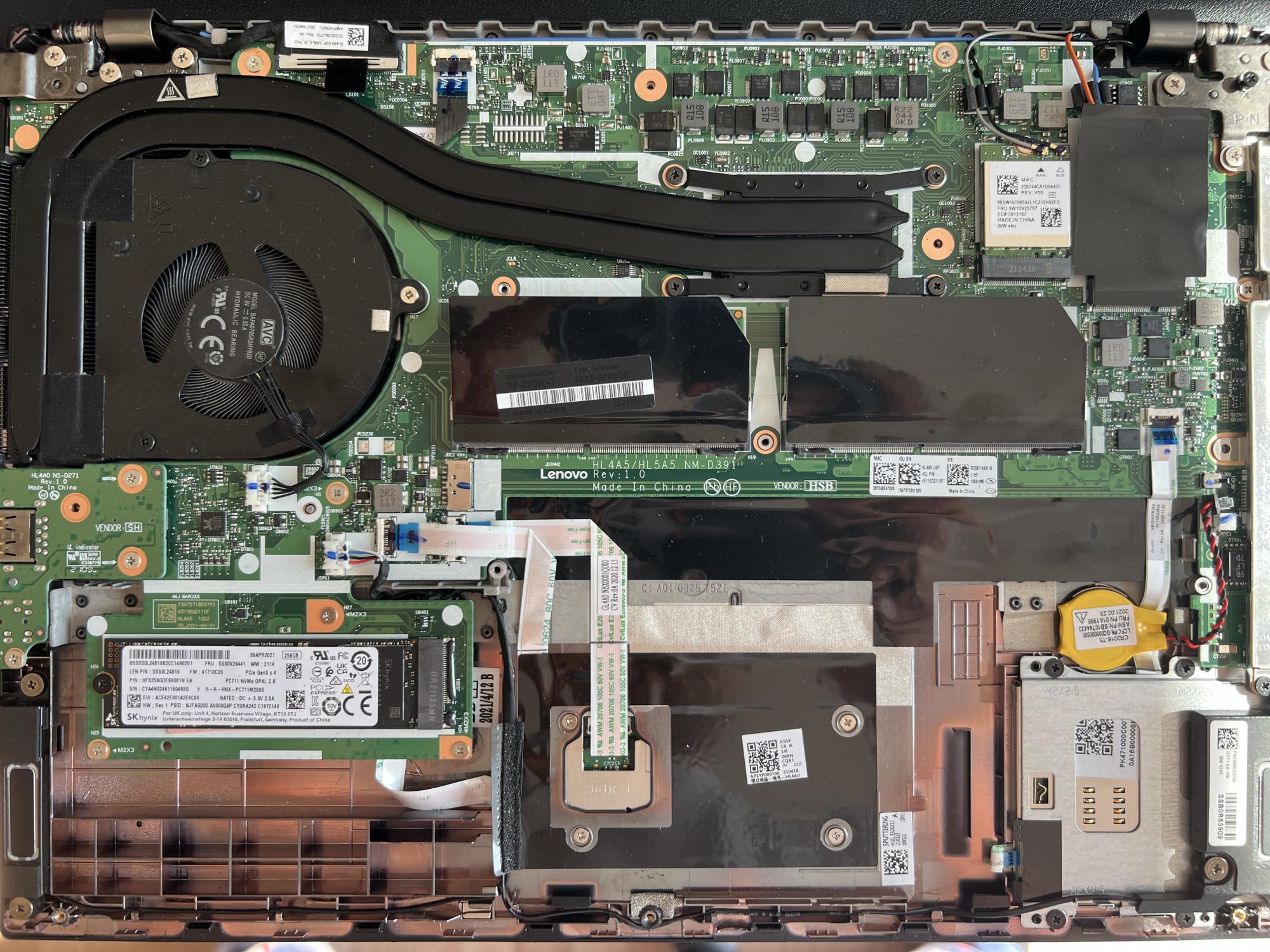

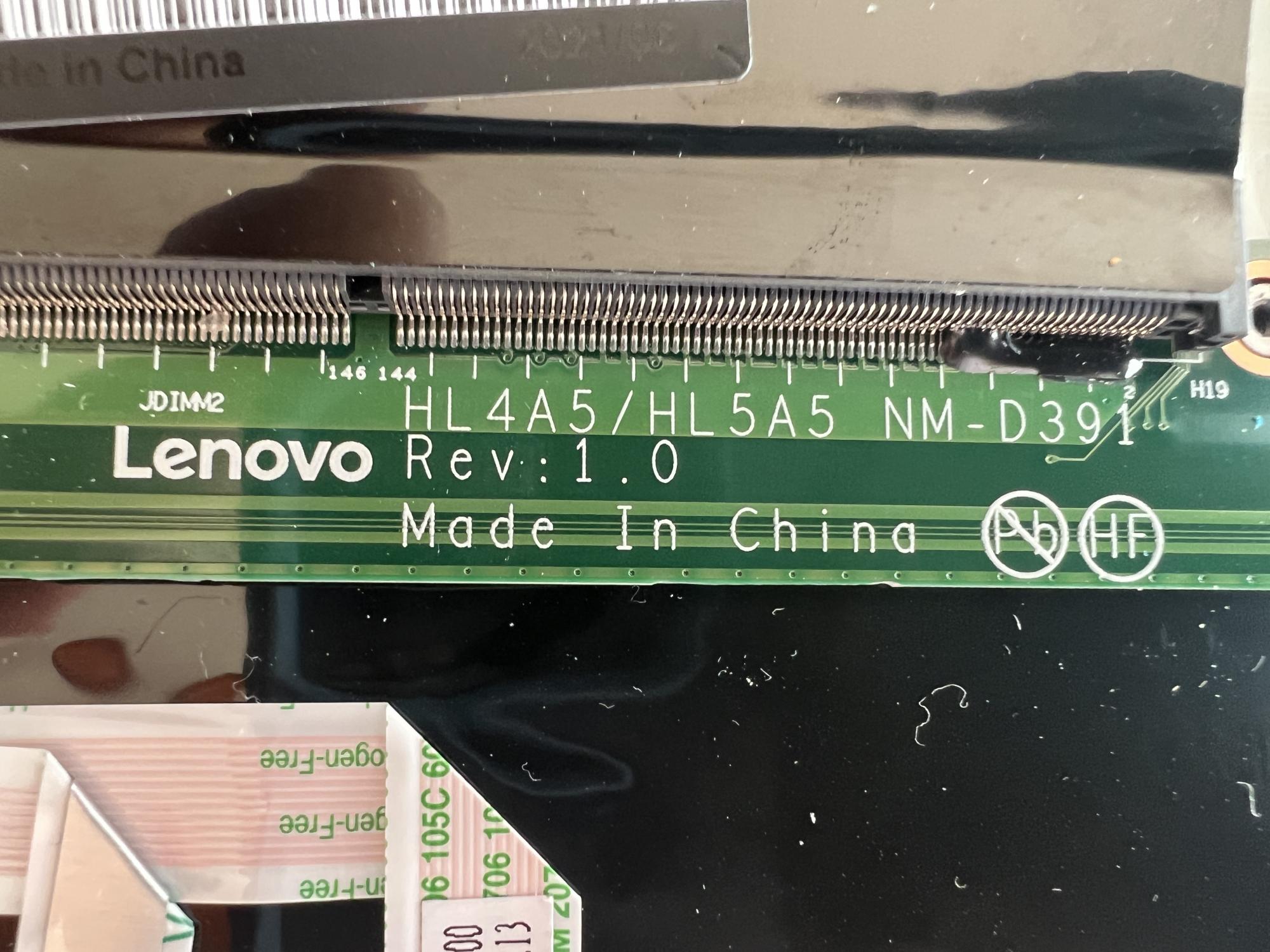

    Hi everyone, I have a Lenovo Thinkpad L14 Gen 2 AMD (20X5) with supposedly bricked BIOS, when powered on, I only get short keyboard lights and fan spin, nothing on the screen, no beeps. I have couple of questions, that I hope someone will have the answers to.
    1. What is the correct chip that needs to be flashed?
    I've was able to read the chip near the right hindge (on the motherboard picture) with the CH341A, but I'am not sure If this is the BIOS chip.
    2. Does anyone have a working BIOS file for this model?
    3. Is it possible to flash the BIOS chip with CH341A or I need some other programmer?
    I've did some research and read that for later models of Thinkpads you need JTAG programmer to flash the BIOS chip.
    4. I found this ad on ebay https://www.*****.com/itm/***, will replacing the chip fix the BIOS issue?
    Thanks in advance.

    bios chip is in the canter i marked over there
    mabe you need to desolder that chip or program with the help of pogo pin connector check the link below
    https://www.youtube.com/watch?v=e_dGDrWxipQ

      I tried soldering tiny wires on the "Winbond" chip, and when trying to read or erase with flashrom I am getting "This flash part has status NOT WORKING for operations: PROBE READ ERASE WRITE ... Read is not working on this chip. Aborting. Your chip is in unknown state.".
      If I try to write the chip I get ERROR: Image size (33554432 B) doesn't mach the flash chip's size (0 B)!
      The CH341A has the voltage fix btw.

        Update: I was able to read the cheap with AsProgrammer v2.1, erase it and flash it with some random .bin file from L15 Gen1 AMD but without success, still same issue.

            As this is second repair attempt, the original BIOS file is long gone.
            But the repair was succssesful, you need to use the 1.8V - Adapter and have the voltage mod on the CH341a. And as peviously mentoned the AsProgrammer v2.1. Once I've uploaded the attached bin, I got sound and picture, but I wasn't able to update the BIOS via USB, had to install windows for that. Now the laptop is working as it should.
